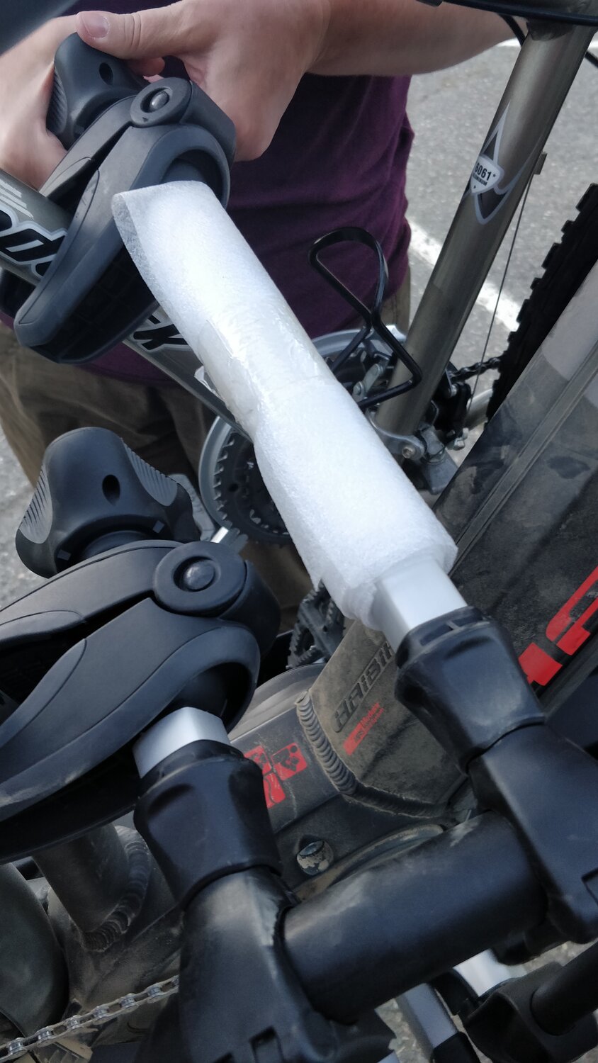

Just use the swing arms on the rack to hold the bikes in place. Don't use it often and have yet to use it in a situation where the bikes would be left on the rack unattended. Guess I'd try our folding locks.
On the Thule Easy Fold we have there is an arm with a clamp that you tighten down until it ratchets. It has a lock on it so the knob just spins without loosening. I’m not sure it would stop a determined thief but it would help.
How do you lock down the bikes and is there a change in weight limit if you put it on an RV?
Ratchet strap on the wheels and there are 2 adjustable clamps that clamp to the top tube or seat tube to keep the bikes separate and in place. The arms can slide to any spot on their mounting tube as well as pivot and the clamps rotate so you can accommodate almost any configuration of bikes.
