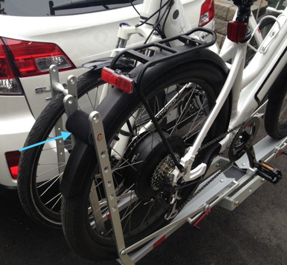

For those who are curious about the 1Up USA Super Duty Rack which holds each bike weighing up to 75lb, and are nervous about the force of the arm and how to protect the fender, I found a cool picture showing that exact setup. Notice there are TWO Stromer bikes loaded AND one fender protector is shown in this picture. The blue arrow shows the foam fender protector that was added to the bar that touches the fender.

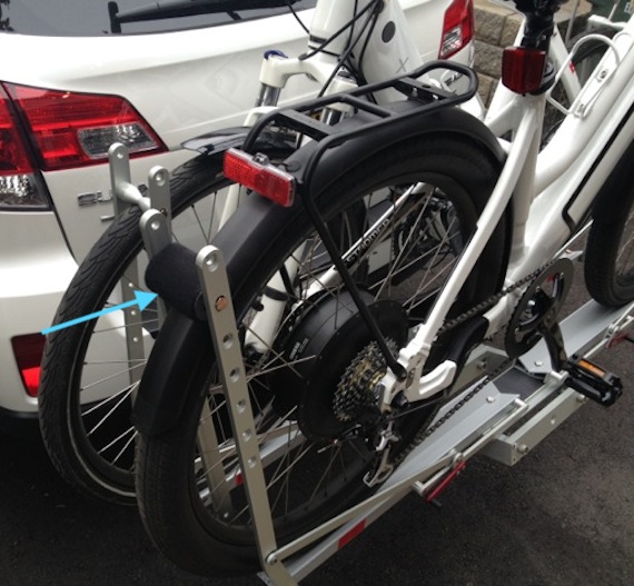

Yes but what goes between the fender and the tire to prevent the fender from being damaged and also make the connection more positive? Better to have a rack that secures on the frame if your bike has fenders.

I found there is a lot of discussion on non-eBike forums about using the 1Up rack with bikes that have fenders. In addition to the foam fender protector, another suggestion frequently mentioned is to stuff a scrap of high-density compressable packing foam between the tire and fender in the area where the rear arm presses downs on the fender. This transfers some of the pressure on the fender down into the tire and wheel.
Also I found this blog post suggesting an alternative position of the rear arm lower down on the tire, rather than on the fender itself:
http://heilbron.com/1up-usa-rack-and-bikes-with-fenders/
That alternating rear arm position may work but it seems like the rear of the bike could possibly pop up and out. I'd probably also further secure the bike with a ratchet strap between the rear bike rack and the bottom track.
