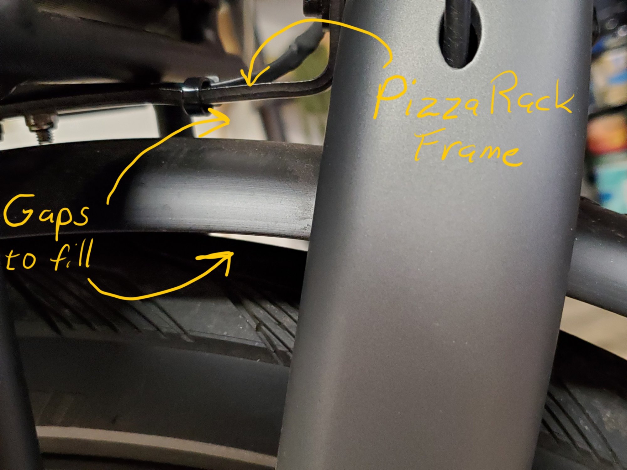

@flashracer I tried the Como on the Kuat Base rack and it would work but would need extra steps for me to be confident. I have the "pizza rack" on my Como so that adds even more "work".
You could probably mount the bike backwards i.e. with the rear wheel in the cradle vs. on the "platform" and I doubt you would have to worry about it especially if you were to add another strap to the front wheel to keep it more stable since it would no longer be in the "trough".
With the "pizza rack" I would be worried because the rack's clamp is about the same size as the gap between the bike frame and the "pizza rack" plus you would need to add foam or something between the fender and tire to shim the gap and also add foam to fill the gap between the fender and the "pizza rack" frame where it attaches to the bike.
Mounting the bike backwards would still require some type of shim between the tire and fender.
So on the Kuat , the arm sits on top of the plastic fender. I thought it would sit in front of fender. That’s why you shim it.
According to Kuat, you don't need to crank the hook down, so putting it on top of the fender will work fine as long as the fender is reasonably well attached.
I've used these types of racks and put the hook on the tire in front of the fender and it's worked fine as well, although I've added a short strap around the front wheel and tray to make certain it didn't roll, twist or lift. Then the arm just holds the bike upright, as long as it's not so far forward it can pivot over and off the wheel.
