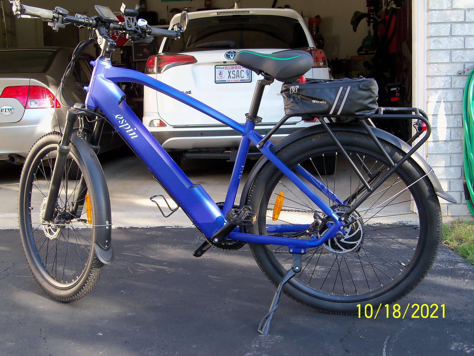

I've only had one ride so far that took me through some muddy, clay like puddles and when i got home my bike....as well as my back looked like hell!! Without being able to just hose the bike down it took me about 1/2 hour to clean all the shi.........stuff off my bike. Meanwhile, my son was riding my Espin 21 Sport that has fenders and his bike was nearly emaculate. Needless to say I am considering fenders at this point.
Good point. I ordered fenders from Amazon, the ones that R1U had recommended for the 500 Step Thru but I could never get them to fit or attach so I returned them. Let me know if you find some that work and are installable...
I think I remember hearing that even the stock R1U fenders were very finicky to adjust and that was one reason I didn't buy them with the bike. My Espin has plastic fenders and I must say that they are great!
