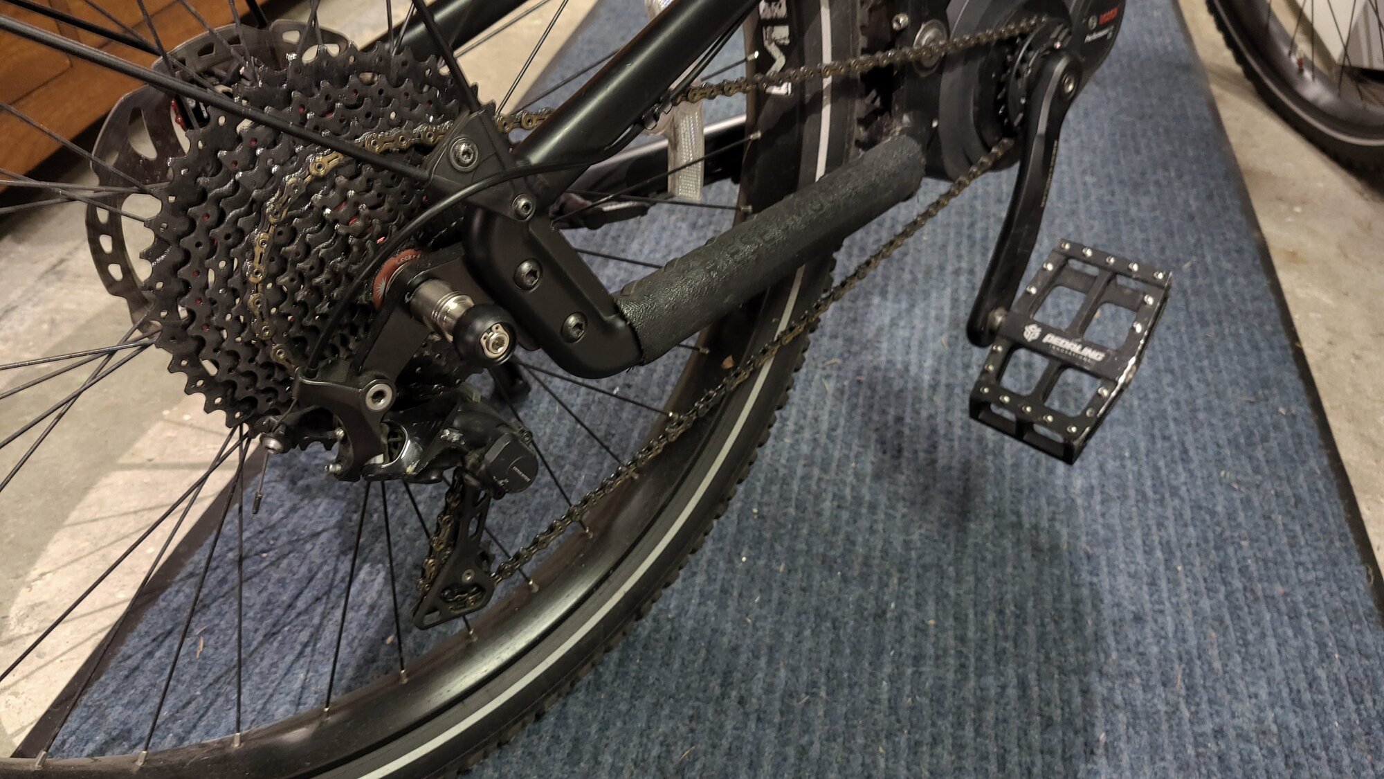

For future reference, you can buy individual replacement cogs for the 11 speed Shimano cassette and many other cassette. The cogs that wear out the quickest are the smallest ones, the high speed first two cogs, 11 tooth and 13 tooth. They have the fewest cogs engaged on the chain which are therefor exposed to the most wear. A pair of 11 & 13 tooth cogs can be purchased for about $20 on Ebay. I was able to do this twice, tripling the life of my cassette. Note the long dropout along with the long cage. This is on a 2018 Riese & Muller Delite Mountain.
https://www.ebay.com/sch/i.html?_fr...esc=0&_osacat=0&_odkw=shimano+xt+11+tooth+cog
I also changed over to the Sunrace 11-46 cassette as it has more evenly distributed gear steps and seems to shift more quickly and precisely.
https://ebay.us/zbCNro

How many links longer if any is your chain with a 46 t in place of the 42t that I assume your bike came with?
Four, one link for each extra tooth on the 46t. I had to start buying 132 link chains and trimming them down. I am running 126 links plus the quick link.
Thank you that is helpful (-: and that will work out perfectly since the chains I normally use (sram xx1) have exactly 4 extra links when used on the 42T.

Please tell us about those pedals
Catalyst Pedals are a real game changer. I have them on both of my bikes and love them. Their increased length makes pedaling so much more efficient and strong. Because of the length you place your foot so that both your heel and the ball of the foot on on the pedal. Having your heel on the pedal more fully engages your hamstrings and glutes making for a stronger stroke. I ride mine with Salomon Gore Tex Trail Runner shoes, no need for stiff cycling shoes.
https://pedalinginnovations.com/
