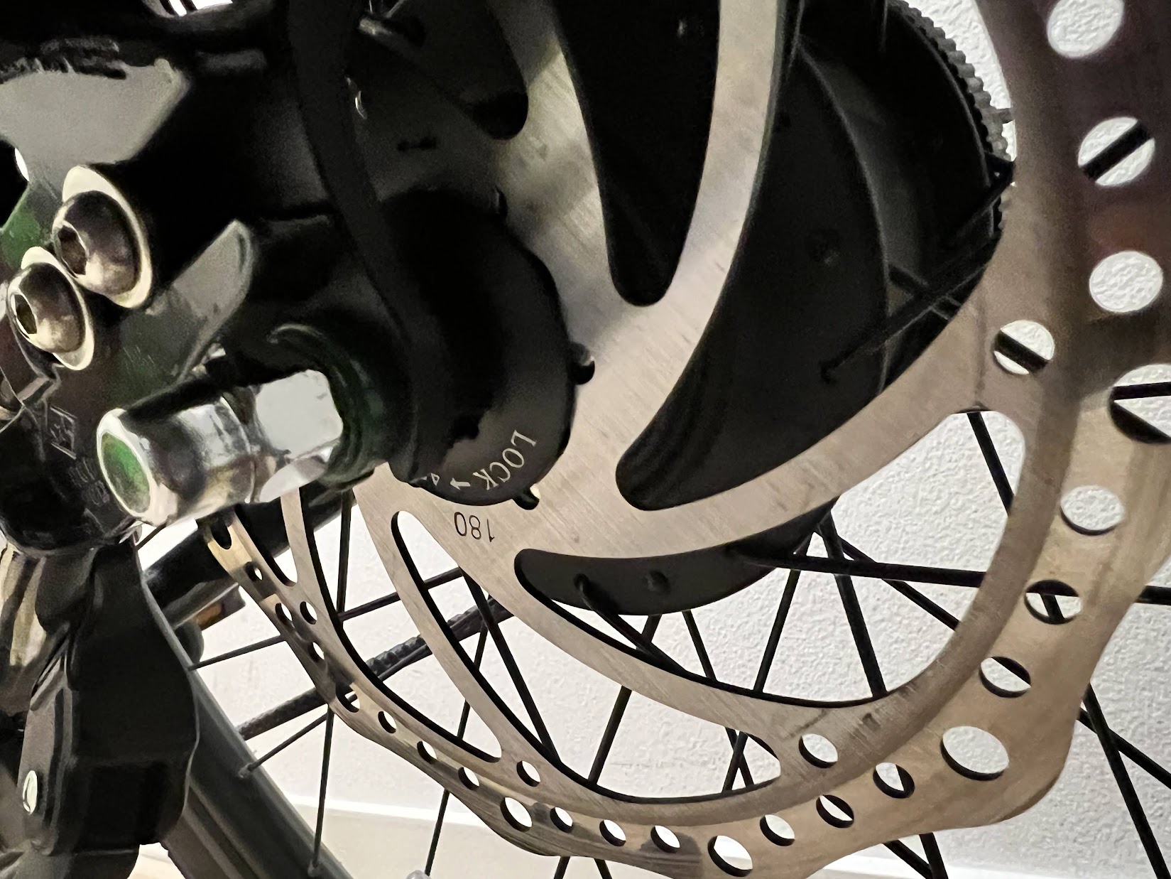

Rear brake disk rotates free, what kind of setup is it? Lockring? Screws?

Its been a couple of months since I got the new wheel. Works good now. Same design though. I am using my rear brake less and less though. Decided to get it fixed at the bike shop,. but did the final mounting on the bike myself. Getting the dots to line up at 3 was a bit tricky, but it worked out in the end.
Closing in on almost 1000 miles now.
Reagrding m@Rob's note in post 4: I see "180" in the photo from OP. So if there is a limit of 160, Priority has been misusing adapters.
That was a limitation on the linked DT Swiss adapters, not anything that came from Priority. However, given the situation I would say your conclusion is correct nonetheless. I sure wouldn't trust them on ANYTHING after seeing something like this.
Okay, so I should definitely avoid hard braking on the rear wheel.
The bike runs nice though, and hopefully it will last beyond warranty period. Looks like some parts are not carefully thought out?
I have seen some similar stuff on big box bikes and internet only bikes where the brake only grabs 1/2 of the pad surface the last few years. I wonder the extent it is due to the supply chain issues. It is a level of negligence. Can you swap the adaptor?
Thats a good plan until the first time it isn't. This is not the sort of thing you can compromise on. Your brakes have to work.

The rear brakes work now. I am just wondering what part should I swap so i can keep using the 180mm rotor? Or should I switch to 160mm rotor?
