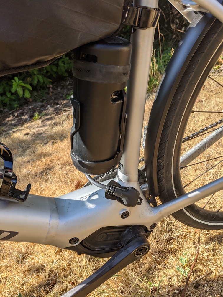

This is the range extender Vado SL with 220 cable:
That's similar to how my cable runs/attaches on the Creo. I admit that I looked at a number of reviews and videos to see how they arranged the battery and cable. Cable comes out of the battery near the top on the opposite side snakes down through the cage and connects to the non-chain side.

It's the 220 mm (Road) cable.
@Allan47.7339 has shown the correct orientation of the Range Extender. Notice a notch on the battery: It needs to be oriented towards the bike rear, so the Zee Cage can secure the battery in place. For that reason, the RE cable plug needs to face the chainring and that's the reason the longer cable is used. It is certainly different for Levo SL, where the shorter cable is to be used.
