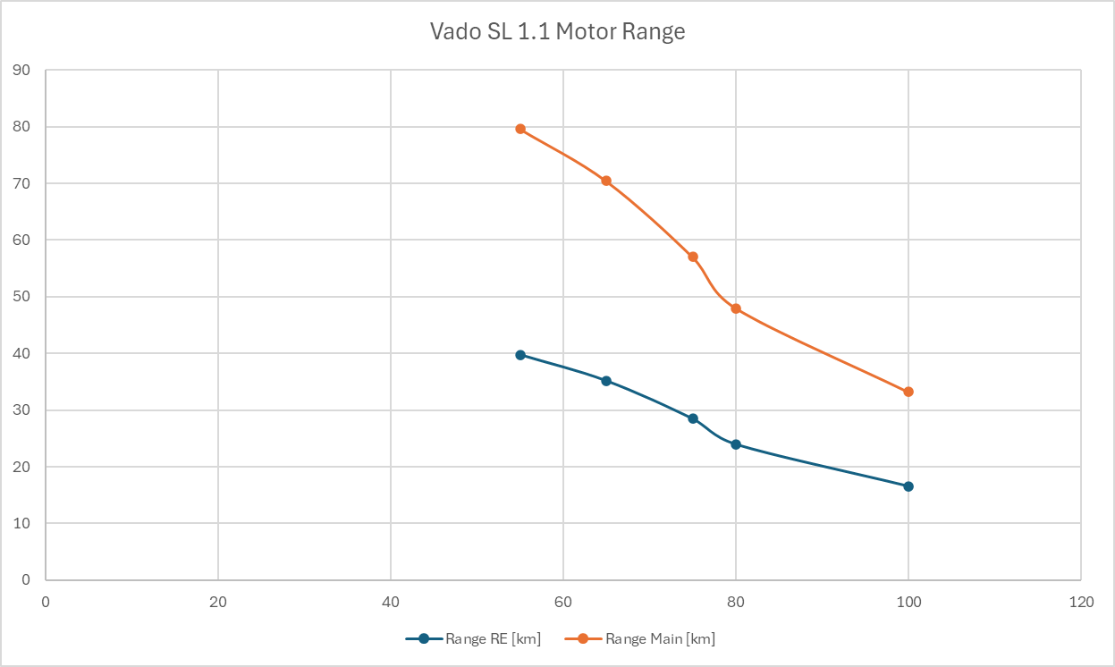

An update related to SL 1.1 (Vado SL) range at Turbo: 16.6 km on the RE, 32.2 km (around 20 mi) on the Main Battery. Necessary to mention the e-bike was derestricted there; there is a little sense to ride in SL Turbo on the flat with the European speed restriction.
Now, it will be necessary to get the point for the 90/90% assistance as well as to determine the range at low assistance modes.
