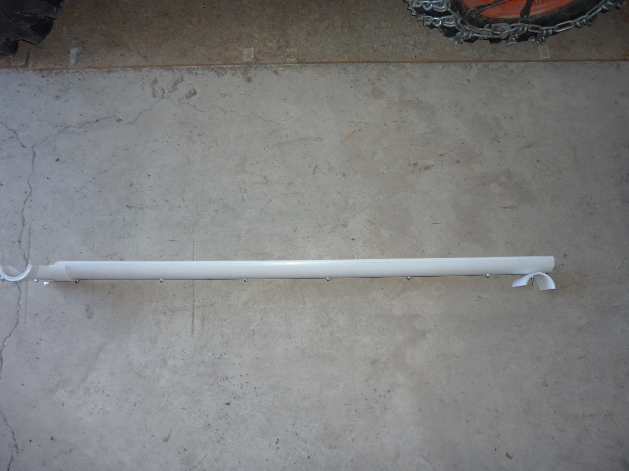

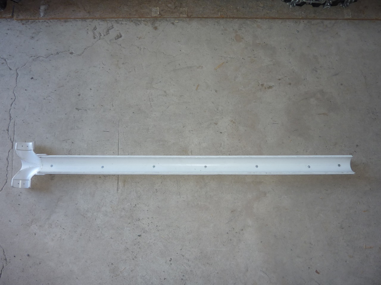

I built something similar to roll my bikes up into my pickup. I bought a 10' piece of 3" PVC pipe, cut it in half lenghtwise and then bolted the two halves together to form a channel.
View attachment 97376 View attachment 97377
I made one for my neighbor without the end pieces last year to help him get his bikes in and out of his basement. We screwed it to the stair riser away from the wall so the handlebars would clear. It really helps to have walk assist on the e-bikes.

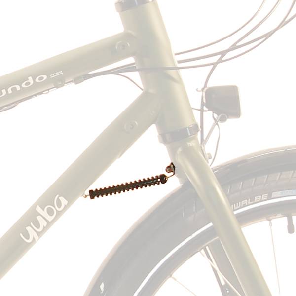

x2 on the deflopilator. I have one on my Mongoose and its such a small thing but is soooo useful in so many unexpected ways. You can buy a version with a connector on the down tube that is a clamp so you can use it on frames not drilled for one... which is pretty much all frames.

I think only Yuba calls it a deflopilator. You can google that word and get the Yuba page but its only good for a drilled frame. Here is one of the (many) clones on Amazon. This one is from Velo Orange which is a pretty reliable old school-ish vendor.
hmmm. this one seems to have better ratings
I've been using devices like this for years on my conventional bikes. They work well as a steering damper but do not hold the steering rigid. For general use, this is fine but I found they aren't that effective for keeping the bike tires rolling straight on a ramp.
It's a matter of personal preference though, so try one and see how it works. They certainly are cheaper than the Steerstopper!
My primary use for them is to keep the front wheel from ... flopping over ... when the bike is stopped and I am doing a variety of little things on or next to the bike. Or if I am pushing the bike forward while standing next to it and holding the saddle. The deflopilator keeps the wheel straight and the bike rolling straight. All little stuff and none of it has anything to do with actually riding the bike.
