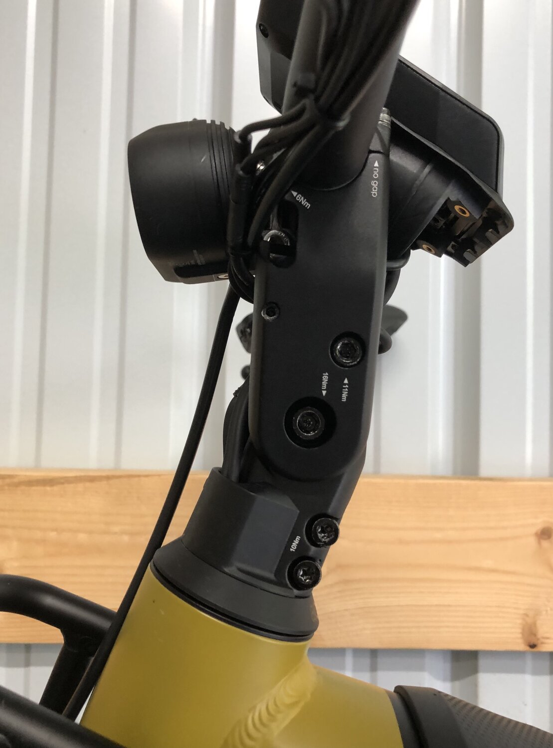

I was finally able to make an adjustment to add some height to my handlebars using the instructions attached.
This was my second attempt using these instructions. I loosened bolts A, B, C, D. At my first attempt I neglected to loosen bolts C and D because they appeared to me to be merely handlebar clamping bolts .
This time I loosened the handlebar clamping bolts C and D. There is a small T10 bolt in front of the head tube that I also loosened. I don't know the function of it but I thought it would release the cables
that are going through the head tube and give them some slack. After that, I used the advice of JVBulman and used some force to free up everything. There is a small plastic plug near the top of the pivoting joint
(for lack of a better term) that has to be removed. That came out during my jerking/twisting. After it came out I looked inside and saw what appeared to be a stem bolt.

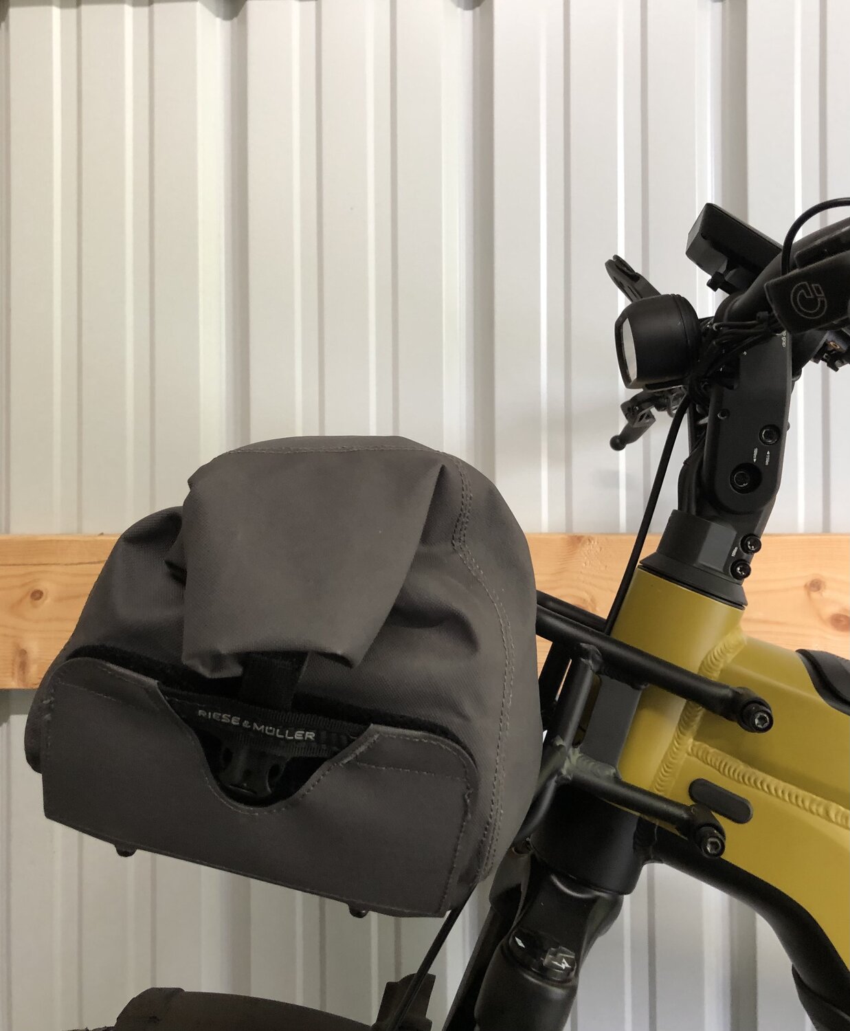

Finally, my adjustment resulted in the angle of the cockpit stem being vertical, which gave me about 50mm more height.
Also my bike has the Riese & Muller front rack with bag. Now the headlamp has a little more clearance above the bag.
