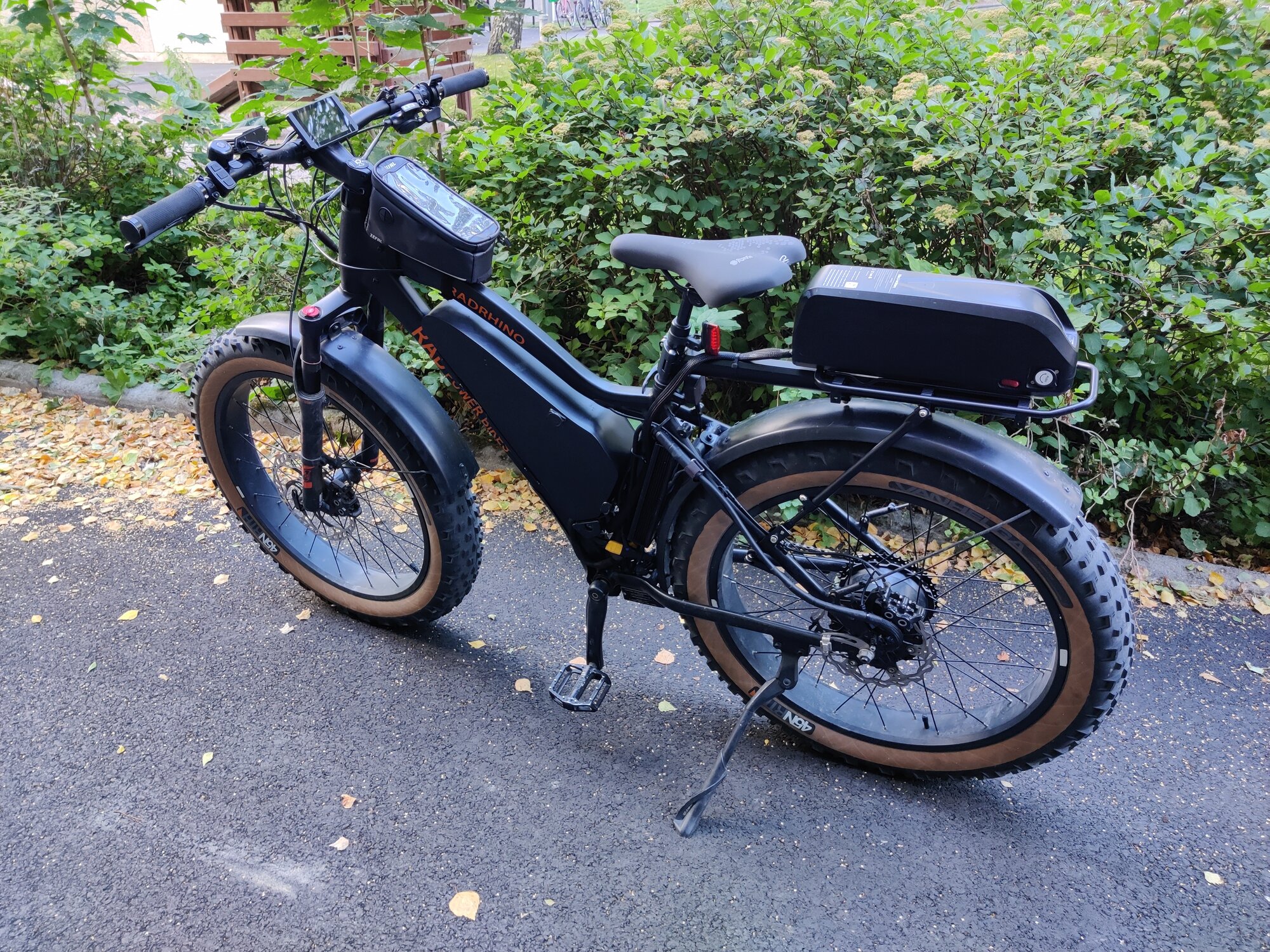

RadRover long range configuration 60v 41.5Ah
JTK77

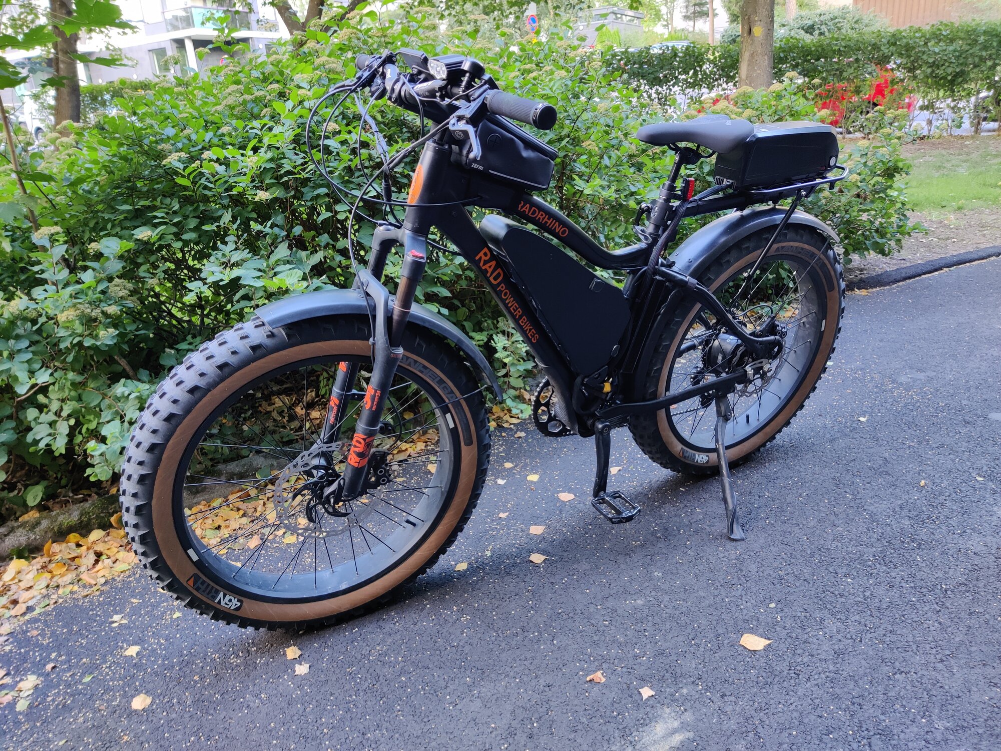

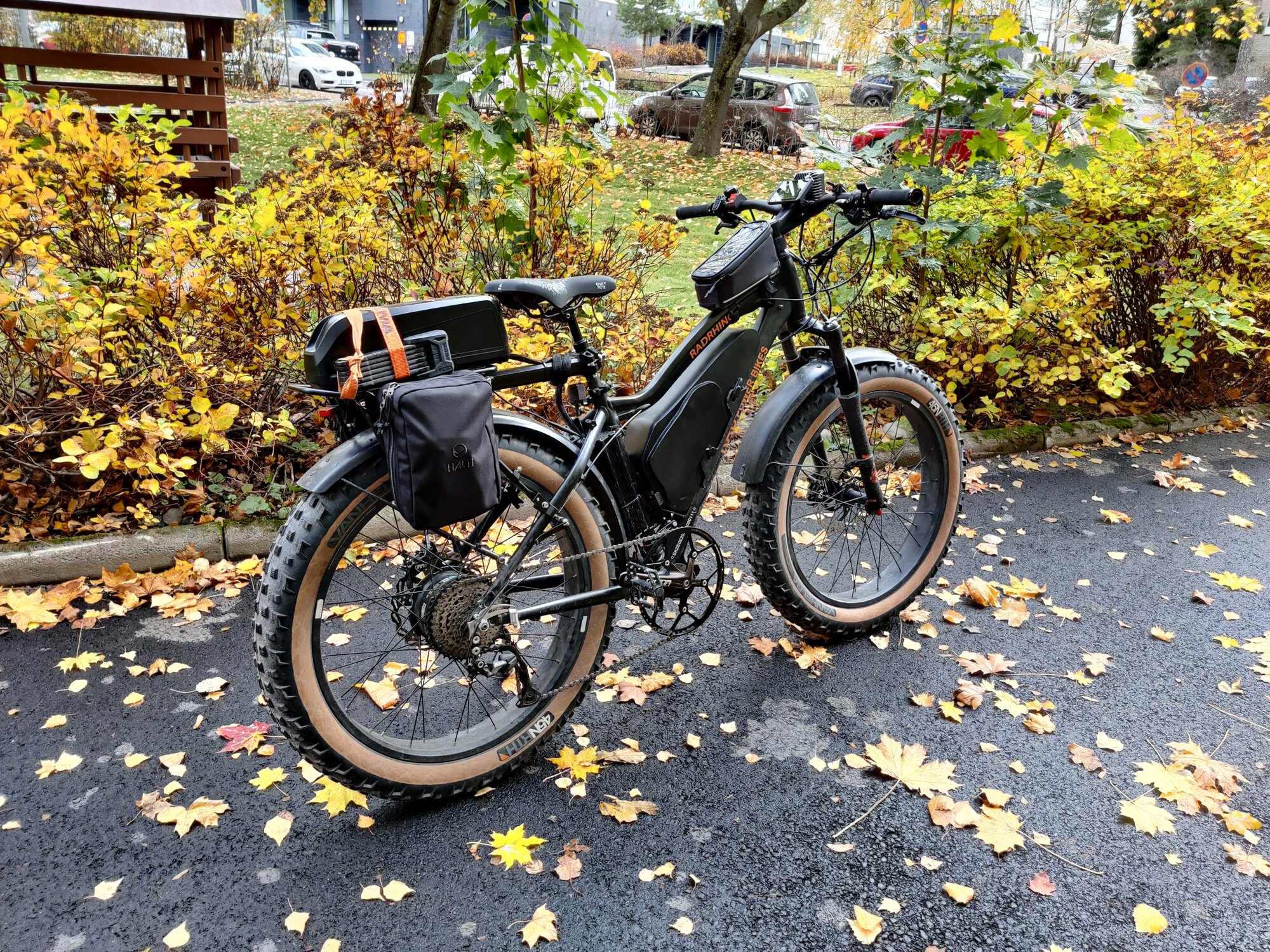

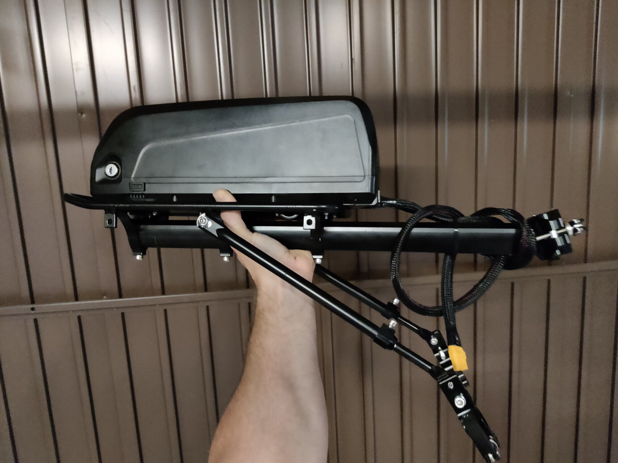

Just added this quick release 60v 17.5Ah range extender to go with the 60v 24Ah main battery.
Rarely need the weight of full 60v 41.5Ah capacity on my Rad but when needed its mounted fast.
Alltogether straight 24 hours of PAS in 100w setting...so very long range 👌

These batteries are used fully separately for long range only so not parallel or series. Rack is installed in about 2 minutes.

Upgrade list
- Controller 60v 64A (custom).
- 60v 24Ah lockable downtube battery, 120A BMS (custom) + fast mount rack G80 60V 17.5Ah = 60V 41.5Ah
- Vented high KV G062.1000.DC motor with real time BT temp logging system, higher gauge wiring and reglued magnets
- Magura MT5E brakes, Galfer f223/r203 rotors
- Shimano 8 speed trigger with 11-42t cassette.
- Derailleur hanger extender (modded)
- 52t Deckas chainring
- XLC CR-A19 chainguide (modded)
- stainless steel double torque arms (modded)
- STD zero Pro pedals
- 780mm Pro Devil 30mm riser bar
- Wuxing 130X thump throttle
- full mountaingrips
- 3*T6 "30w" headlight
- 120mm Air fork (Pasak) with rebound adj and remote lockout.
- Red smooth II suspension seat post
- Selle Royal freeway fit M seat
- custom kydex "carbon" skid plate
- Peak 4kw power.
- Over 40mph.
- 0-30mph ~3.9sec
+ Some other mods & parts

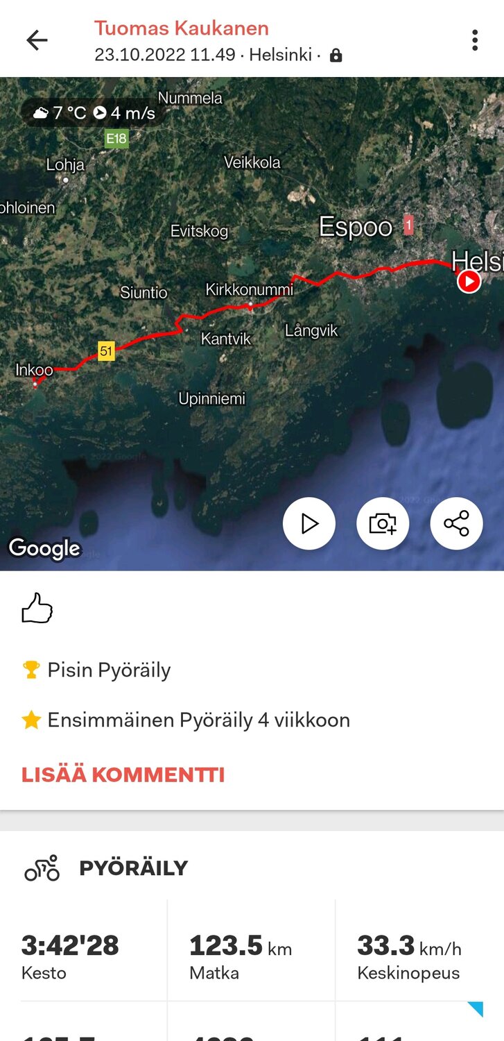

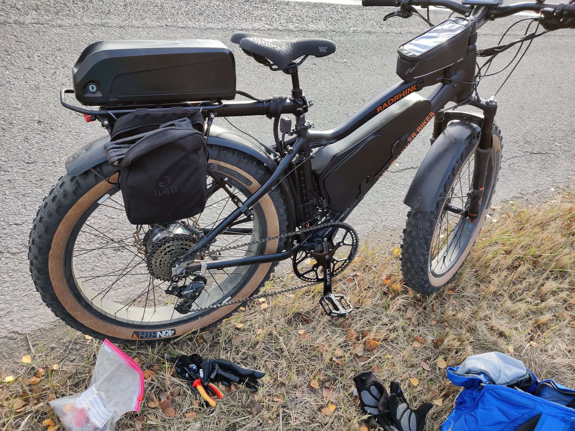

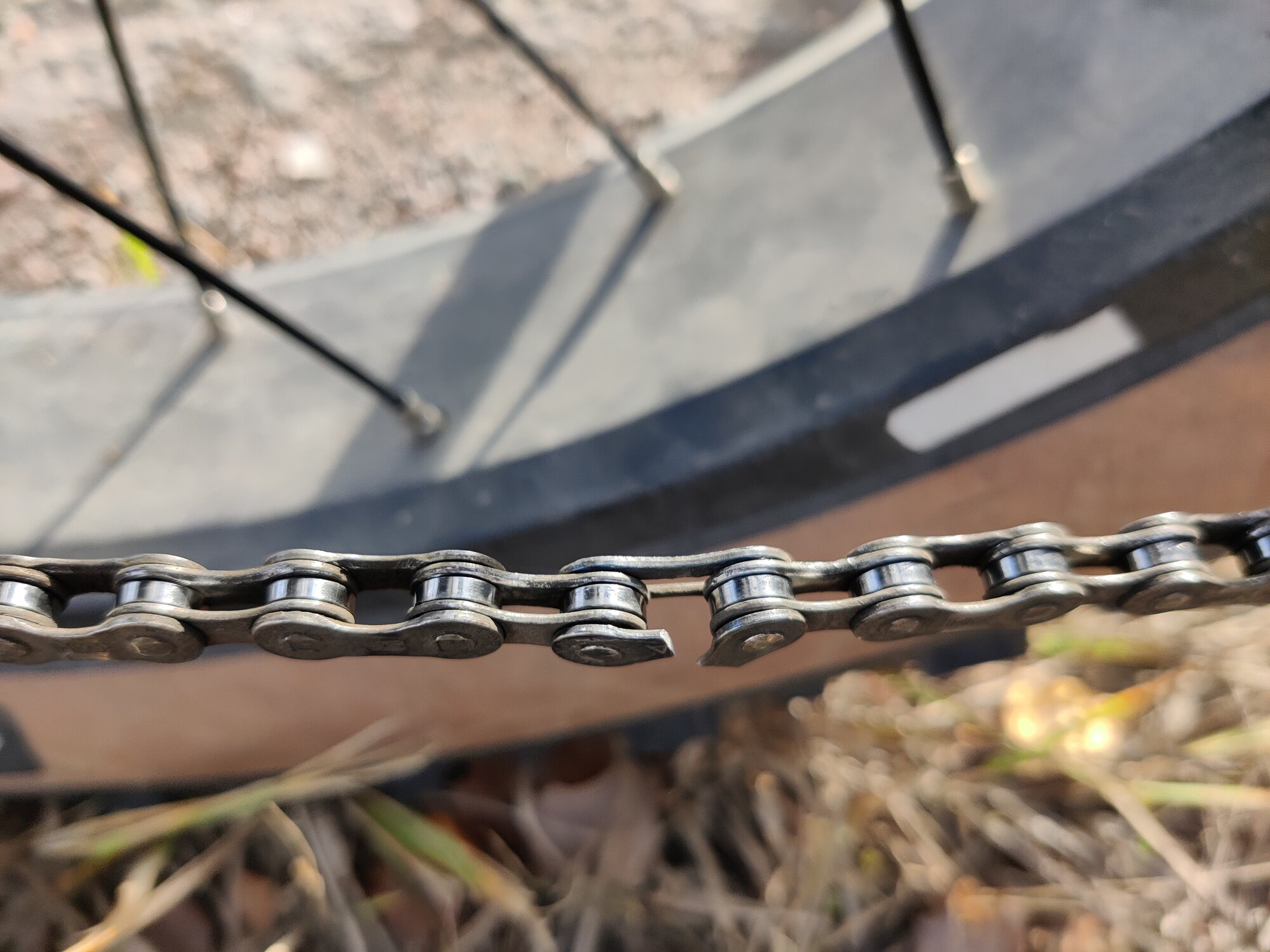

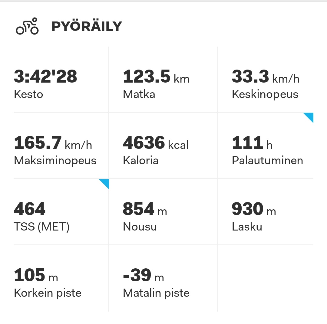

Did a little road trip last sunday with this setup.
Did some road side repairs, had some pizza and did some coffee stops. Used about 2.1kwh on my 77 Mile trip so 27.3wh/mile. Had average speed of 20.7mph. Mostly when I had open road ahead kept the speed between 23-28 mph. Total battery capacity is 2400wh so at this pace total range would be 88 miles. Dropping the open road speed from ~25 to 20mph would more than double the range to ~200miles.
