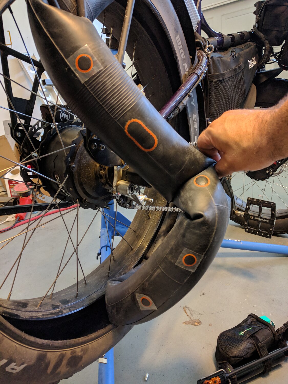

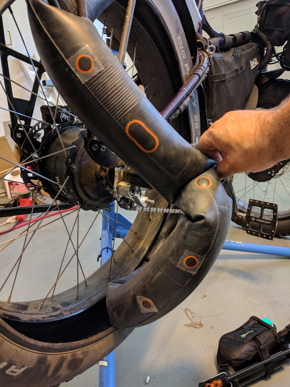

Lastly... learn to fix your own flats. If you do the above, your sealant will actually render this step almost always unnecessary. But back when I only used Slime, I let it slow the leak to a trickle of air, where I only needed to pump the tire back up every week or so, and then I would pick a weekend morning and go in and patch all the slime-mostly-sealed-it holes. Rema Tip Top kits have been the gold standard for decades for a reason: The tube is if anything stronger than it was before the patch. The tube pictured below went to 7 patches before #8 gave it a cut on a seam that could not be repaired. At $20 a pop for a decent 26x5" tube, imagine the cost differential at one tube per hole versus about 10 cents.
