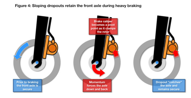

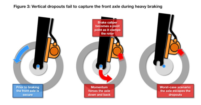

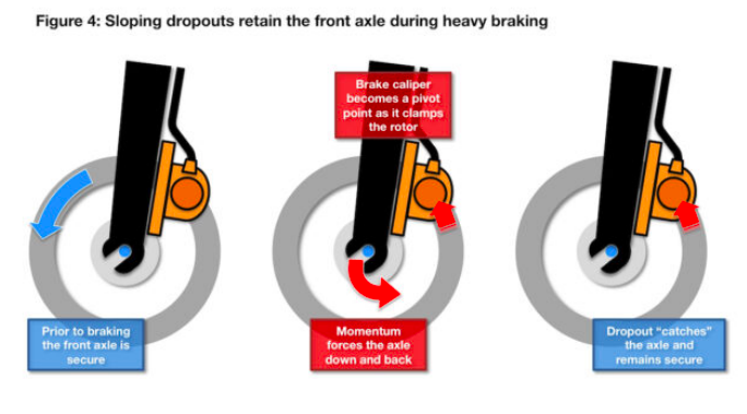

QR on a fork with a disk brake is USUALLY prevented from being an issue at high speed with putting the fork dropouts angled forward. I'd bet money the Chinese didn't bother with that and used old-school vertical dropouts. Which is fine so long as you keep enough tension on the QR bolt. But you can't control whether that happens when consumers who don't pay attention to basic maintenance are factored in.

from that linked article above this neatly encapsulates the problem and the solution, which I am certain Rad and their Chinese manufacturers ignored as most others do.

Those look like standard-issue vertical dropouts. As such, vulnerable as the lawsuit describes. Rad is not alone in this. Their Chinese parts suppliers are pretty much universal in ignoring the problem across the industry.

Maybe I am seeing it wrong but looks like a sloping dropout to me?
We'd have to see it with the wheel off but it looks like a 'vertical' dropout to me, which can be slightly sloped forward vs. the very pronounced slope that lawyer-proofs a bike against this not-really-common issue. I just checked the Rad Rover fork replacement video and its definitely a garden variety vertical. I personally don't think its much to worry about but on the other hand its clearly an issue that exists so probably should be addressed at the manufacturing level.
