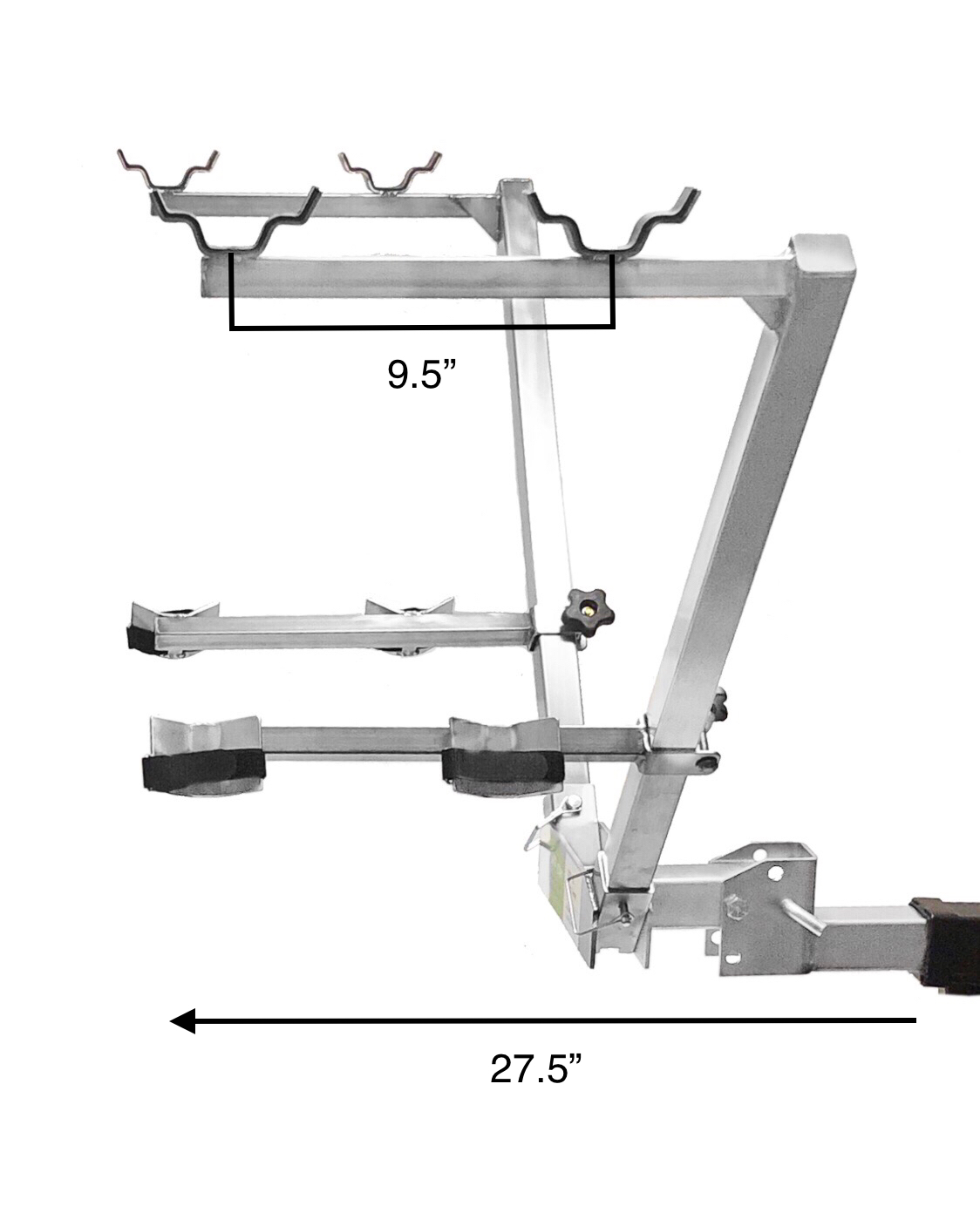

Our Double eBike/Bike Carrier can be safely used with a 1-1/4” receiver. We will build you one at no extra charge—just note it on your order or contact us. It has a built-in stabilizer, a 200 lb load limit, and weighs 27 lbs. We manufacture them in rust-free stainless steel here in the US. It extends 27.5” from the face of the hitch and will not wobble. We can make other customizations if needed also no charge. It’s built to last. https://MotowUS.com Here’s a YouTube video showing it with 2 eBikes weighing 115 lbs. on I-95. This one has a 2” hitch and the 1-1/4” will be the same.

Here's a picture of a MoTow Double eBike carrier with a 1-1/4" hitch. It has a 200 lb. load limit and fits 2 fat tire step through bikes like Rad Power. It is made of rust free stainless steel in Massachusetts, USA, $459 with free shipping US & Canada. See a video of it on a highway here:
