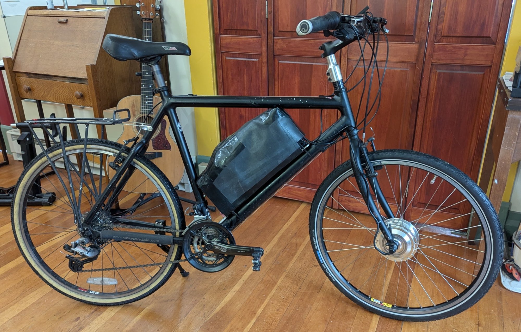

Still, I would like to check out a state of the art ebike. Otherwise, I have this throttle only baby:
What kind of throttle does it have? I don't like lever throttles or either kind of PAS. A half twist throttle allows precise control by letting me hold the throttle and the fixed grip at the same time. When the steepness of a grade or the speed of a headwind would force me to shift down and go at a crawl, I can instead supplement my pedaling with just enough motor power to maintain speed.
A right hand half-twist throttle. I'd install a cadence PAS sensor, but what I have won't fit on the crank. Being that the bike is a Cannondale Badboy it is super nimble, and functions surprisingly well with its 350w geared front hub motor. It probably gets 750w full throttle.
