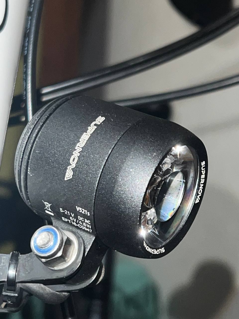

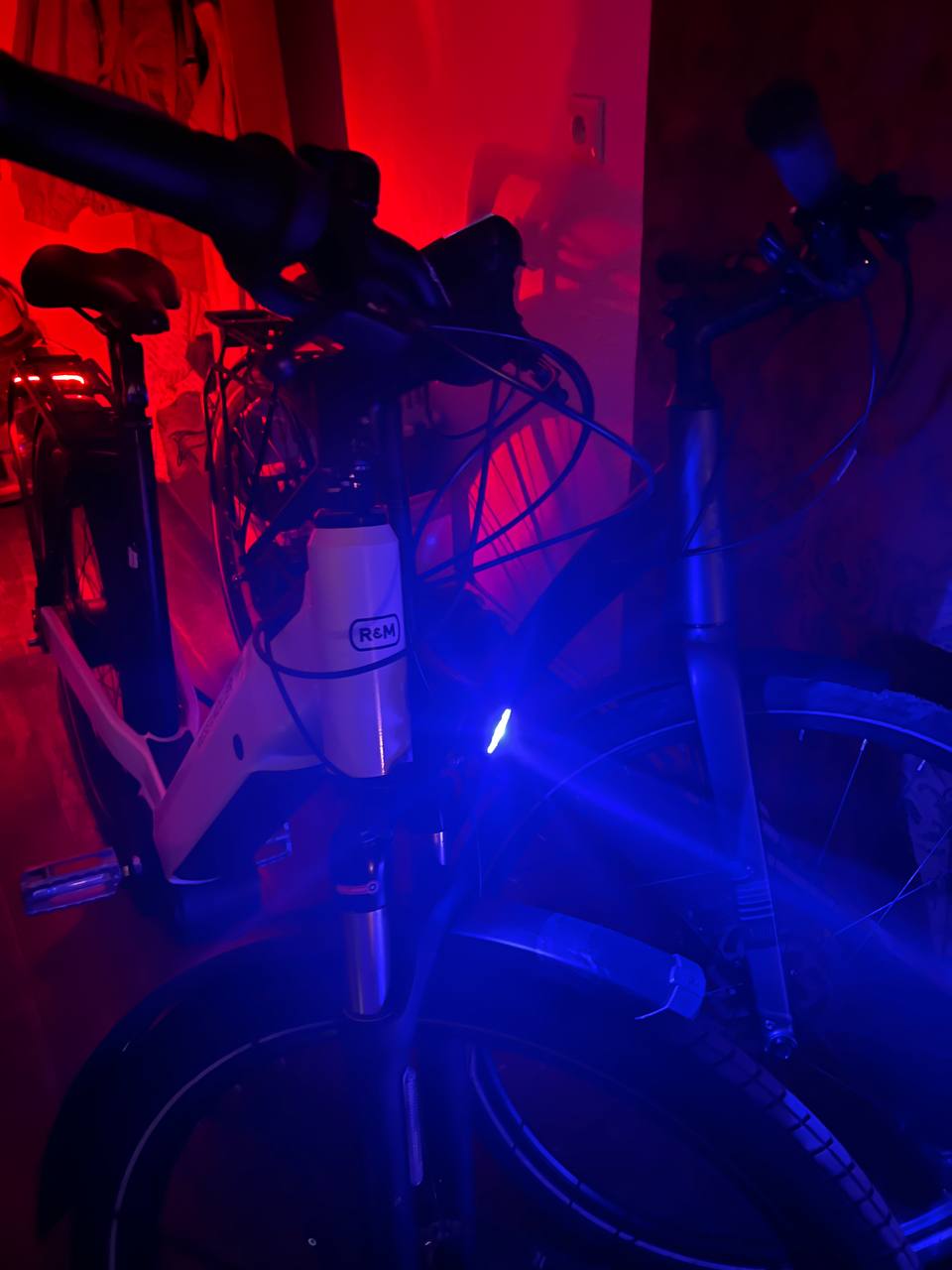

The headlight started to glow blue, maybe someone has experienced this and has a solution?
This happened after I changed the language on my Bosch Intuvia from German to English. Is there any way to solve this programmatically?
SUPERNOVA V521s headlight, my Riese & Muller Nevo bike

That is strange tho was your lights advertised with blue lights options?

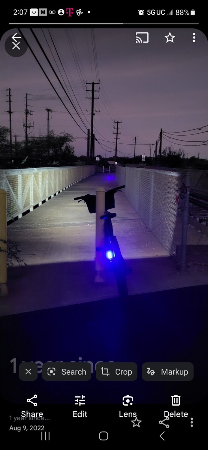

My blunt advice, Delete blue lights by going to your ebike dealer and have them replace it to white light.
