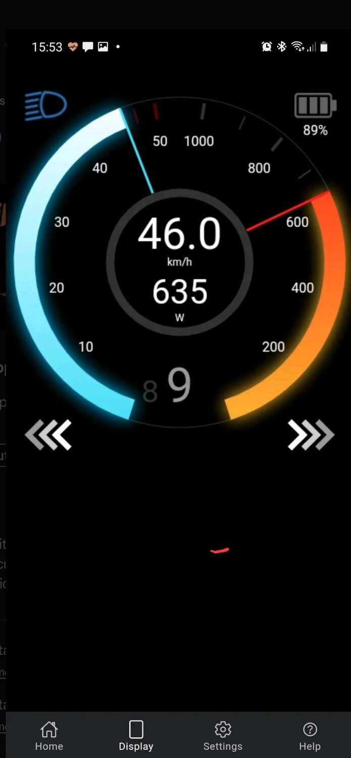

If you have a BBS Motor you can use an Android phone as a display for testing.
You will need the..
Speeed App
Same USB Programming cable used with laptop
USB Adapter for your phone to connect to USB cable.
They have them for Micro USB as well if needed

finally I found time to test, the app is very useful to programming the motor but not diagnostic, I still to have even the same problem so the motor works only with the throttle and not using pedals.

The diagnostic reasoning for trying the app was to see if your display is defective. Since the app gives you the same results then your display is probably ok.
