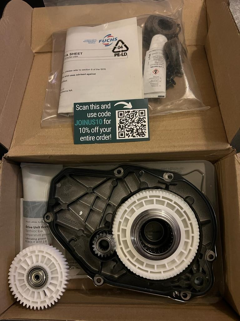

If the motor was too old, there is a service kit that includes the right side motor cover with the main bearings and gears that usually go bad in wet conditions. It is only just over $100. I just fixed two motors the other day, pretty easy. After that, they are like new.
Also replaced a 2015 Performance Line the other day with a brand new Gen 2 Performance Line CX. That guy was so happy, he was already thinking about buying a new bike. But his old one is even better now than when it was new 😁
That is awesome, but Bosch is really good when it comes to warranty even after 2 years.
thats what I needed when mine rusted out if bosch did not replace it. is this only for the drive side? on mine it was the left that rusted out.
