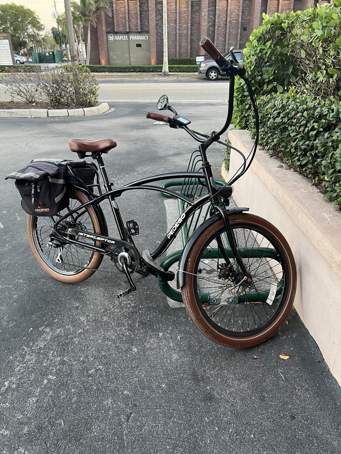

Hey folks, I was able to find an open box 500W Bafang hub motor with a compatible connector on eBay and rebuilt the rear wheel with a new rim and new spokes. The bike is working really well. All the other components are in pretty good shape after some TLC.
I'm having just one issue which is that the speedometer on the display is way off (jumps to 50 MPH at around 8 MPH) even though the wheel dimension setting is correctly set to 26". How do these displays actually calculate the travel speed? I would expect to see a sensor on one of the wheels to count rotations but I don't see one on this bike. Is it maybe communicated from the motor instead?
Having done some quick research, it looks like most hub motors come with three hall effect sensors, corresponding to each phase of the power being supplied to the motor. Hall effect sensors are pretty simple devices that just report back the relative motor position. Any ideas what would explain the different speeds being reported?
