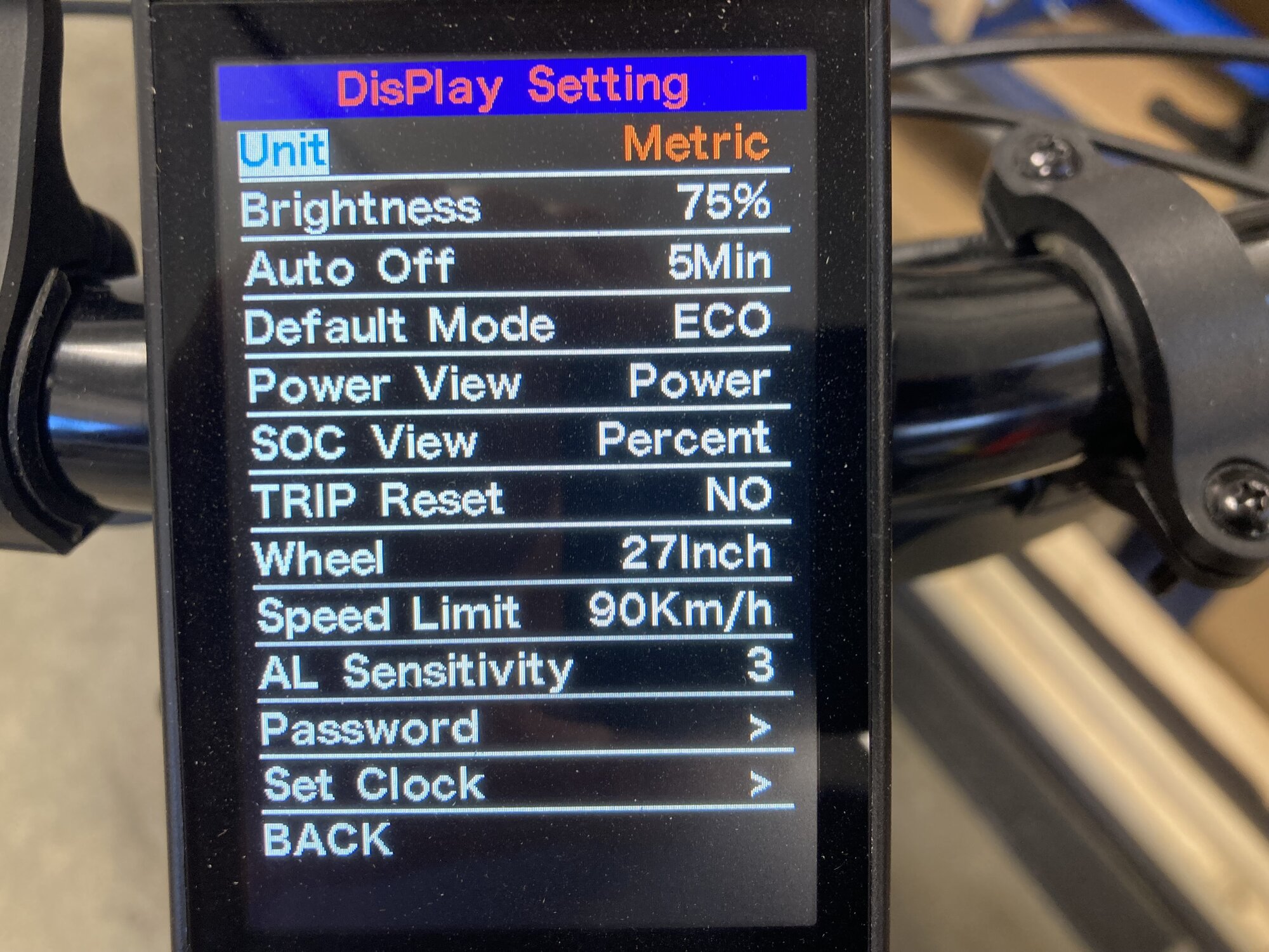

I'm trying to switch the PAS setting on my DPC18 display, but I can't see where I would do that on the display's settings' page. What am I missing?

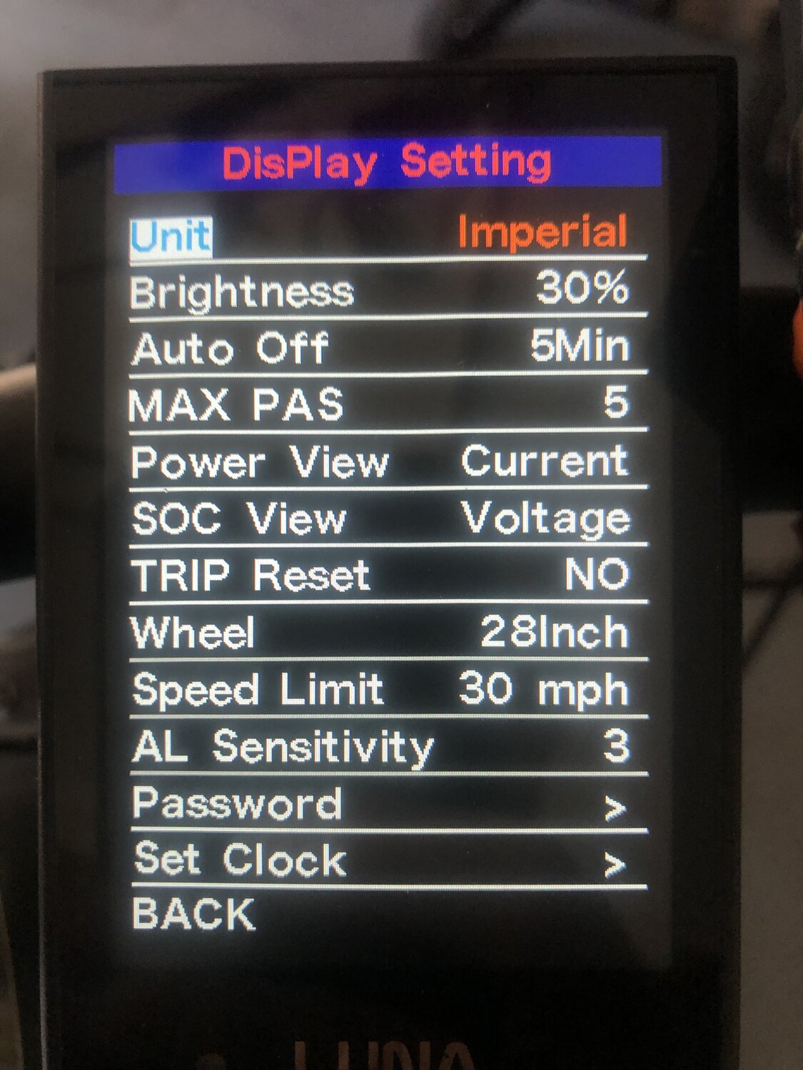

The DCP-18 display on my Luna Cycle Z1 (delivered June 22') is configured as below. I can change MAX PAS to 3, 5, or 9 levels of assist. It is UART comm protocol and the PAS setting can be further modified with a programming cable. Yours may be limited to the settings such as "ECO mode" and whatever other modes are offered? Looks like a proprietary setup. Is it CANBUS protocol?
The Eco/Sport version can't adjust the number of PAS levels. Eco is PAS 1-5 and Sport is PAS 6-10

That's it-thanks TDA78

Oh, you just have to hold the PAS+ button to switch between Eco and Sport. The default mode setting is which one you start with on power up.
