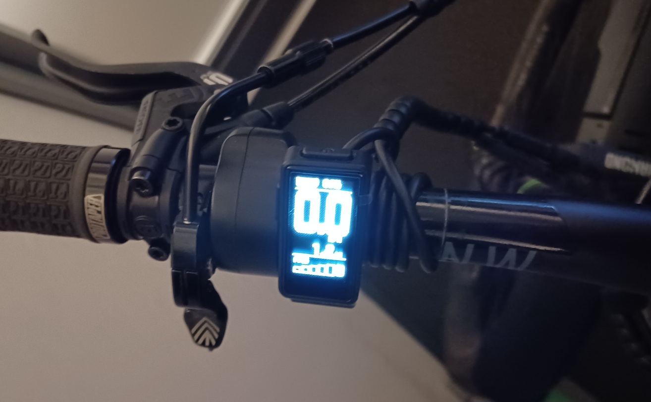

Does anyone have and use the Innotrace X2 display , I'm contemplating getting it and am curious of the main differences between that display and the DPC-18. Any features lost/gained between the two , does the innotrace X2 work well in the sun (easy to read) I'm looking for a smaller display as I would like a Garmin Edge where the dpc18 screen is

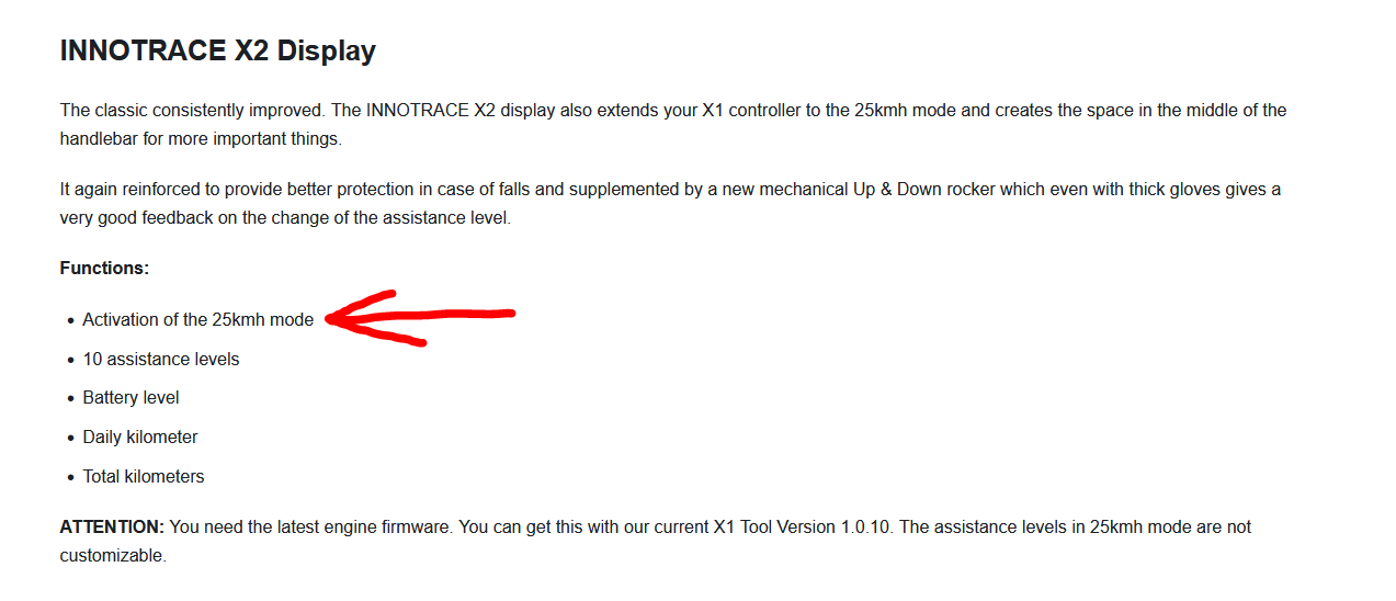

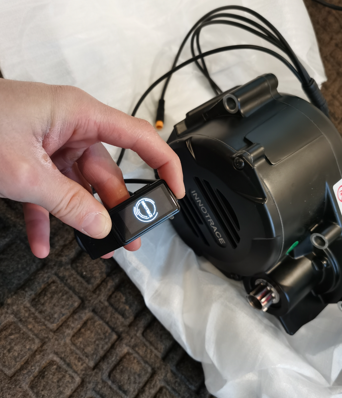

On the Innotrace website they say you can activate 25kmh mode on the Innotrace X2 display. I guess that means you can deactivate it too or it is deactivated by default? So my question is how do I activate it and and how do I deactivate it? My Innotrace motor has no instructions or anything.

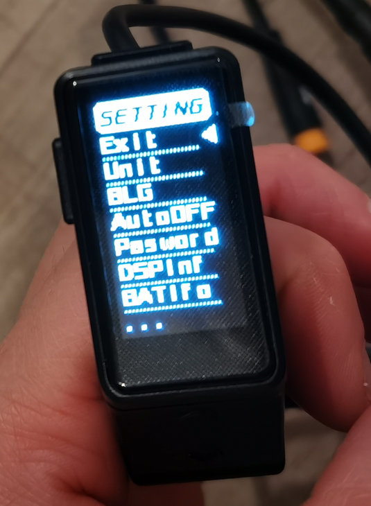

OK, I figured out how to enter the display settings menu and change the speed measuring units to mph following the Innotrace X1 display instructions they posted here https://acts6-my.sharepoint.com/personal/r_czernig_inno-trace_de/_layouts/15/onedrive.aspx?id=/personal/r_czernig_inno-trace_de/Documents/Anleitung X1 Display Englisch&ga=1

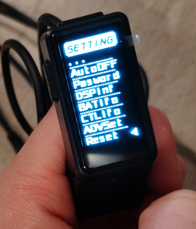

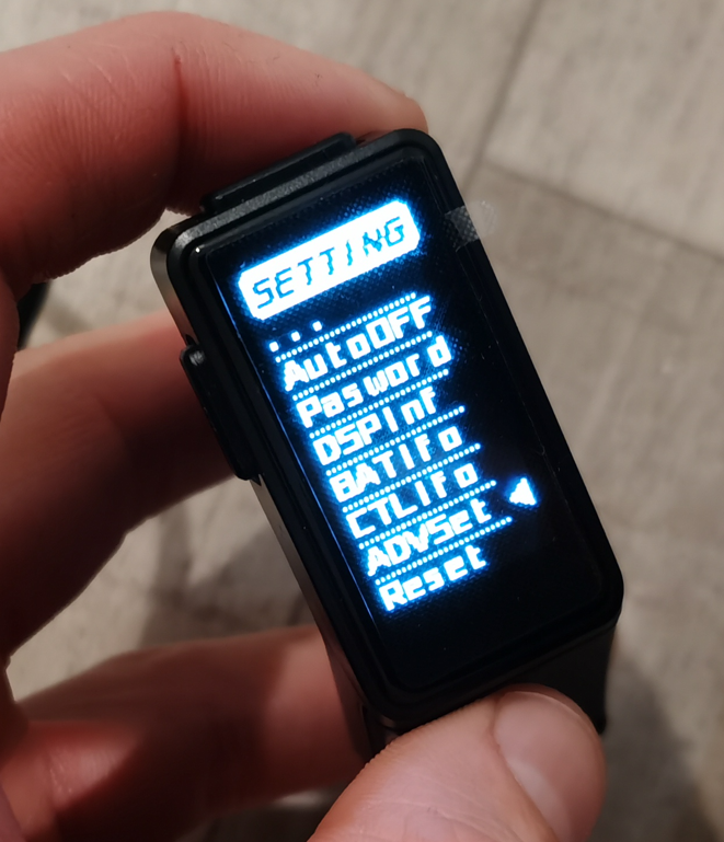

To enter the display setting menu on Innotrace X2 display you have to turn the display ON and then press and hold the "M" button withing first 10 seconds after the display is turned ON.

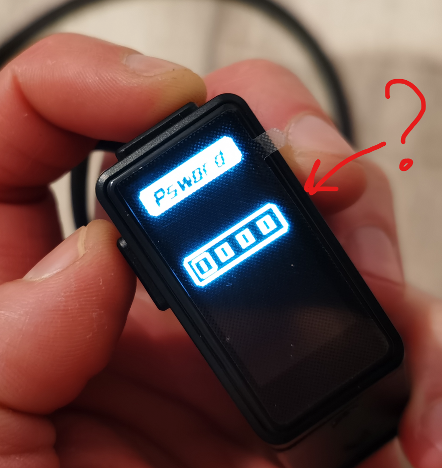

But for some reason the menu on Innotrace X2 is different to what they show in the Innotrace X1 display instructions. It does not have wheel diameter settings, it also does not have speed settings. The display has mysterious "Advanced" settings but it is locked under 4 digits code. Do you know the code?

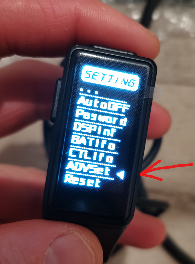

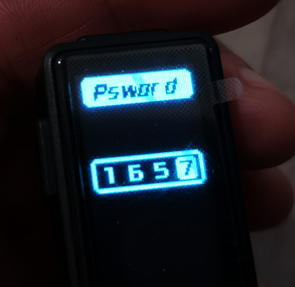

Albright great news! I found the advanced settings code for Innotrace X2 display.
The code for advanced settings on Innotrace X2 display is 1657

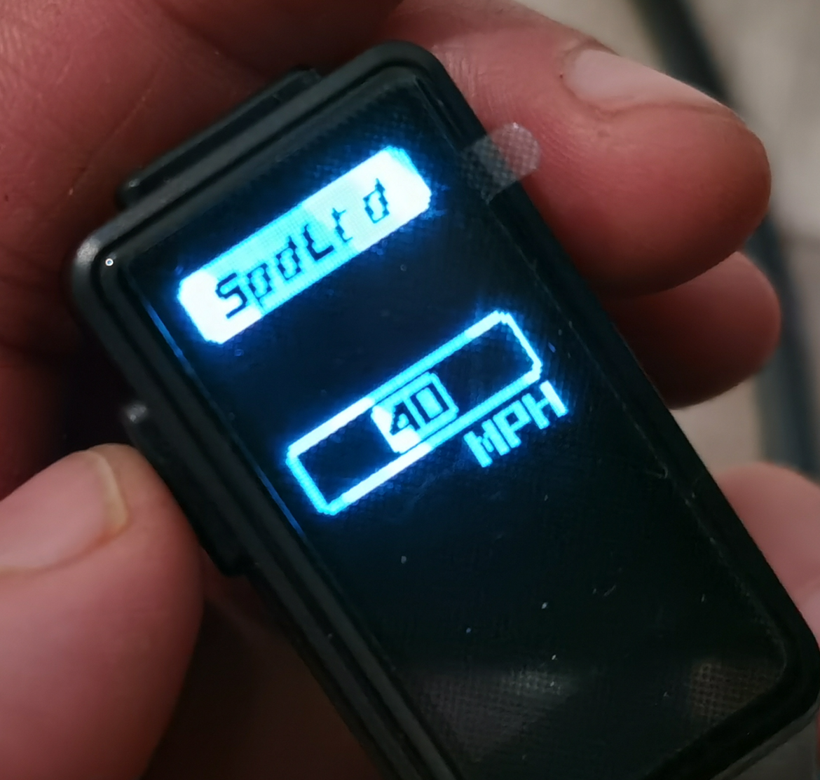

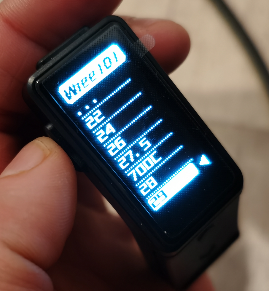

Now I can set the wheel diameter (mine is 29 inches) and the speed limit (by default is was set to 15 mph).
So you go to the setting and then go to the "ADWSet"
Set the password 1657

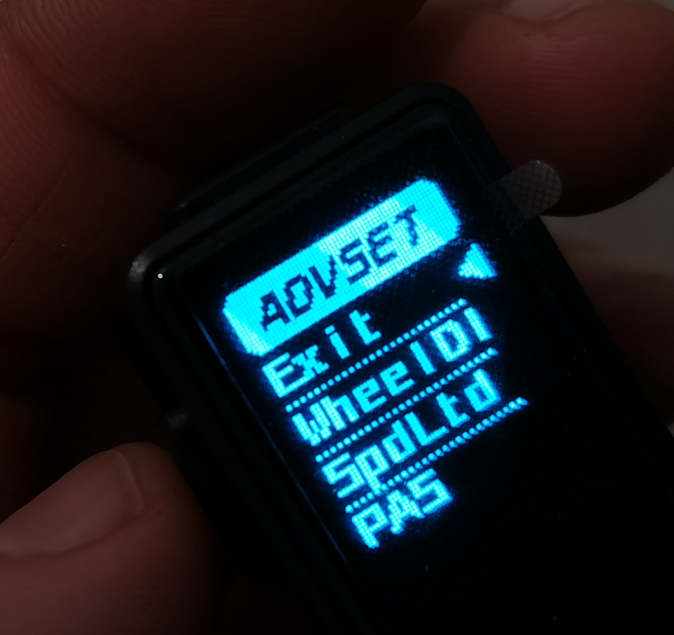

And now you are in the Advanced Settings menu
Set your wheel diameter
Set your pedal assist speed limit
