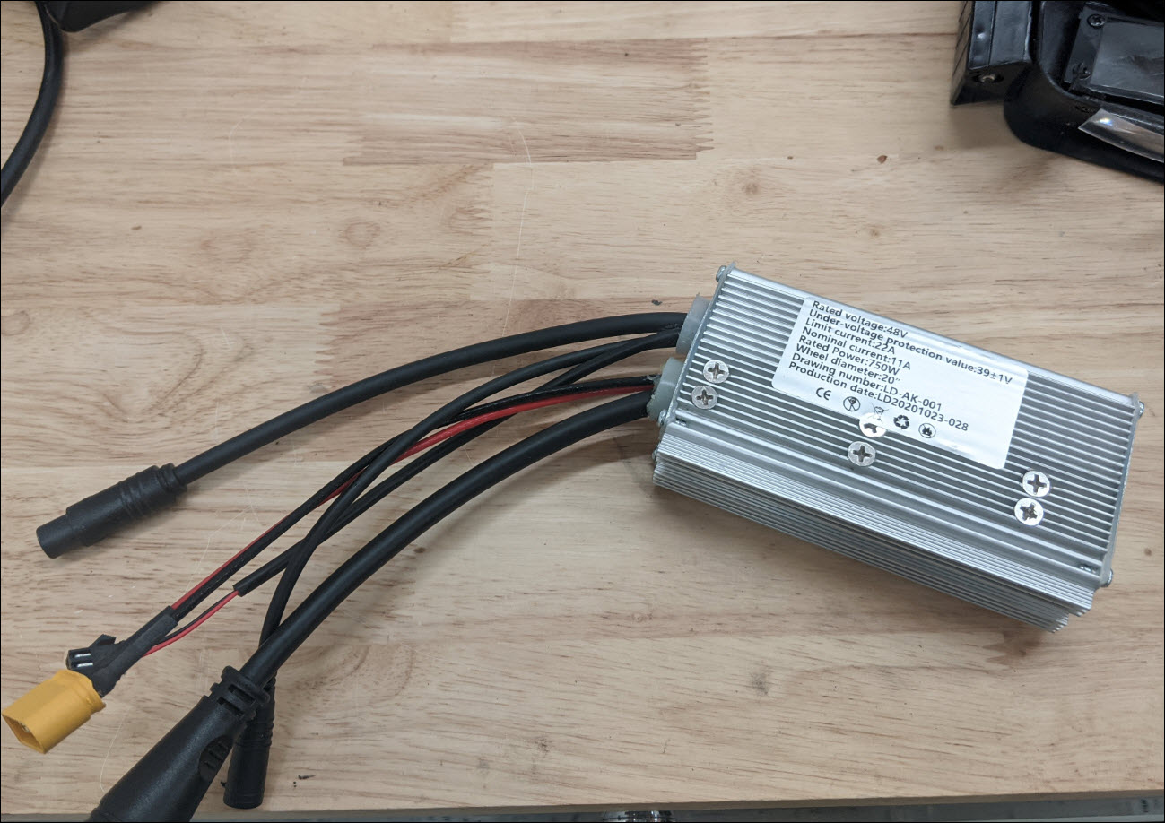

Hi I have 750watt 48v Bafang rear hub motor,I have 25A controller LD-AK when I put the bike into PAS 1 the motor kicks in and then stops the PAS sensor light is blinking.
Funny thing is when the wheel stops spinning when I pedal again the motor will turn and then cut off.
It won't turn continuously any ideas please .
Yes thanks for that I'll give that a go I have the feeling that the original sensor is not compatible with this bafang controller so I'll change it for a dual 12-magnet sensor
