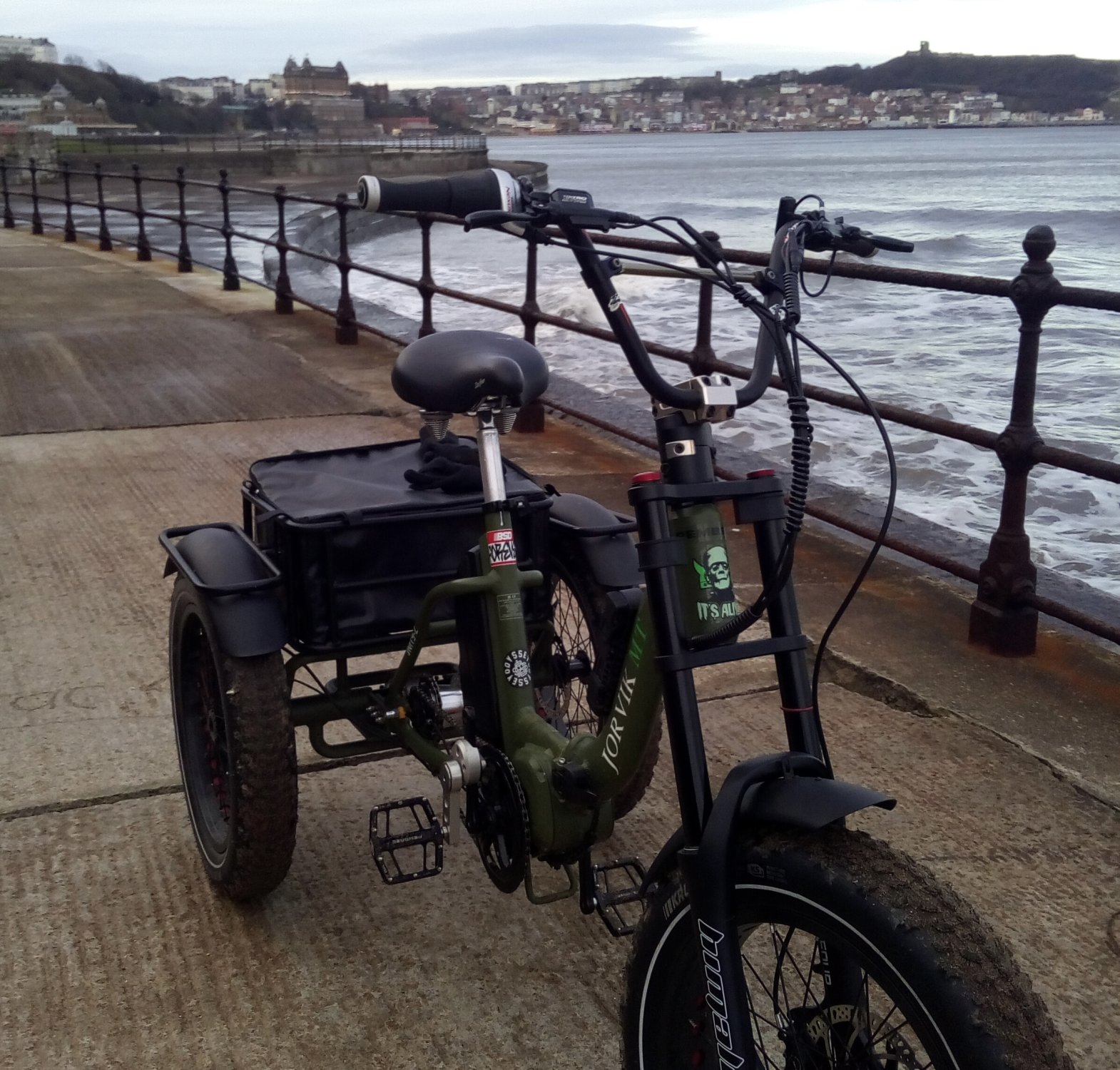

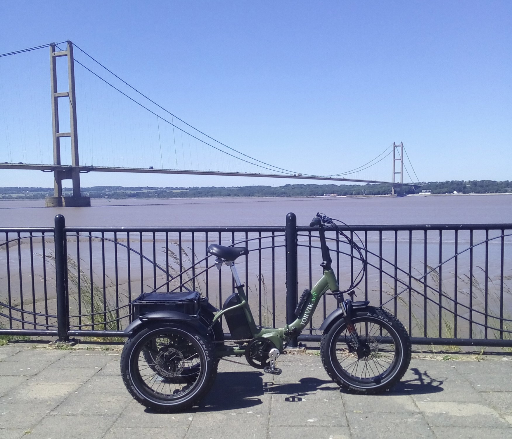

franken trike
Looks very tidy, not Frankentrike at all, but please explain the contraption.
its just Jorvik mt 9 modified to fit my needs heavier forks ,a folding stem adapter so I could fit bmx bars that feel a lot stronger than the origonal magura mt5e brakes and a roxshocks dropper post ,tannus tyre inserts and the restriction of movement peddle and an egg rider display so I can play with the motor settings work is still ongoing
