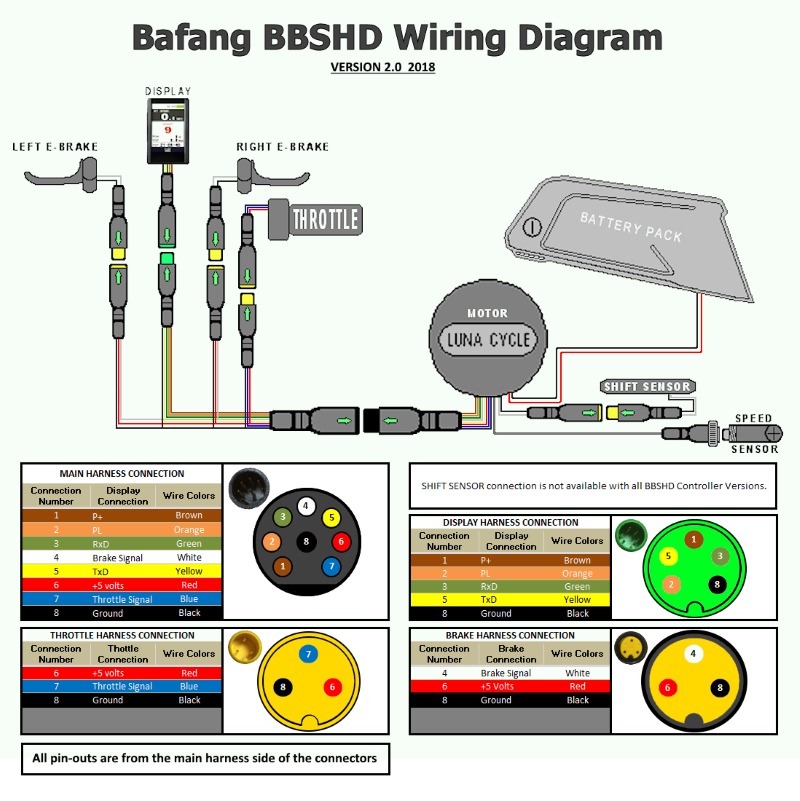

I’ve come to the time where my hips are playing up been a mad cyclist for ever so not so good on the peddle power anymore I’m a 67 year old guy who still loves to cycle. So I decided on getting a ebike bought it 2nd hand it’s a cube with a bafang 750 mid drive motor with peddle assist great bike lots of power well do me anyway. So guys my question is can I fit a throttle either twist or thumb throttle to my bike if so how do you actually wire it in. Any help or guidance on this would be so appreciated many thanks Kevin

Hi it’s a BBS02 motor and I bought a twist throttle and a thumb throttle both 3 pin tried all cables that’s near handle bars coming from the main wiring loom but no good nothing seemed to happen. And thanks for your reply
Do you have unused cables coming out of the main harness cable?
Yellow in color?
Send us a pic of the mains cable setup
Your BBS02 is definitely throttle ready.

Yes I think there are 3 unused cable from the main harness all yellow 3 pin tried one make and 2 female
Sorry all yellow one cable is a 3 pin male and 2 other yellow cables both female also under the bafang motor there is a 4th cable also yellow female 3 pin

This is the standard BBS02B/BBSHD harness used in the kits. I believe Bafang changes the gender on the throttle connector. It uses male pins at the harness, but most generic throttles want to see a female connector. You probably stuck your throttle into the brake connectors, which are female.
So your male connection should be the throttle. I presume your other two are connected to the brakes?

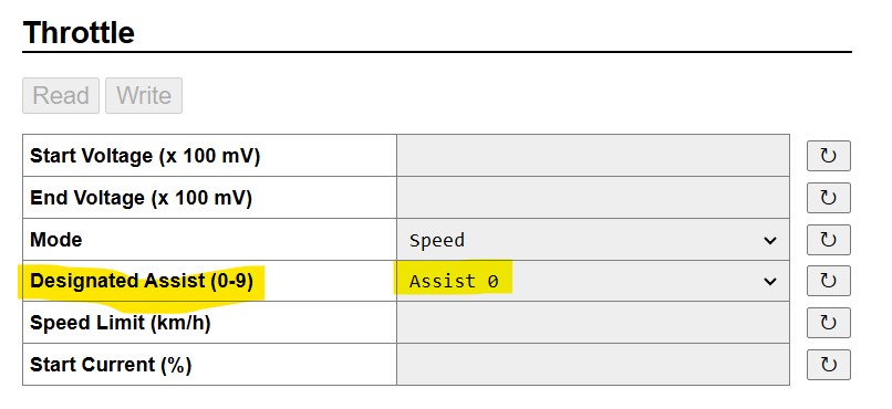

If you connected a female throttle plug to the male plug on the mains and it didn't work, it's very possible that your throttle is disabled or set to "0". I suspect that is true since your bike did not come with a throttle. In that case you need to configure the throttle, which is actually easy but you will need your windows computer/laptop and:

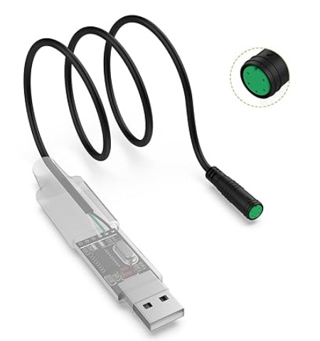

This programming cable (found all over Amazon) for $10-15.
Then you will need to access the internal controller software. See Bafang Programming Instructions. One you understand the process, I find this web-based solution easier than downloading and installing any software or drivers: BafangWebCFG. It's just plug n play.
Heed the warning to first save you current configuration so you can reinstall it if need be.

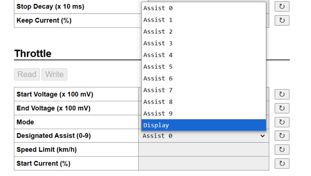

Basically you will be editing the THROTTLE tab in the software, which may currently be set to "0" right now which means your throttle will be nil.
You will want to set it to "Display", then it will be the same as what is set on the display’s current settings.

Well, before you get into settings changes, were your two throttles the right type? They must be a female socket, and I'm not sure that a gender adapter gives the right pinout.
Also buy an actual bb0s2b throttle, not just a bafang throttle, as they may differ between the hubmotor and the midmotor,

When you plugged the throttle into the male plug, and tried the throttle, was your PAS setting on the display at "0"?
Did you try the throttle when the PAS setting on the display was at a higher number?
The Throttle may be set to not work on "0", but kick in on the other PAS levels.
Now that you mention it power assist was on one not zero as when I turn on the screen it automatically goes on one. Does that make a difference or is that the reason the throttle did not work
No that is normal. There is a seting that controls where your PAS starts when you turn it on. If it was in PAS 1, the throttle should have worked, unless it is set to 0/off in the controller

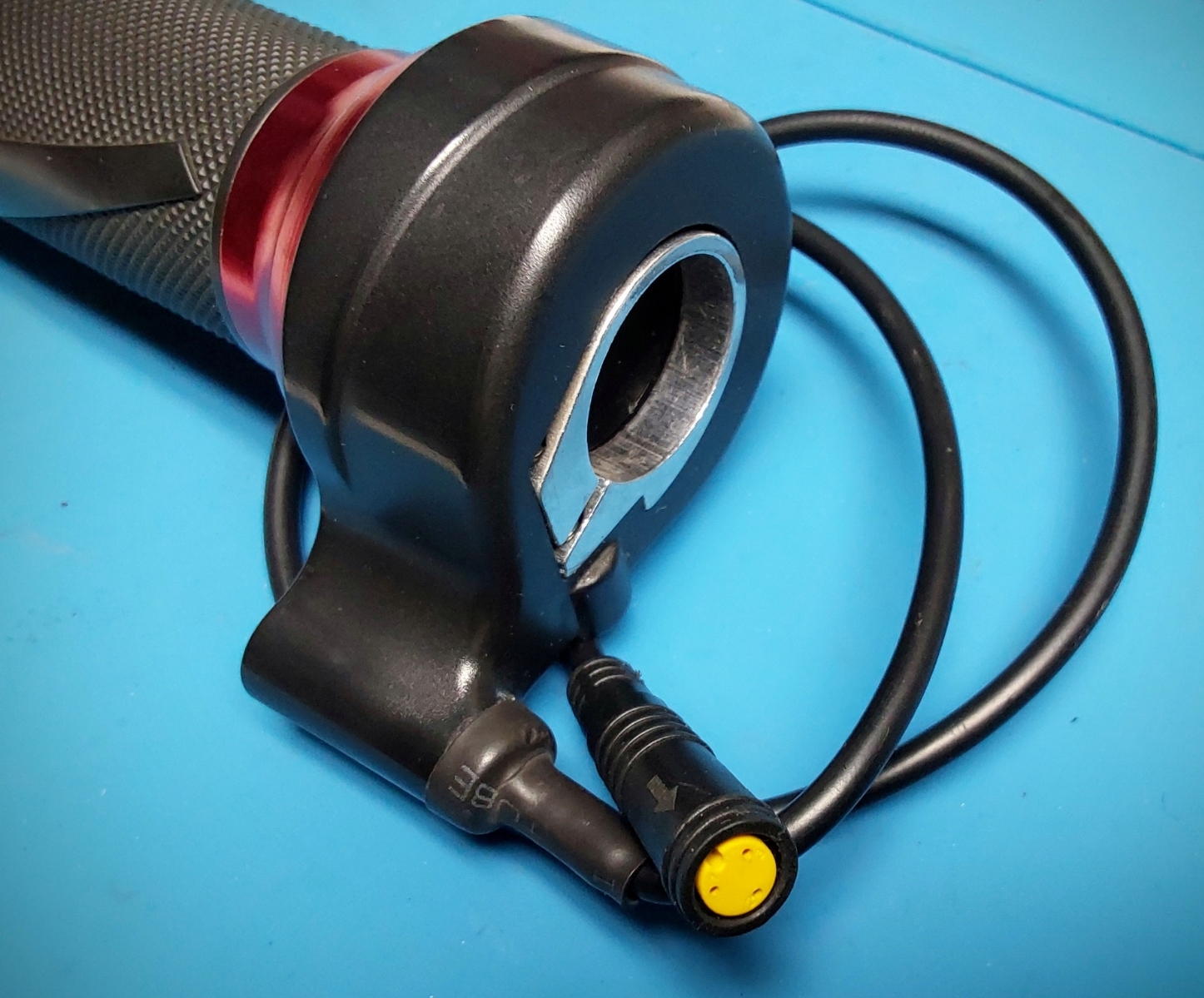

But as you are doing already... Make sure you are using a Bafang mid drive throttle which should look like this 3 Pin Female

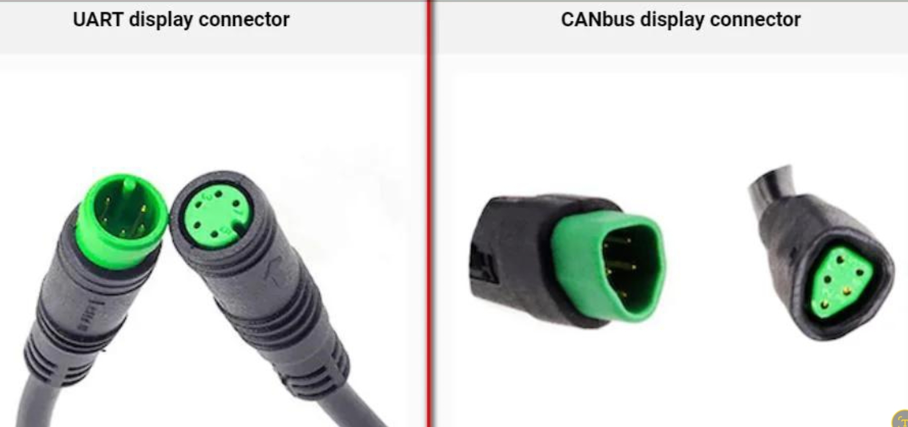

One other consideration is whether or not the controller uses the older UART communication protocol or the newer CANbus protocol. I don't believe they call the CANbus version a BBS02B but something like the M325. They look identical so the easiest way to tell is to look at the display connector.
If it's round it is UART and can be programed.
If it's 5 sides it's CANbus and can not.
Both use the same throttle so no problem there.
