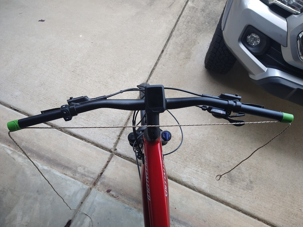

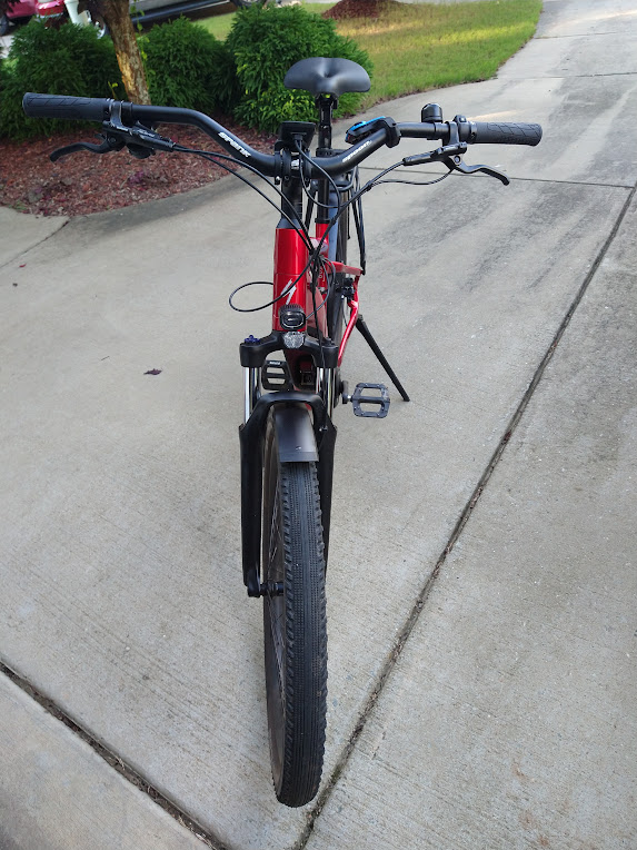

Getting back to one thing I wanted to change - handlebars that are roughly 1" higher and come back a bit - I opted to do my research and find a pair that might work. Due to the Vado stem uniqueness, I decided on bars vs stem risers, adjustable stems, etc. I landed on the Spoon Spank with 60mm rise (https://spank-ind.com/products/spoon-bar?variant=8111838658674) at ~$45/shipped. Seemed a reasonable risk...
Upon mounting them, I found (with the bike level side-to-side and the fork locked):
  • Taping a string to the each end of the stock bar vs Spoon, and measuring from from that string to the nose of the seat, the new bars are 1/2" closer to me/the seat (19" stock bar, 18.5" Spoon bar);
  • Stock bars were 42" from ground to the bottom of each end. The Spank Spoon is 43".
  • The Spank bars are approx. 4cm wider than stock, and I felt this immediately.
These bars are way too wide for me at 785mm, but they are adjustable to any size. I'll continue riding and trim them down to find the best width for me. I may also pivot them up a bit for a position that is more comfortable.
For the cost, this has been a great experiment and I believe with some minor tweaks, I'll have the ideal riding position.
Stupid photo of how I measured:
What they look like, yawn:

Mmmmk, these Spoon Spank bars are 785mm, stock Vado bars are 680mm. Guess I need to keep cutting....

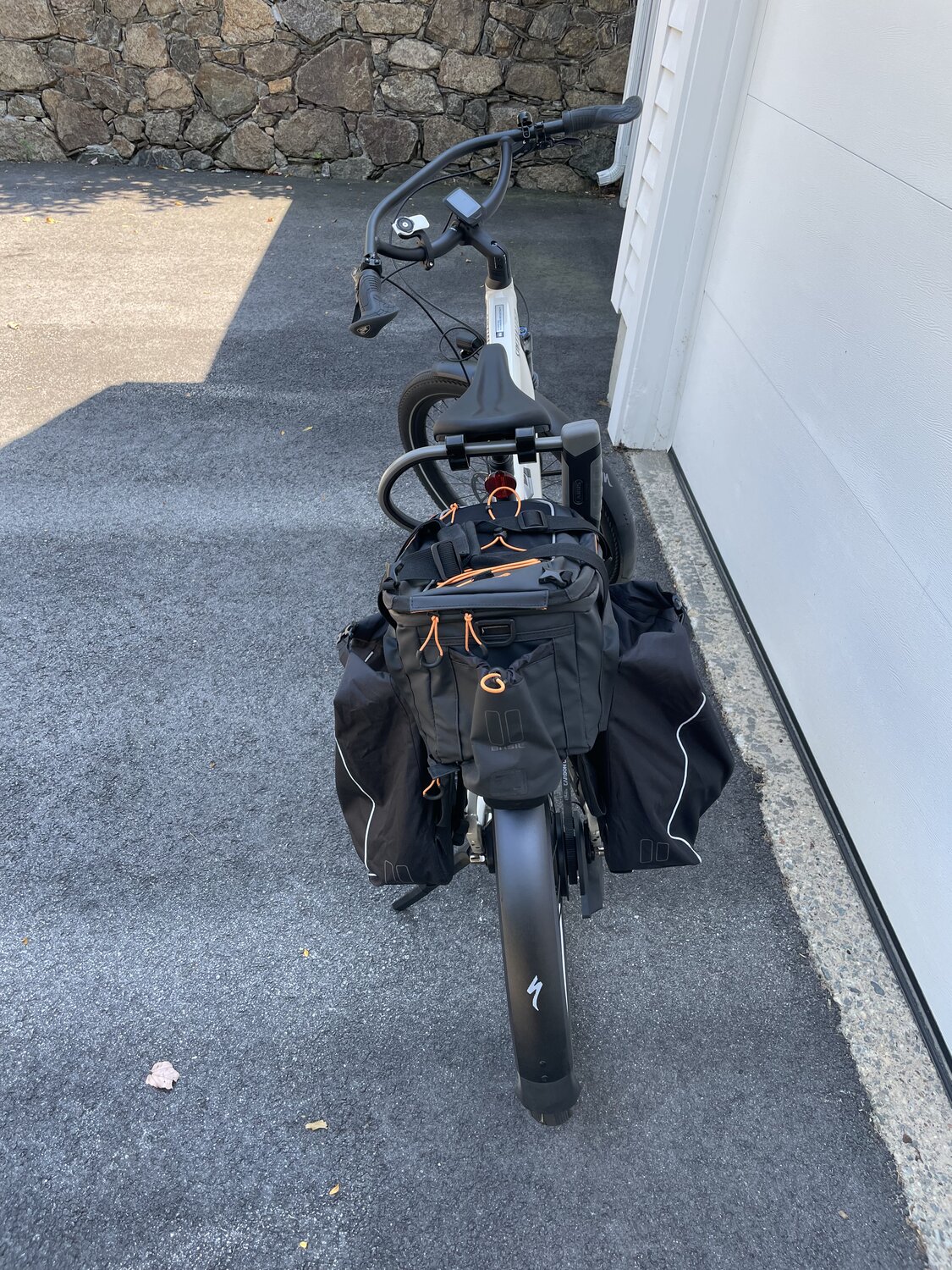

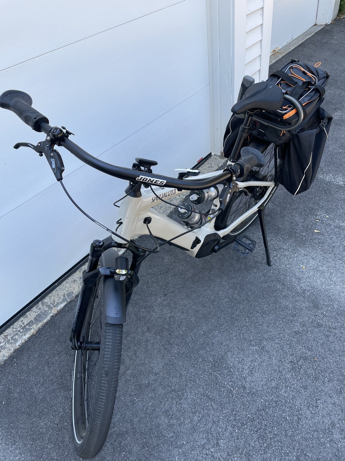

I ended up going with the Jones H-Bar with 2.5 inch rise - I like the more upright position on this bike.

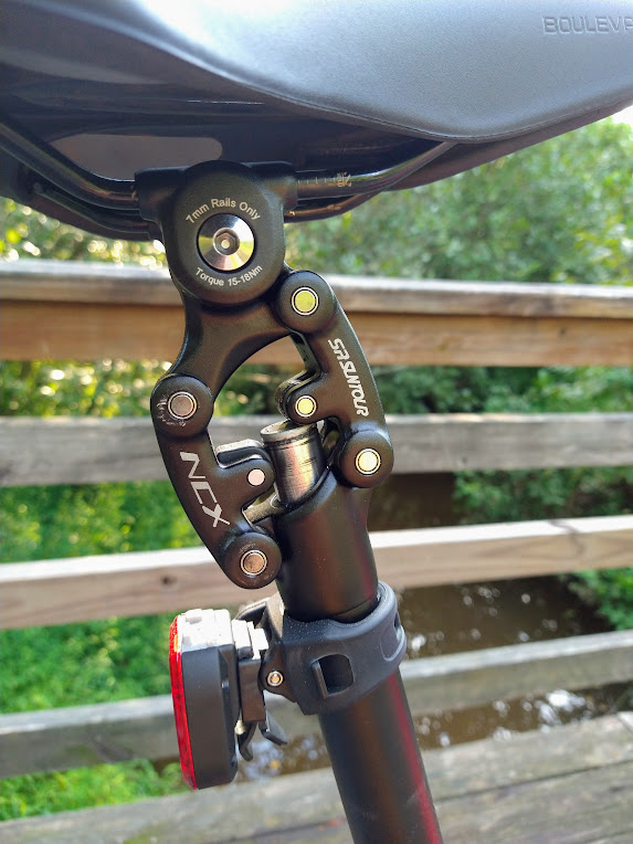

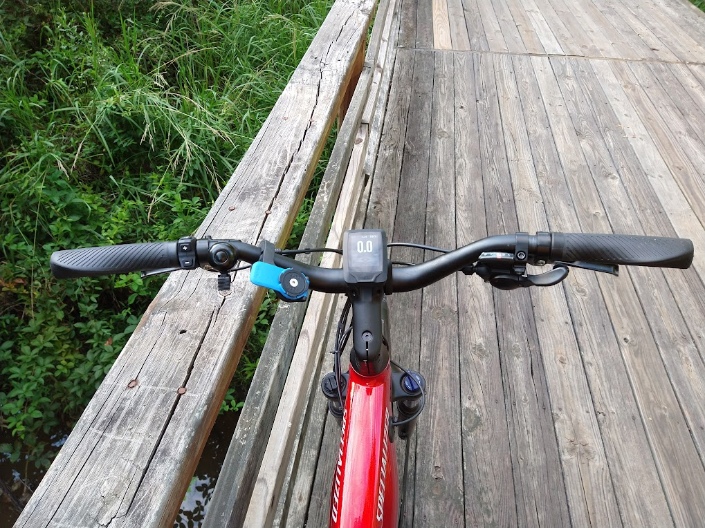

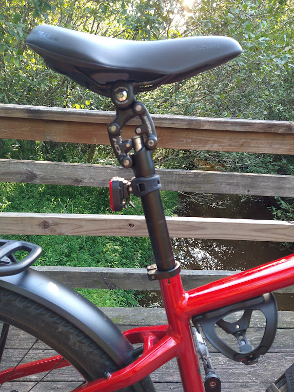

I believe I have zeroed in on the perfect riding position for me, with 1 minor nit: the shift lever.
Spoon Spank bars cut shorter just a bit more than the stock bars. I actually took a bit more off the left side as that seemed to be the sweet spot for me.
I then rotated the bars up as high as possible.
Then, I flipped the Suntour seatpost top mount as documented here: https://electricbikereview.com/forums/threads/whats-not-said-about-suntour-ncx-seatpost.48561/
Removed the Ergon GA3 grips, went back to stock Specialized grips.
The only issue is I simply cannot find an ideal position for the shift lever. I broke/mangled my right wrist several years ago in a bicycle wreck, then re-mucked it it in a car accident, and no adjustment seems to work for me.
My hips are now directly over the crank centerline; I am positioned such that I still have the "active" position (body angled at ~45*?); wrists are perfect; hands feel fantastic; arms are almost perfectly straight shoulder-to-wrist. With ~75 mi on this setup, with a long single ride of 16+ mi, I am completely and perfectly comfortable; and ready for much longer rides. I'll keep fussing to see what I can do with the shift lever, but to say I am thrilled is the understatement of the year. Gawd I love riding this Vado!
Pictures might not help, but here's where I am:
"Flipped" seat mount, this is key:
Different view, positioned thusly again my hips are perfectly aligned with crank centerline:
Gratuitous cockpit shot:
