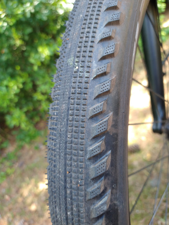

Schwalbe Hurricane tires. I went with 27.5 x 2.25 instead of the 2.4 wide. As I've only had the stock Pathfinder tires on my Vado, take this fwiw:
- PSI range for us cavepeople in the US is 30-50psi. I set them at 40 psi to get a feel for them.
- They are quiet. "Whisper quiet" per the Schwalbe marketing? I suppose, no difference between them and the Pathfinders that I can discern.
- They seem to roll as well, maybe slightly better than the stock tires. They run a bit smaller (about 1/2" less diameter), which is obvious in the fender clearance.
- The side lugs are not as pronounced as I expected, but they are beefier than the stock tires.
- On the dirt hills, traction was similar to the stock tires. One part of a nasty hill I enjoy riding up had a fresh layer of sand (!) and I could not get any appreciable bite and had to walk it up. After a good rain when the surface is back to usual state, I'll see how they do. The stock tires just spun on this hill.
- They are definitely more supple and compliant, esp in the rough stuff...
- ...and they took some nasty rocks just fine, sidewalls got scuffed up pretty severely but no issues.
- They "look" better imho; however, safety is somewhat compromised since they do not have the reflective stripe all the way around.
- I'll revisit after some miles, but initial impression is they are a good replacement tire - not a huge upgrade nor transformative by any means.

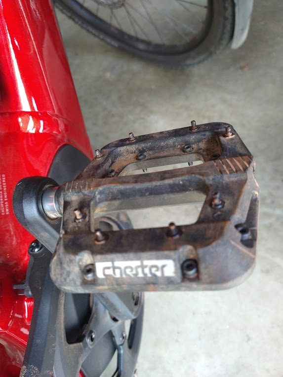

I also removed the stock pedals and put on some old Race Face Chester pedals I had. This completely transformed the bike! I know it is old hat/common knowledge, but my feet kept slipping off the stock pedals w/ the grip tape. Now, they are 100% planted throughout the pedal cycle - when I thought this bike couldn't be any better to ride, it now is! Gaining that confidence that the feet will stay in place and power through is just awesome.

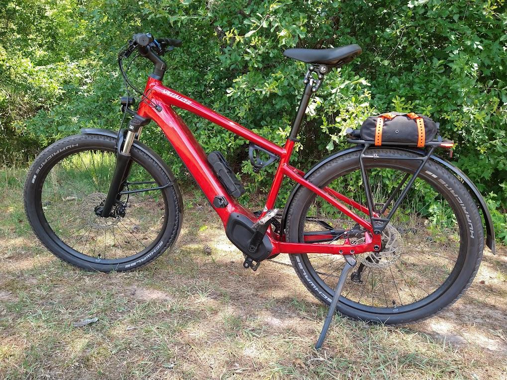

Some current pics.
120 seconds before the crash:
Tire closeup:
Love these things for grip and easy replacement of the nuts:
