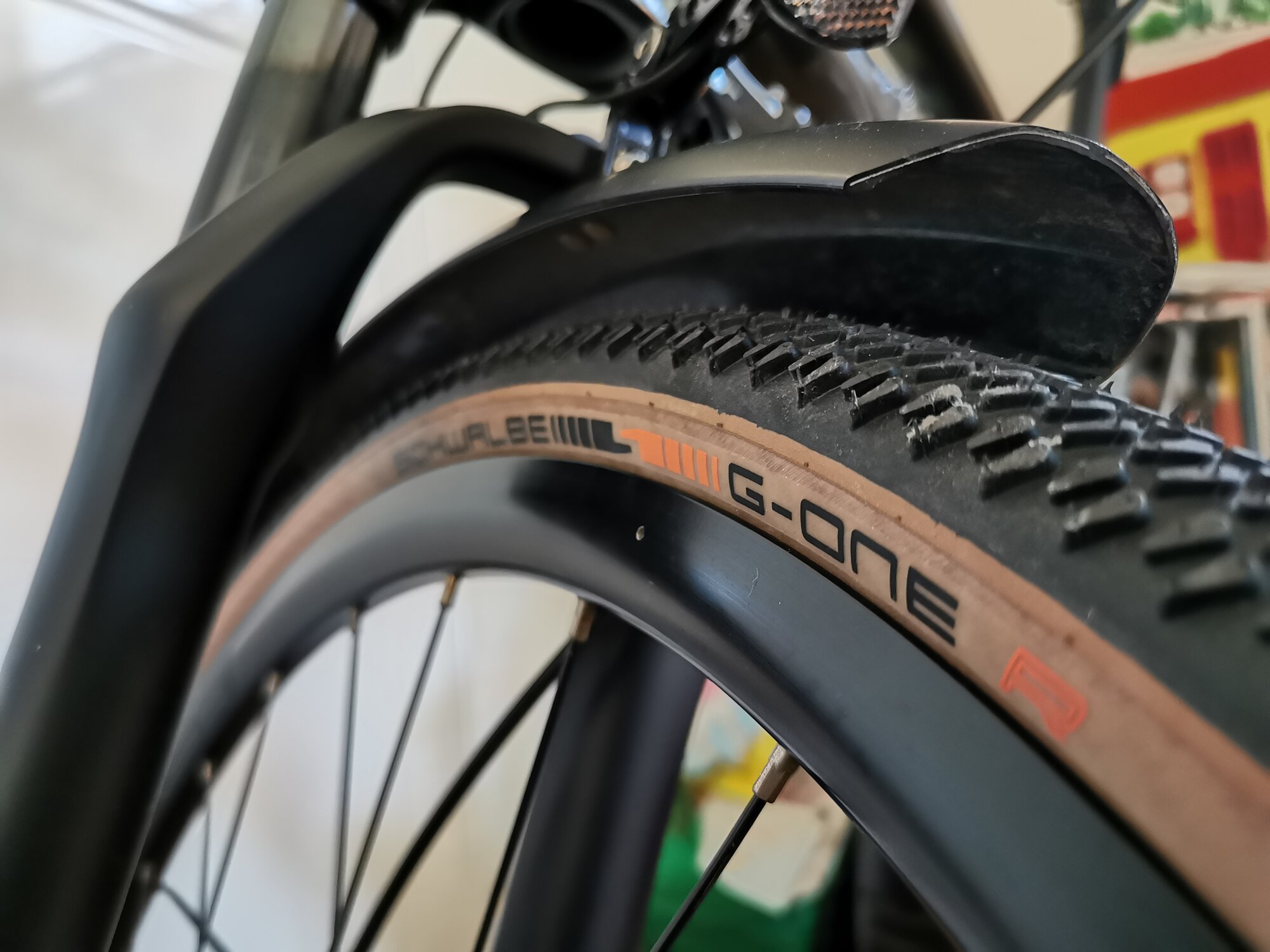

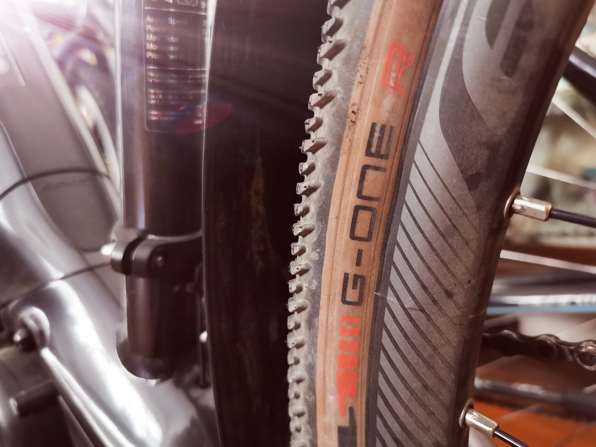

Just an update. I settled on the Schwalbe G-One R tyres. They rate impressively well across the board (see below) and have garnered pretty impressive reviews so far.
I ordered them in 40-622 size. Cost was about AU$95 per wheel, so not cheap. I opted for the 40 over the 45 to keep using my 35-40-622 Tannus Armour inserts. Next time round I'll bump both up to 45-622.
The big caveat with this spec is each tyre is rated for 70 kg load versus 100 kg for the other G-One models. I'm pretty light and got the bike up on the scales with some simulated load before the purchase. I found the rear wheel sat on 50 - 60 kg. This limitation may rule out the R-spec tyres for many.
I switched the Tannus from my Marathons. They've traveled 5,000 km in 18 months. I was quite impressed with the protection they still offered - at least to the touch. They weren't overly flattened and I did find a few little metal shards embedded in the inserts. Whether these would have been enough to puncture the tube I don't know, but it was evidence to me the Armours do offer significant additional protection. I'll continue to run with the inserts, but would consider a Armour tubeless setup with the next set of tyres.
For the record the Marathon Plus tyres had done about 7,500 km. Two punctures prior to fitting the inserts, none after. I'd guess the tread was good for another 3 - 4k at least, so very impressive durability.
Fitting was not what I'd call easy. Out in open air the Armours expanded to about an inch greater circumference than the tyres, which mean a lot of massaging to fit them inside. I used a liberal dose of talc powder to assist. The tyres were also quite hard to fit onto the rims, and required careful use of a tyre lever to ease them in. All up it took about an hour per tyre, about double compared to fitting the Marathons. My fingers are pretty raw after the experience. I don't picture myself doing a field repair with this setup - I'd limp home at 10 km/h on the flat tyres or ditch the inserts and patch the tube.
The single tracks around here are still quite muddy after a recent storm. The tread pattern really doesn't favour mud. I'll take them out for a maiden ride over the next day or two. The tread feels really grippy compared to the Marathons, and up on the stand they feel a lot lighter and easier rolling. I'll report back with my experience.

Well, I'm not to proud to report back on how the experiment went. I've been running the Schwalbe G-One R's in 40-622 size for a month now. I've done about 200 km over that time of mixed riding: sealed road, gravel fire trails, some technical single track and climbs. And it hasn't quite worked out. But first the positives...
They're exquisite tyres, as they'd want to be for the price. Rolling resistance is exceptionally good, surface feel is great, and I was satisfied with cornering grip on harder surfaces. In short they're a terrific tread for gravel adventuring without going full MTB.
Now the negatives. In my configuration they failed in the protection stakes. I got a puncture about 3 weeks in, a tiny hole in the tube about a third the way up the rim (eerily similar to the puncture @Dallant reported with his G-One Allroads a while back 👻). This was a new tube. Huge caveat: I'm running an unorthodox configuration, tyres with Tannus inserts and tubes.
I was hoping that would make up for the weaker protection spec, but in all fairness if I was running the standard tubeless setup with these tyres I guarantee I wouldn't have the flat. So this negative could be explained away with my setup. I've made the call that the risk of gash and tear punctures on my commute is too great to run tubeless so I'm sticking with Tannus for now.
On top of this the tyres with inserts are a bugger to repair. I'd hate to fix the G-One R's in the field with a pressing deadline at the end of the commute.
Secondly, the tread wear is pretty bad. I don't lock the wheels up much at all but there's some serious degradation on the tread pattern beyond what I'd expect after 200 km. A few of the lugs, if that's the term, are almost fully worn away. The tyre feels pretty wafer thin underneath too compared to the burly Marathon's, so at this rate I'd be up for replacements in a few months.
I think this has been a costly but important lesson for me. The tyres as they're intended are awesome. They'd be terrific to run tubeless and blast along fire trails on a lightweight gravel grinder ... really fun, confidence-inspiring tyres. Perfect as a recreational gravel tyre for lightweight setups. What they're NOT are commuter tyres. I've lost that peace of mind that comes with bullet proof tyres. And as primarily a commuter that trust in the setup is critical in my opinion.

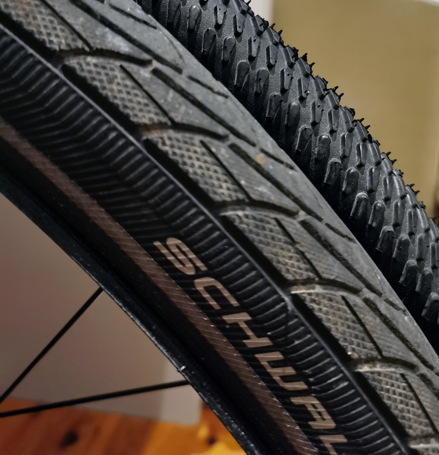

For now I've switched back to the 40-622 Marathon Plus on the rear, and kept the G-One up front. I'm running this setup for a little more front end traction. That's typically where it gets sketchy on my rides first. (Rear slide I'm less concerned about.)
So there you have it. TLDR: Nice tyres for play rides, not so much for commuting.
