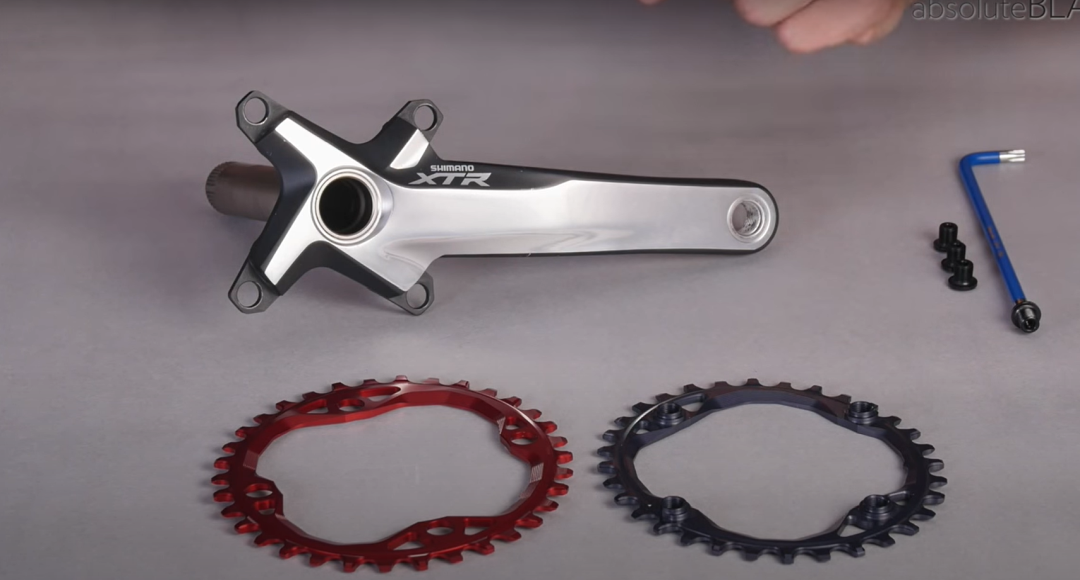

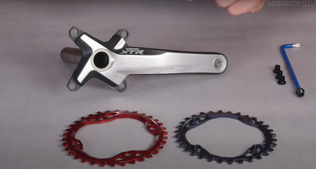

I totally disagree. The oval chainring only works as intended when the spider is the part of the drive-side crank so the pedal position remains fixed relative to the ring:
In a mid-drive motor e-bike, the spider is connected to the motor, and the crank moves independently of the pedal position, as @mschwett said. It is clear to anyone who has changed the chainring on their mid-drive e-bike at least once.
