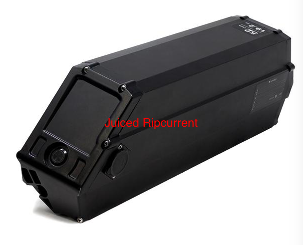

Hi Guys, i am looking for a non juiced brand battery for my ripcurrent S bike. It has a 52 volt, 19.2Ah. Do any of you guys know or have experience purchasing directly from china, using websites like dhgate, and aliexpress? Thanks!

Very dicey trying to order direct. Very easy to get fleeced. Consider EM3ev. Best of the aftermarket batteries. UPP for budget batteries but not the best BMS protection for DIY upgrades. Google EM3ev for reviews and YouTube for a factory tour. Who makes the case they use?

The 52V battery casing on Juiced is made by Juiced, not Reention.
No, it is NOT. Look, I imagine it begins to look like I pick on you. What I hope you come to realize is that no one of us can have ALL the information in a very broad market. But making definitive statements suggesting a bike maker like Juiced would have a proprietary case made at GREAT development and manufacturing expense and still maintain a low price, is either disingenuous or just plain naive.
It took me 5 minutes of looking through my vendor files...
View attachment 38882View attachment 38883

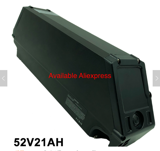

I found this case on alibaba. i contacted the rep and asked if this would work for juiced bike? i gave her the spec for juiced battery. Here what she told me:
"hello,after check it,we don't have this kinds of battery case"
"it is Juiced bike's private case,they applied for a patent of it."
