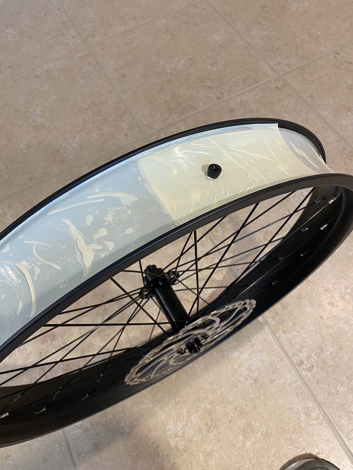

Started to convert the RCS Step Thru wheels to tubeless. I taped the rims and got ready to inflate the Vee Tire Co. Mission Command Fat tire but could not seat the tire. Took the wheels and Vee Tire Co. Mission Command Fat tires to two Bike shops and neither could not get enough air in the tire (valve core removed) to push the sidewall out for the tire to seat. This week I ordered Huck Norris fat tire inserts which should resolve the sidewall issue and allow me to seat the tire on the rim. This will also provide pinch flat protection. If anyone else has tried the fat version of the Huck Norris inserts would like to hear your experience.

Just finished my tubeless setup on the front of the RCS Step Thru. Last week I had the hub replaced with a Novatec 135mm and today the wheel was converted to tubeless. The rim was taped and tubeless valve installed. 8 oz of Orange sealant and the tire is seated on the rim. Wheel is much lighter and the hub makes the wheel spin effortlessly.

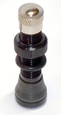

One tip from the conversion experience. The Stans 32mm schrader valve is good but the the locking nut that comes with it is not. I purchased another schrader valve set with O-Ring and nut to provide better sealing against the rim. The Stans rubber is volcanized to the valve stem and the rubber O-Ring and nut make a great combo. Very few choices when it comes to Schrader Valve tubeless sets. I found some of the other schrader valve rubber is very soft and deforms.

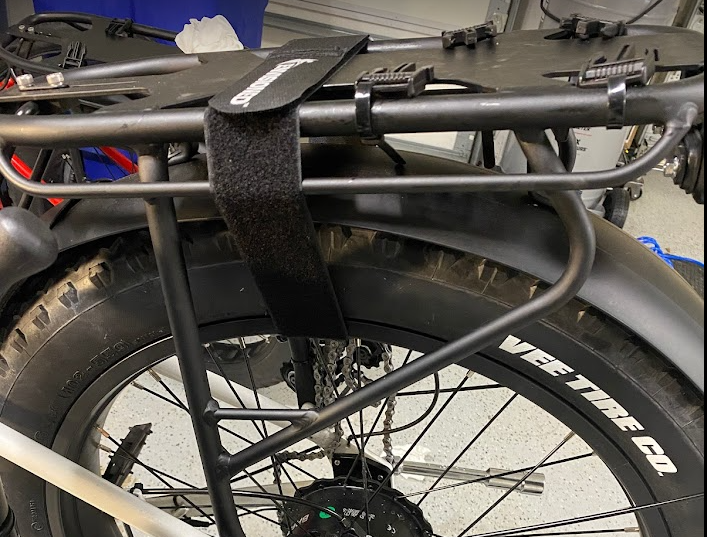

So after working on the RCS I wanted to share a procedure that helps hold the rear wheel on with just 1 person.
I have used a velcro strip to hold the rear tire and wheel tight against the drop outs. This allows for the washers and nuts to be installed. This only works if you have a rear rack. Juiced also has a guide to installing the rear wheel. Rear Wheel Removal and Installation - CC - Service Guide

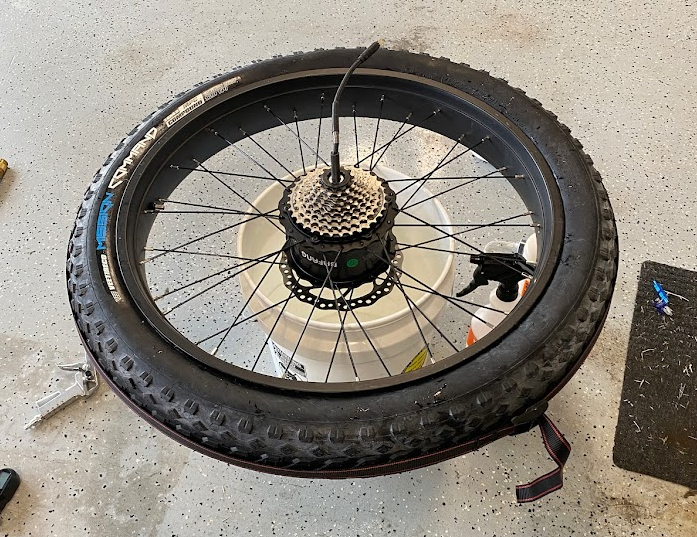

Also seating fat tires I found can be a difficult but if you get a Lashing Strap like the one I have from Home Depot Husky 1ftx8ft. Pull it tight to create a seal between the tire and rim works all the time. Just remember as soon as the tire starts to hold air loosen the strap. A hack I found online is if you remove the schrader valve and just insert the air chuck over the stem it forces 100% of the air into the tire much faster.
