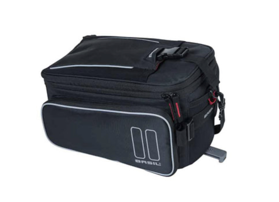

I can't help with the Ortlieb but I have the Basil bag.
I like the MIK mounting system and the bag itself is well designed. The fold out panniers are larger than most but aren't suitable for heavy items, like spare batteries or heavy tools. Like many other similar bags, the zippers are a weak point. They need to be treated gently and kept clean. I use a wax based zipper lube every few months on mine.

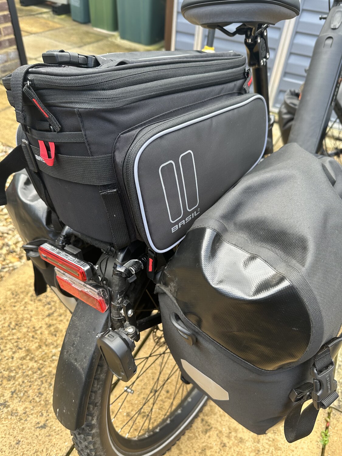

Ended up getting the Basil Sport Design Trunk Bag.

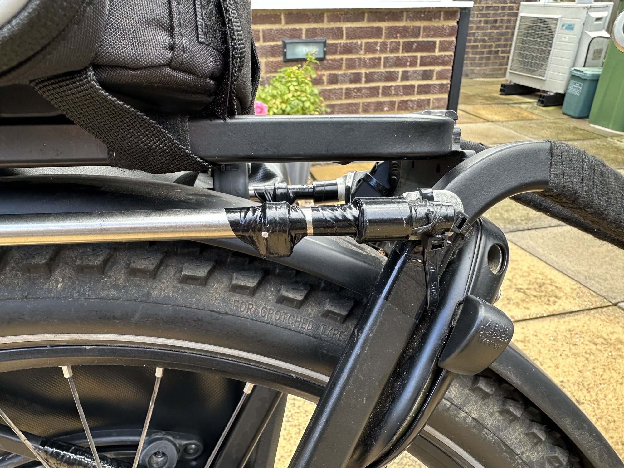

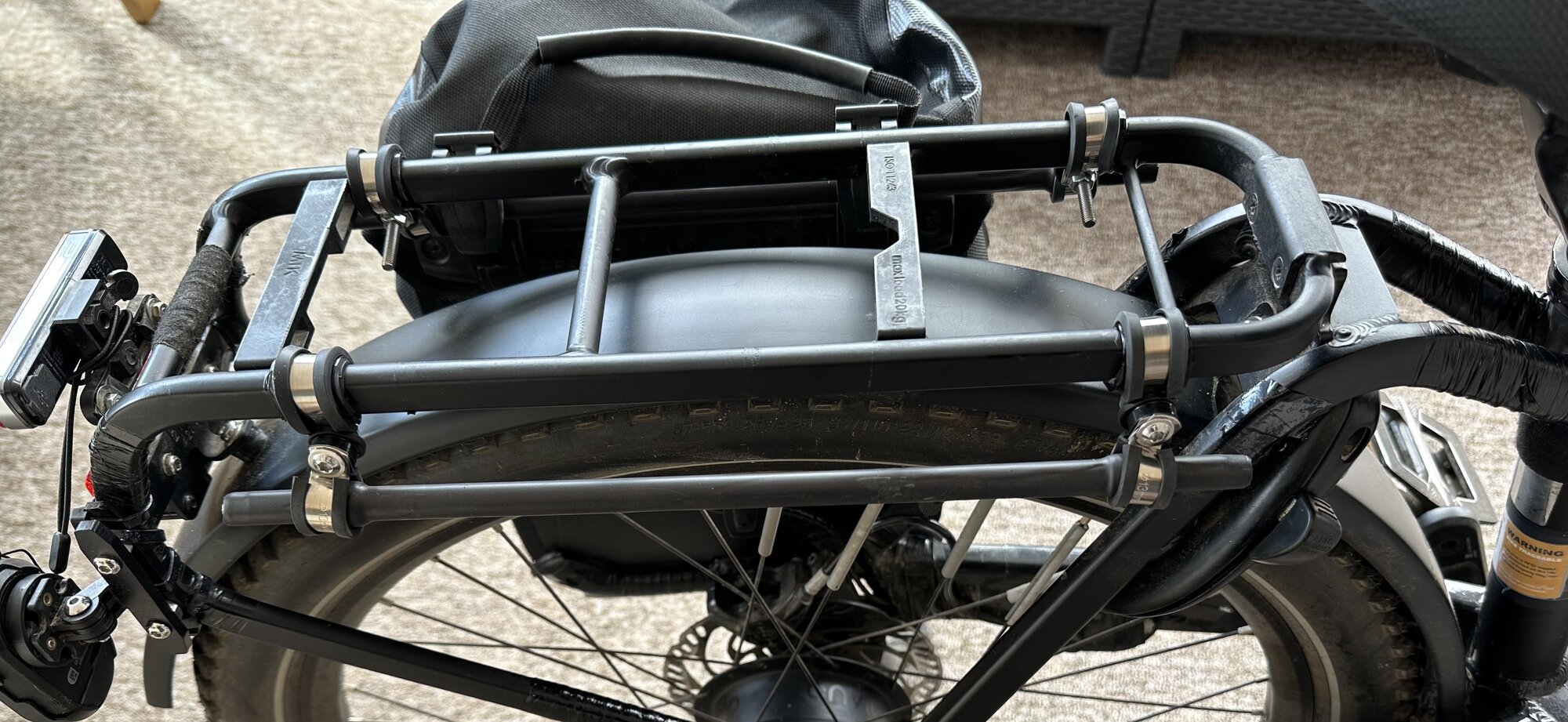

As I wanted to use it with the Ortlieb Bike-Packer Classic Pannier Bags, I‘ve added some stainless steel pannier rails. Only temporarily fixed with cables ties. Once I‘ve finalised the position I‘ll fix them in position with some bolts.
But in the meantime, not too bad.

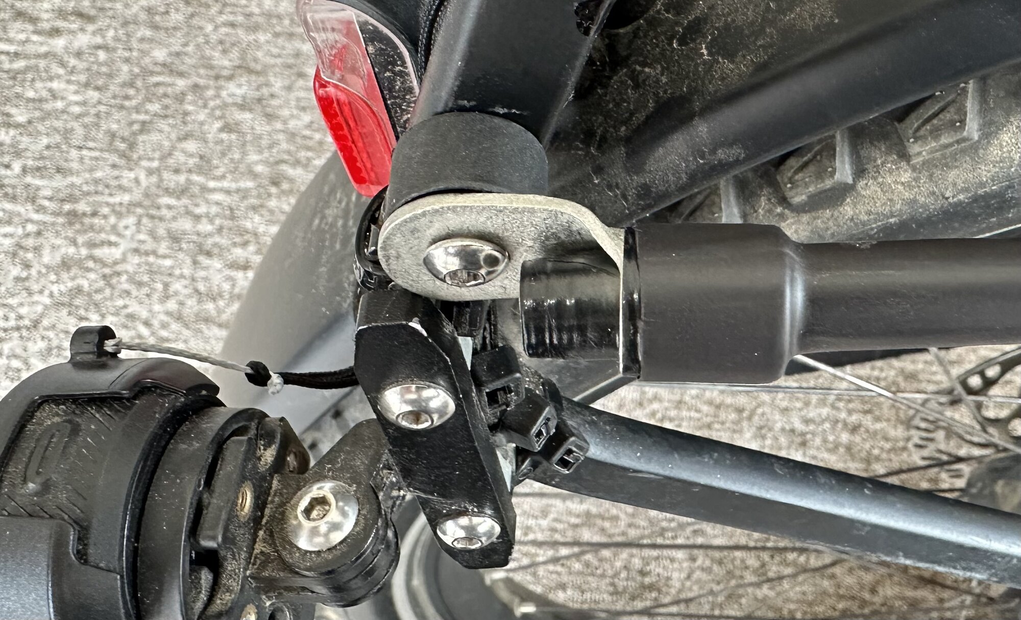

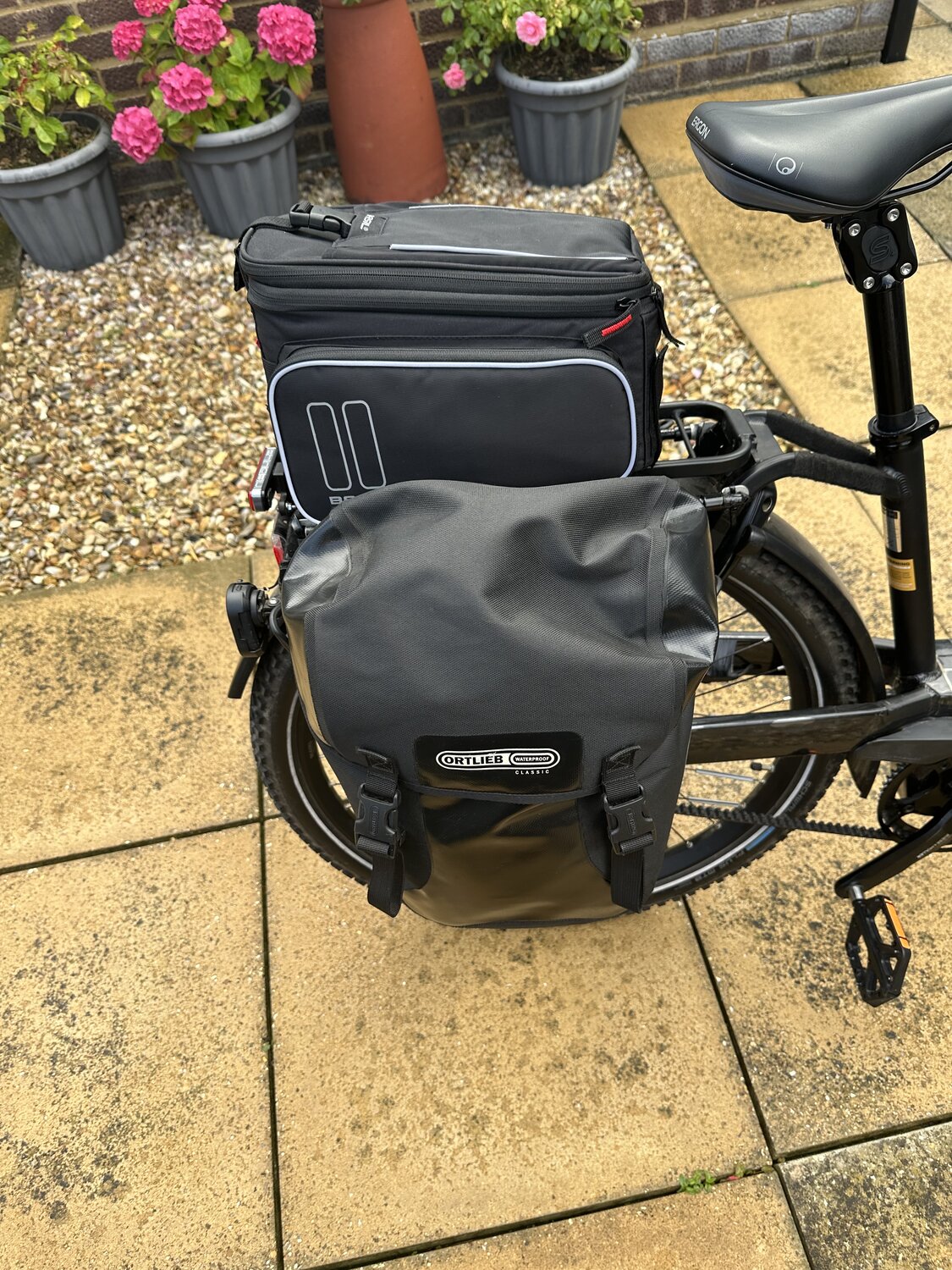

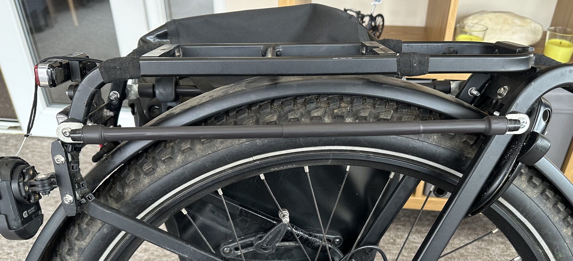

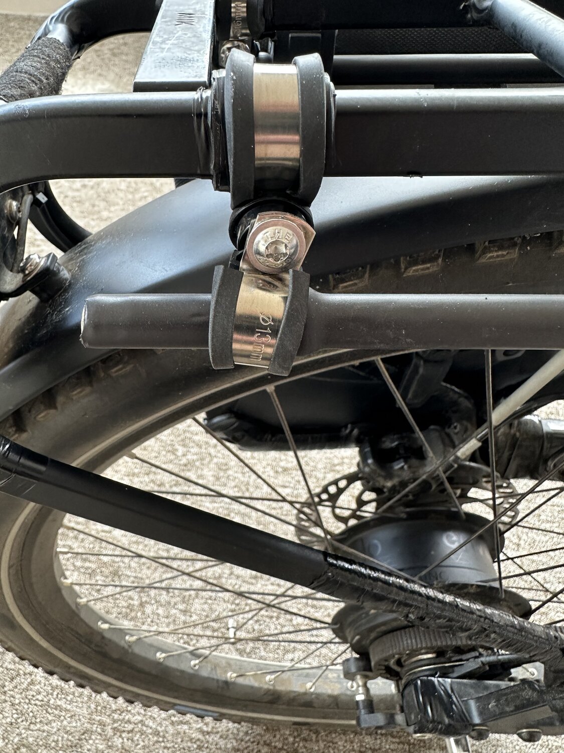

As I’m happy with the position of the pannier rail it has now been fixed in the final position.
A couple of stainless steel bolts through the rack frame. A couple of plastic spacers and some black heat shrink over the stainless steel tube. Now looking neat and tidy as well as rigid and strong.

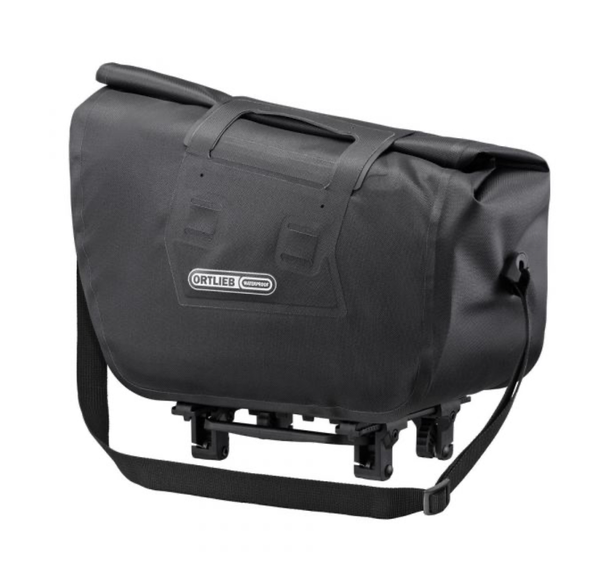

I have the Ortlieb trunk bag and find it first class.
It’s easy to adjust, grips the rack very securely and is easy to release.
it’s simply the best trunk bag I’ve had (and I’ve had many!)

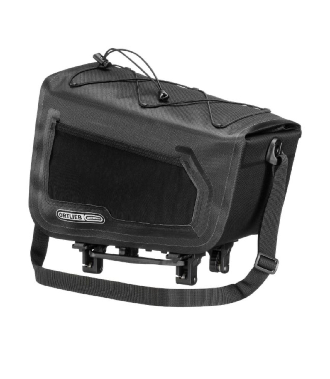

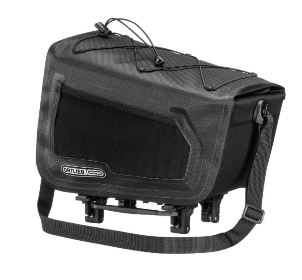

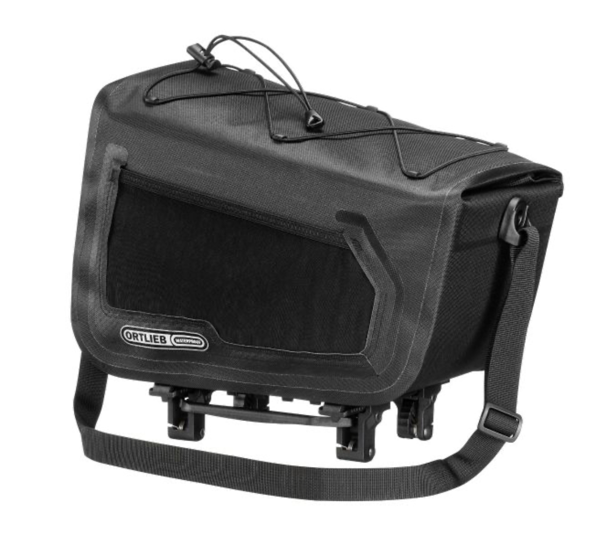

I’m making a change to the trunk bag.
Going to sell the Basil Sport Design, although it fits perfectly on the rack, the actual bag moves and bangs against the rack itself. On bumpy tracks this is quite irritating.
The Basil bag is now on eBay and I’ve ordered an Ortlieb E-Trunk bag.
This stands higher on the rack, so there should be no noise.
I’ll report back once received and used on the bike.
DG…

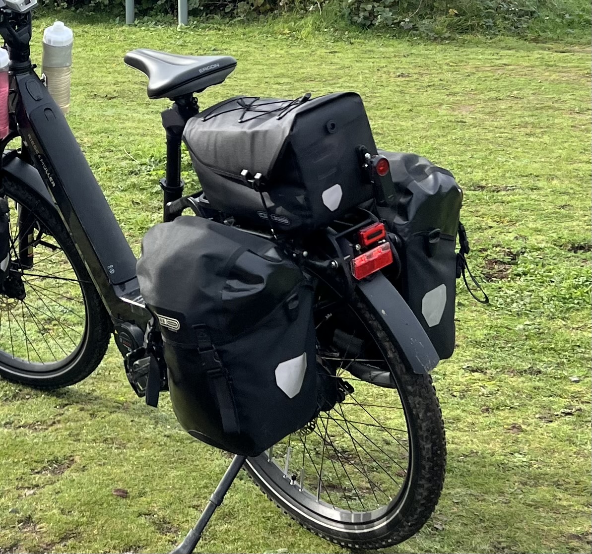

Update;
I’ve been using the Ortlieb E-Trunk Bag a while now and can report that it is very good.
Positives;
  • It fits solidly on the rack and doesn’t move
  • Build quality is excellent
  • It’s works well with the Ortlieb panniers with no interference
  • It fits better than the Basil Sport Design Trunk Bag. Being further away from the actual rack, it is quieter as it is not banging against the rack on bumpy trails
  • The elastic is good for holding maps
  • Fitted the Garmin Varia Radar to the water bottle bracket mount
Negatives;
  • Being a large storage area, had to add some foam inside to stop some items moving and rattling
  • On bumpy trails the magnetic clip could come undone and flap. Stopped this by using a piece of elastic to keep it shut. Never happened since.
Overall, very pleased with it.
