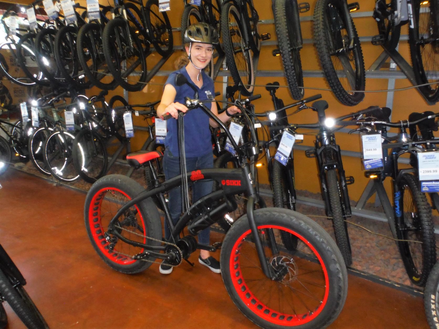

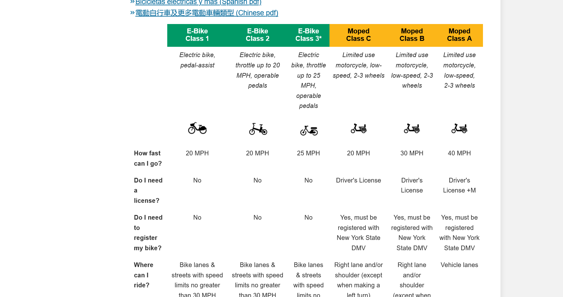

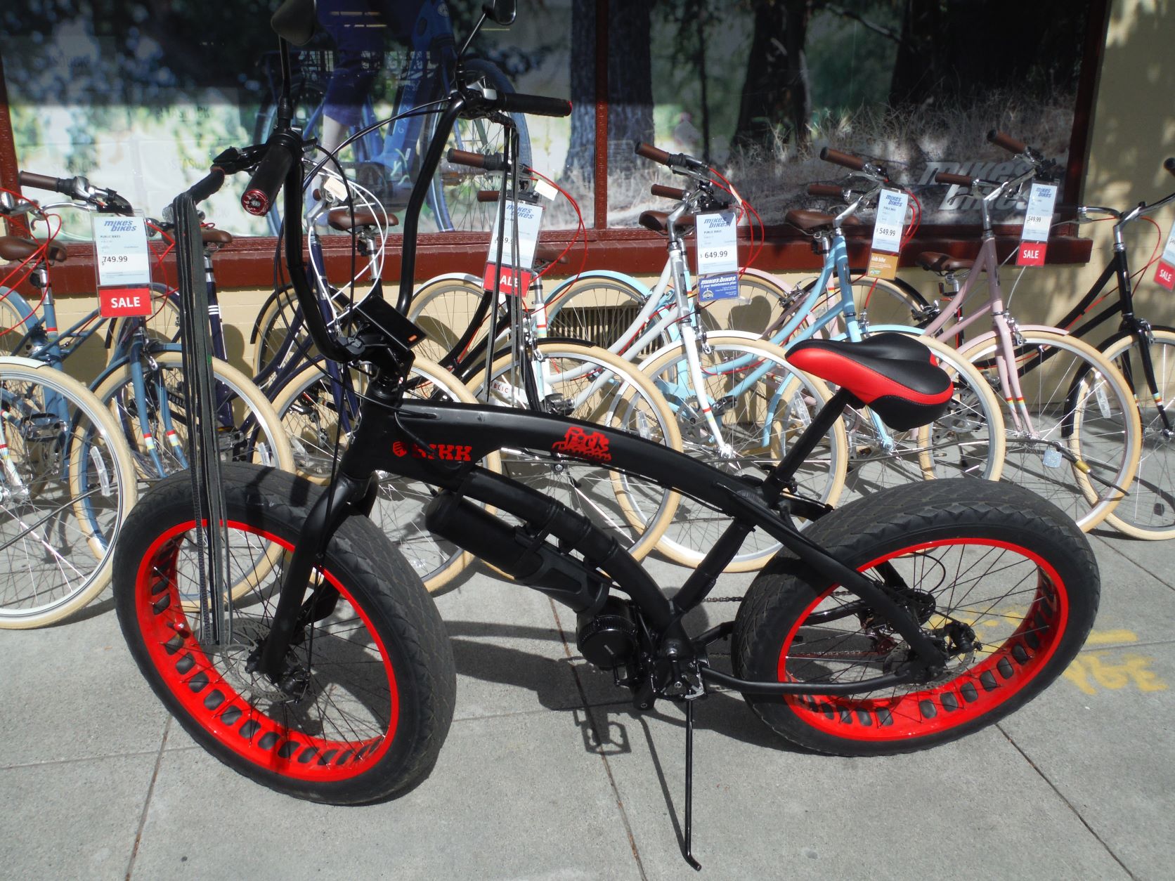

@Amari5522, Straight up, Do you want another ticket? Bikes with handlebar throttles are Class 2. By law Class 2 bikes in the US are limited to 20Mph. If they go any faster than that they are legally unlawful motorcycles. Unlawful motorcycles are not allowed on streets, bike lanes, or paths. You might be able to get away with it until an accident like hitting someone's dog while they are listening to their earbuds and while looking down at their phone. That is why is it accidental. If they walk into you and you have an unlawful motorcycle, you are at fault and will talk to the judge and jury. Or a cop can clock you while you are not even pretending to pedal. All that said, what you want is simple to find. Get a decent bike with good tires and brakes that is sturdy and fits well. Have someone handy and local or DYI a Bafang 750W BBS02 with a second battery. @mikeschn is correct about 'ghost pedaling'. These motors are at the legal limit for power. One watt more and they are motorcycles. Ghost pedaling is simply pretending to move the pedals slowly without applying any work and you go very fast. It is legal and if you do not have a throttle on the handlebar you can do 25-28 Mph depending on a number of factors. This is where what you are asking for intersects with what is possible. This can be achieved with premium batteries for much less than $5k. Here is what one can look like: 1) Solid Bike, Good Brakes, 2) BBS02 Motor, 3) Second Premium Battery. Oh and here is the dog you might hit.

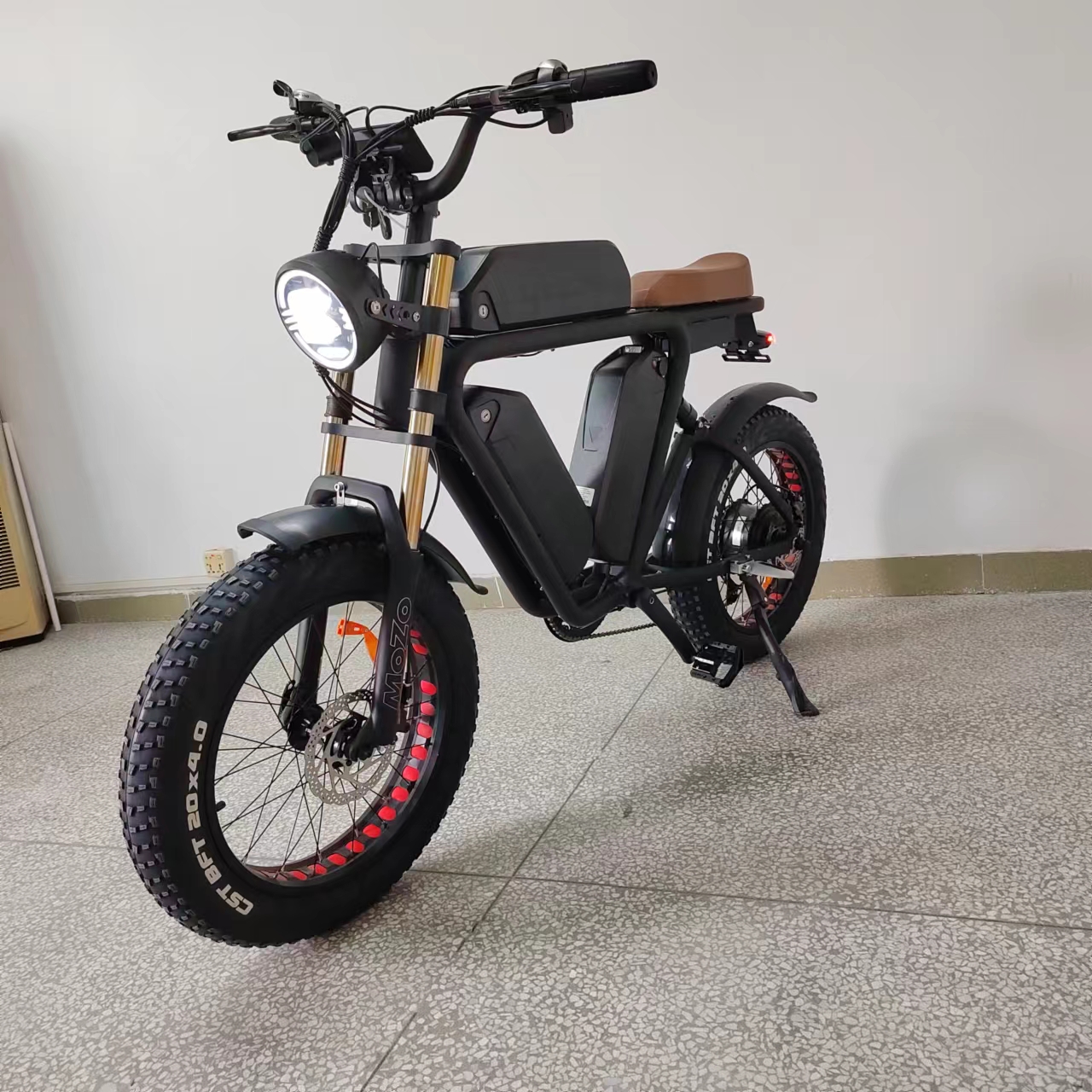

Electric e bike 1000w 16ah*3 lithium batteries full suspension hydraulic brake long range 20 bike electric 55kmh fast Fat ebike

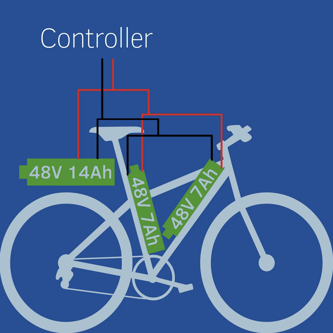

Here's another possible battery arrangement!
Having the batteries attached to the bike isn't the only option. One could also have spare battery or 2 in panniers for long journeys and only one battery in use at a time, just switch them out as they get low. For going to a local store, panniers could be empty. There are probably other arrangements like 2 x 48v 15ah batteries built in. I'd only be looking at bikes with tires between 2.1-2.5 in for city riding. You could have 4 batteries and a full set of panniers.
