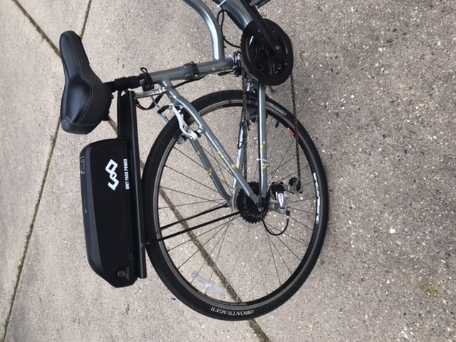

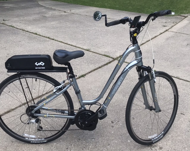

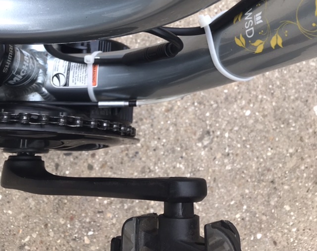

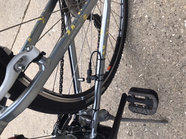

Thanks for the reply! I would like to have the 5 modes in proportionately greater steps with softer starts, if that is possible. This DPC18 display has 5 modes in both Ecco and Sport. I purchased the kit thru Amazon marketplace from Greenergia. At the present time, my wife is pretty much staying in 4th gear with a 48 tooth Bafang chain ring. I made a coupler for the rear derailleur cable housing so that I could use the existing cable by adding a piece of cable housing bypassing the cable eyelets on the frame. I had to move the cable to the top side of the bottom bracket, ( not enough clearance between the mid-mount motor & the bottom bracket). I mounted the speed sensor magnet on the opposite side spoke from the sensor, (seemed like the best place). She did not want the battery occupying her step-thru, so I made up a rear rack from some metal that I had on hand. She still gets some battery bounce / vibration, depending on the road. Still need to clean & finish it up. Kind of in an R & D mode right now. Any and all comments and criticisms are appreciated.

I HIGHLY RECOMMEND dropping to a 42T. There’s no good reason for a 48T and it can add additional stress. If you don’t want to spend the bucks on a “bling ring” like Lekkie a steel Bafang ring is pretty inexpensive. @Gionnirocket is a member and a good source for programming ideas. We sold HUNDREDS of 42tvand it’s also what I’ve run since 2014. I’m basing my opinion on literally thousands of e-mail and phone support over 7 years. Unfortunately I have no clue as to how your reseller programs. You’ll need a program cable and use the links I provided. Take screenshot of your settings and those of here with BBSxx series of motors will help. There are also n mn any web pages addressing programming. It can be a big overwhelming just don’t experiment without some clear reasons and reliable support.

The Bafang is fine. The Lekkie are lighter and better looking and may keep the chain in place better. It’s probably more of a budget issue. I’m running the cheaper Bafang since 2014. I have a Lekkie 42T in my parts box. The shop I worked with sold. But I think the new owner is good about supporting customers. California eBike.
Nice looking build! Great job!
Thanks! I have another kit coming so that I can keep up with my wife. She hits the hills and before I know it she is 2 blocks ahead of me! Just have to decide whether to put the kit on my mountain bike or my road bike. It is looking more and more like I will be putting it on the mountain bike.
