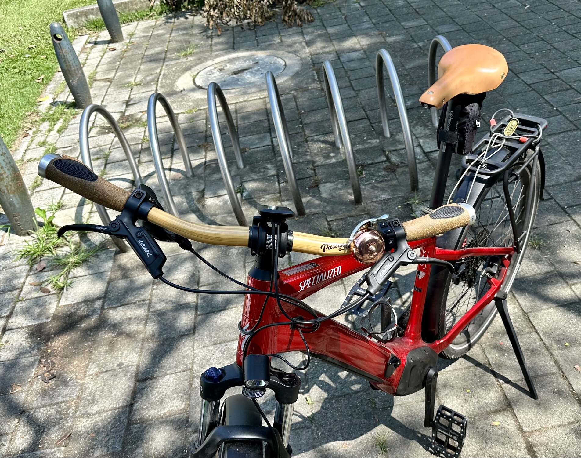

Well, awhile back I posted that I had would rather have a Turbo Vado SL. Thats still true, but the Turbo Vado SL is not available in Colombia. So I am doing my best to enjoy all the fine qualities of my Turbo Vado and change a few things around to be more to my liking. I have always ridden road bikes in the past and active suspension components like suspension seatposts, stems and forks are outside of my experience and my comfort zone.
I ride mostly in the city…however Medellin has more than its share of nasty bumpy broken surfaces, potholes, ruts, and gravel backstreets.

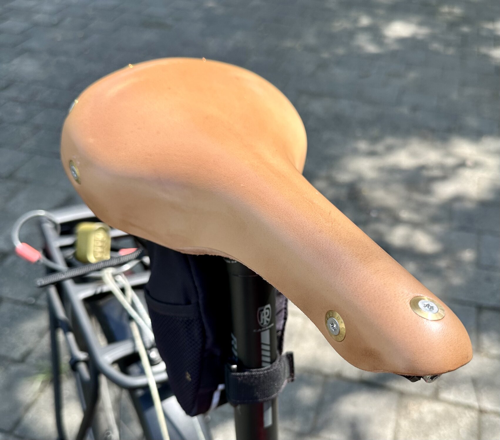

so I have replaced the stock seatpost and saddle with a Ritchey carbon Seapost and a Gilles Berthoud leather saddle with titanium rails (I have lusted after that saddle for well over a decade, and at my age that is pushing it!)

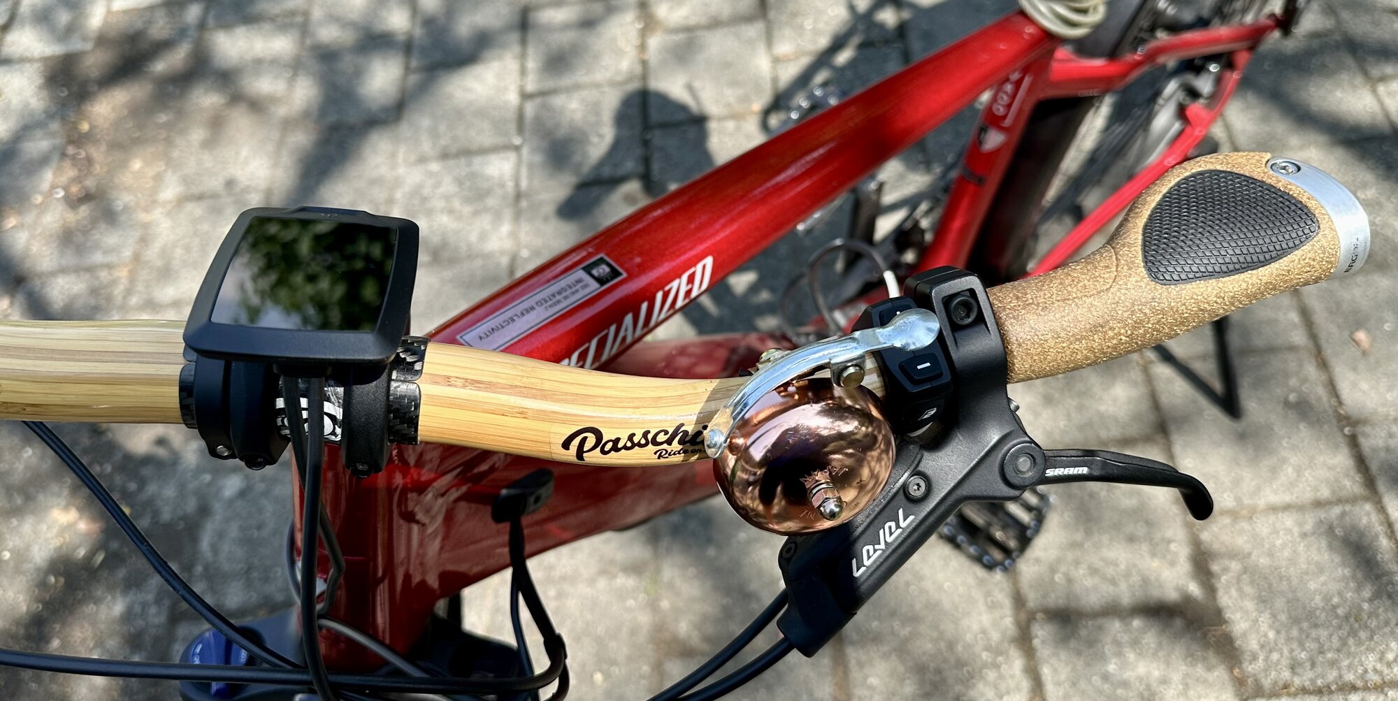

I also replaced the stock bars and grips with Passchier laminated bamboo bars ( I ran this pair on my old road bike for a year and I LOVE the soft ride they give) and Ergon cork grips. now I the front end is much more to my liking.
the lovely Japanese made Crane bell is roughly 10X louder than the “bell” that comes with the Turbo Vado stock.
Next will be some 650x48 Rene Herse semi-slick tires and lighter tubes.
now if I could just replace that suspension fork with a rigid carbon fork🤔

Now that I have a couple hundred K’s on my ebike I have to say I like it much better. The handlebars are a couple inches narrower which is handy when maneuvering in traffic, they also have a nice bit of give to them for soaking up bumps.
And I really like the Ritchey carbon seatpost. I just never was comfortable with the suspension post. Now I feel much more natural riding.
now about the carbon rim idea……..
I want to get those handlebars, too! They look so comfy. Are those the 760mm length ones?
They are the “Gump” model. I hope the thief who stole my bike 2 months ago is enjoying them. I really like them!

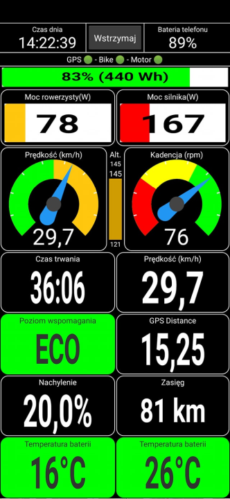

The good thing is you can still use the BLEvo app on it (instead of the pathetic Specialized App).
The app is totally configurable and international. The fields here read:
  • Time of Day
  • Pause
  • Phone battery %
  • % and Wh of battery remaining
  • Rider's Power
  • Motor Power (electrical)
  • Speed (kph or mph)
  • Cadence
  • Ride net duration
  • Current speed
  • Assistance Level
  • Distance ridden according to GPS
  • Climb grade % (do not trust it!)
  • Remaining Range
  • Battery Temperature
  • Motor Temperature
It is 16 data fields! By comparison, a Wahoo ELEMNT Roam can only display 11 data fields on its Workout data page. Be aware Vado SL works with both Garmin Edge or Wahoo ELEMNT (Bolt or Wahoo) but only Wahoo and BLEvo can understand the Range Extender :)
