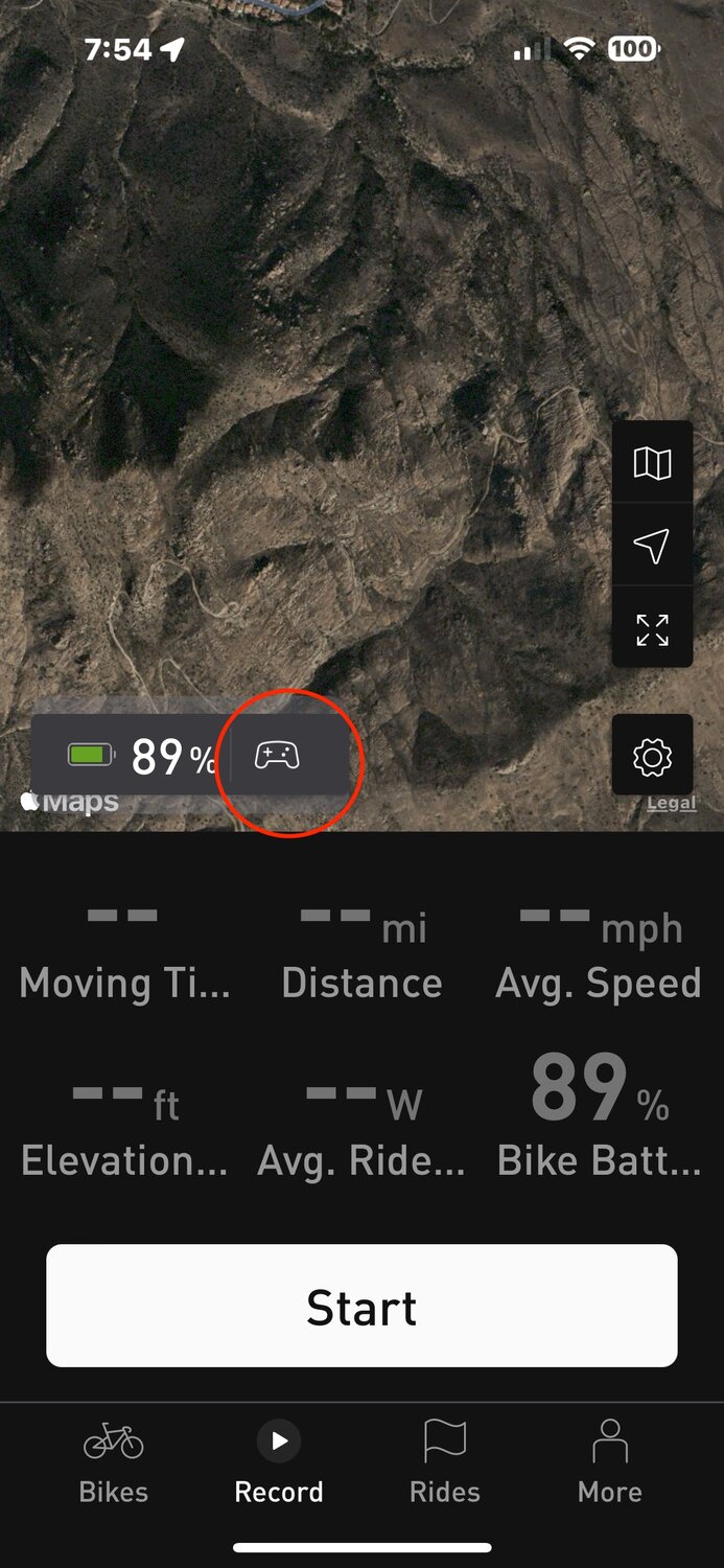

Hello all, there is a new version announcing Smart Control but I can’t find the functionality, any idea?
Version 1.6.0
We've listened, Riders, and are excited to announce that Smart Control has been added to the Specialized app in this latest release!
I downloaded the new app (updated from APP Store on Apple iPhone to version 1.6.0 build 926 and I also do not see it. Anyone know how to see it, view it, enable it, etc.?

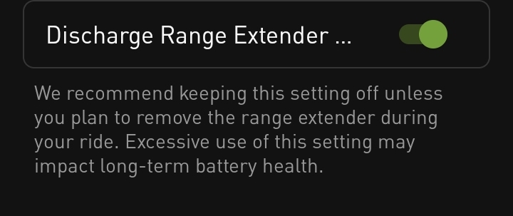

No doubt the Specialized App becomes better and better. It is interesting to read some remarks in the new app such as this one:
The remark about "unless you removing the Range Extender during your ride" is really interesting! The typical scenario of riding with this option on and both the main battery and the RE is that in case the RE becomes discharged below 20%, the main battery starts helping with its own charge (especially in high assistance modes). Now, how should it look in theory?
In theory, the Range Extender should get discharged down to 5%, and then it should be cut off from the system (reporting 0% RE charge, which is not the fact). However, there are errors and glitches in the SL system despite firmware updates. While the scenario might work as described with a specific RE, another RE might cut off even at its 10% charge!
Disconnecting a Range Extender earlier might be a good idea. Depending on my specific ride, I'm disconnecting the RE at 20 or 10% and avoid going below that, especially as the assistance becomes very weak below RE 10%. It looks Specialized has observed similar phenomena, and thinks riding in the "Discharge Range Extender First" mode would require disconnecting the extra battery at some ride stage?
