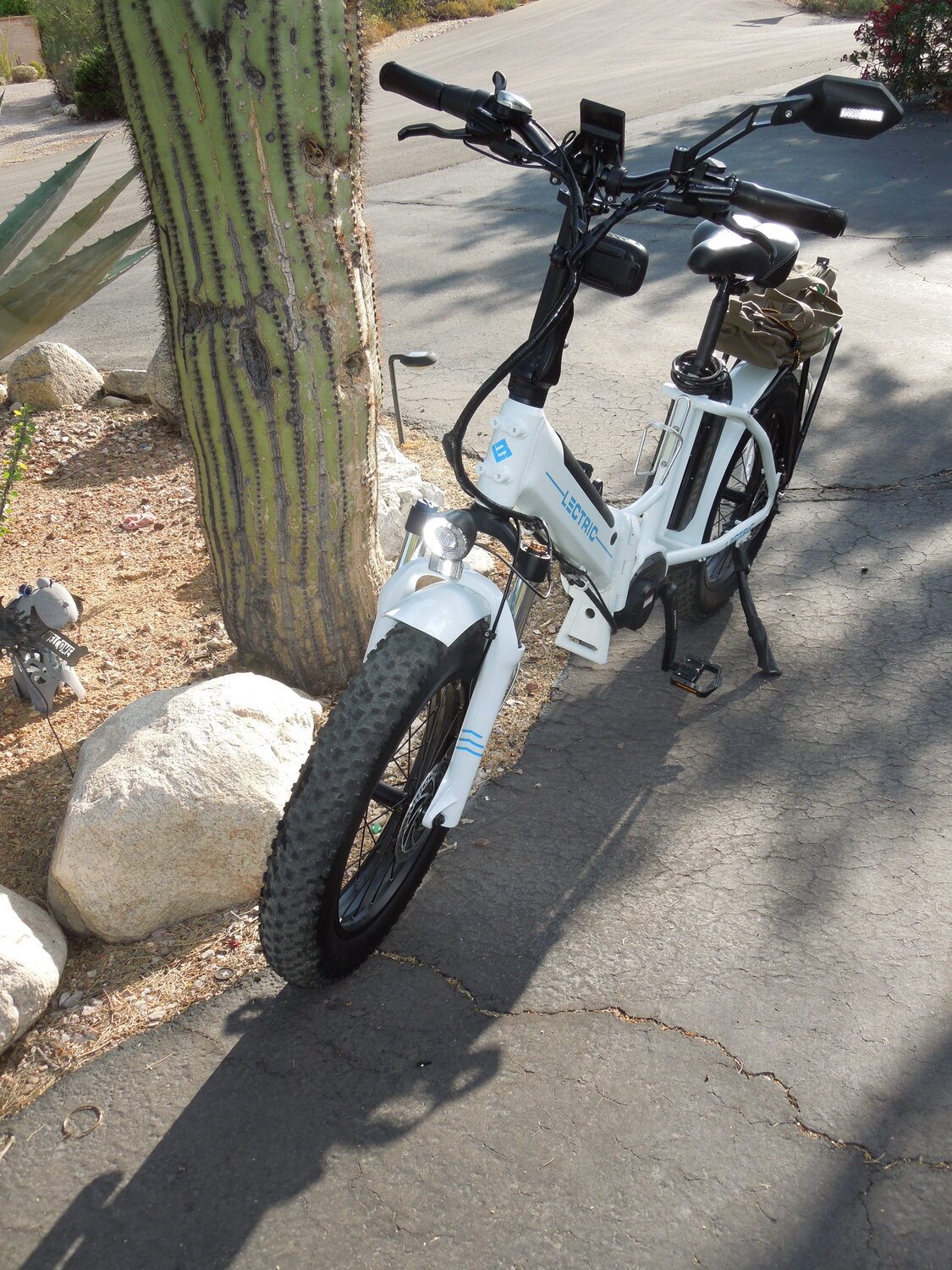

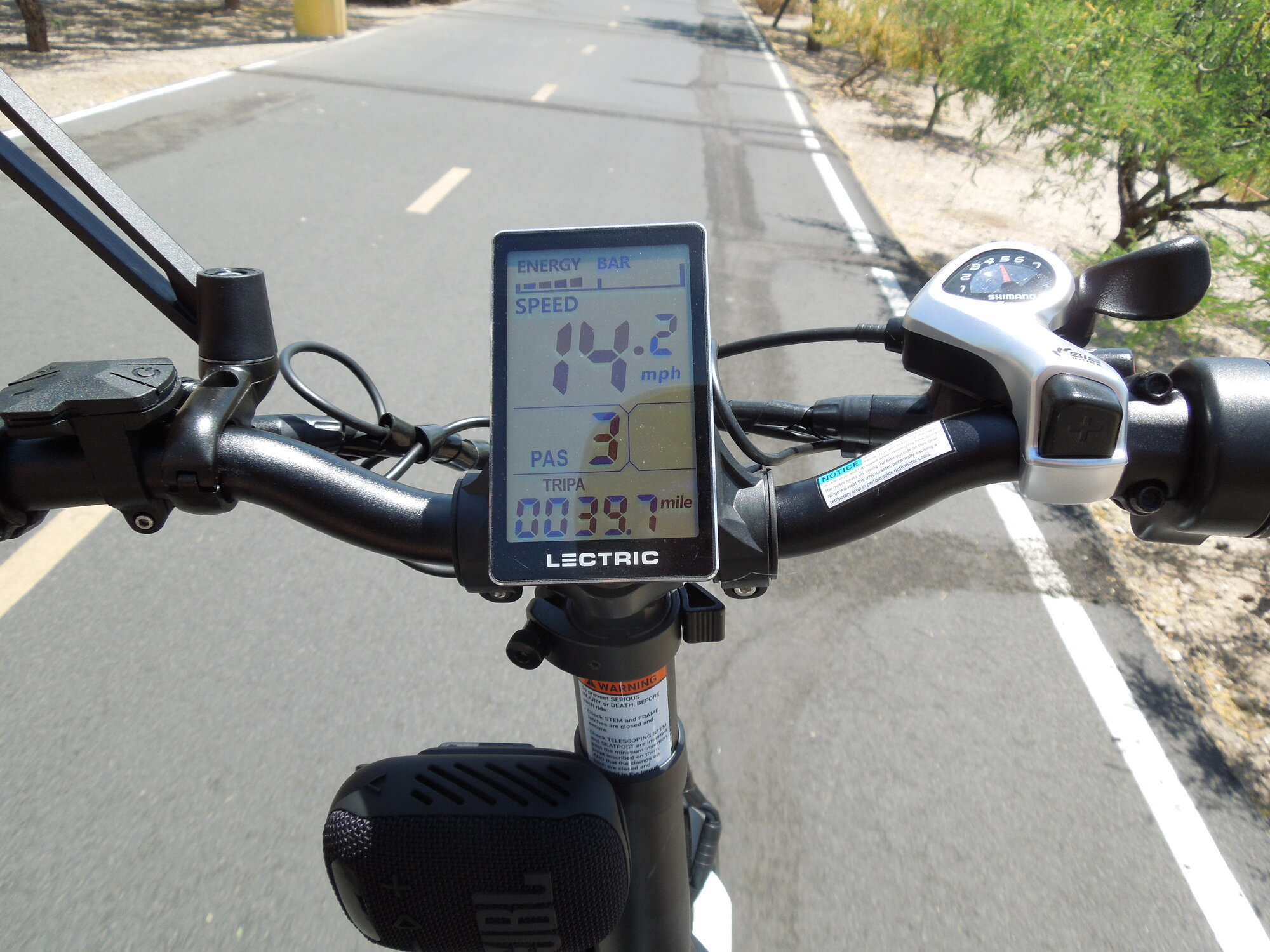

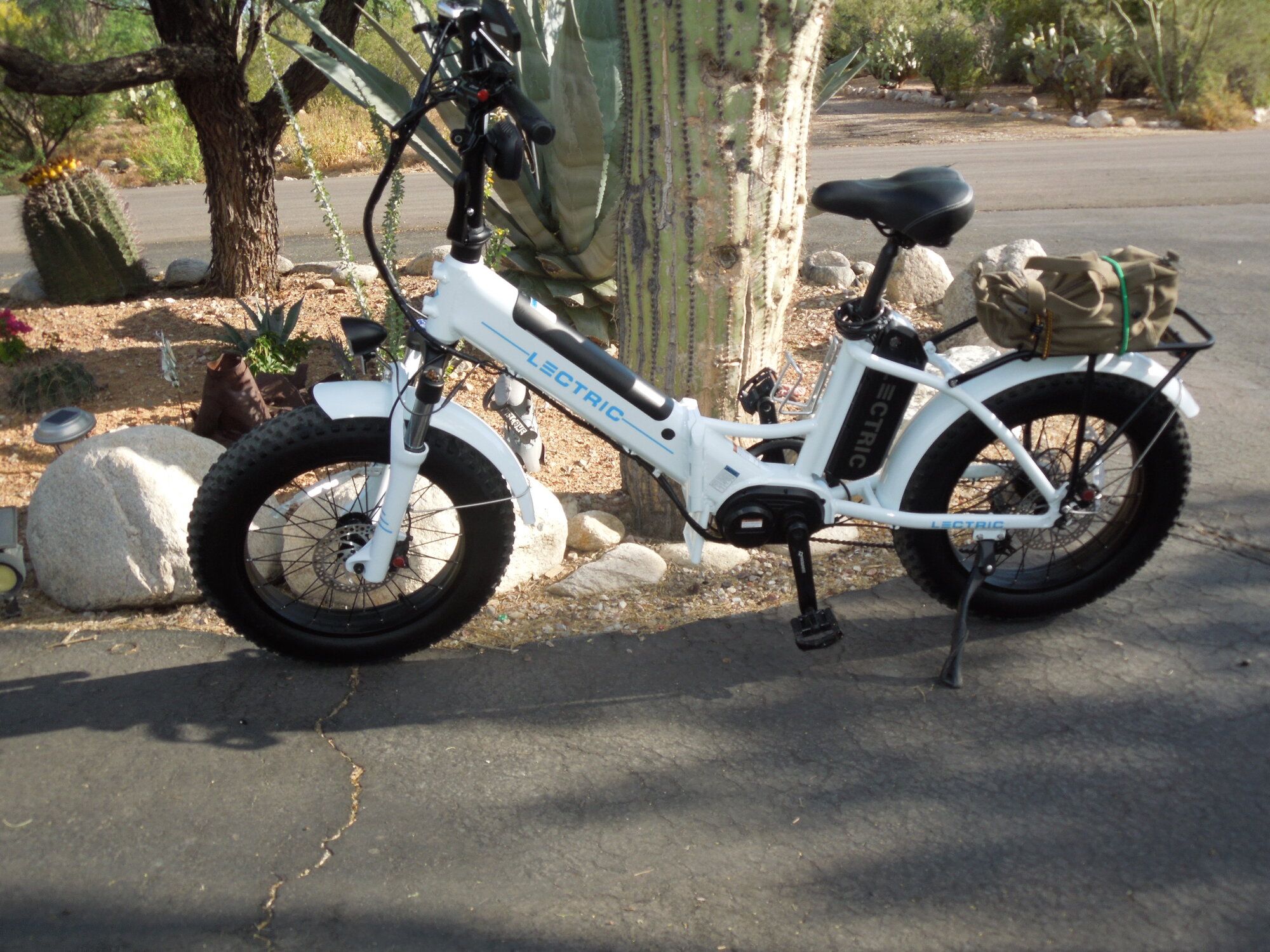

An update on the XPremium. The PAS function has been giving me trouble for the last week. It will not engage initially on the ride and sometimes takes a 1/2 mile to engage. The throttle acceleration without peddling works fine. I tried to jiggle the wires coming out of the display and it does not seem to help. I saw on the forum where another person contacted Lectric and they replaced the display and it cleared things up. I contacted Lectric Customer Service this morning and described my issue. Elizabeth was very helpful and Lectric is sending me out an new display. I will update when I get it. I did a little custom painted on my XPremium....

That PAS issue seems to be common with Lectric bikes. I have a few friends who ride them and they primarily use the throttle since they tell me the pedal assist is rather unreliable. Please post again if the display replacement resolved this for you.
I received the new display from Lectric very quickly and I installed it on my bike. Things are currently working as they should. I think Lectic needs to take a step back a bit and work on their quality so the bike is rock solid from the day it is unpacked. If I get another e-bike I will research all brands and probably switch to another brand. I looked at Juiced and they look good. Anyone have one of these bikes and how is the quality?

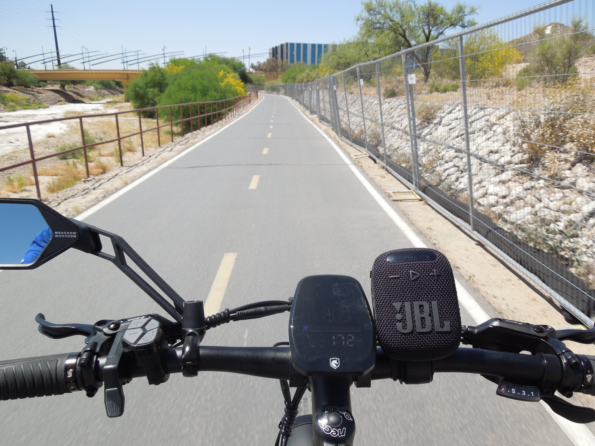

41+ Miles today. Did 42 Miles on it today. Meter still says 47% battery Pas 3 Gear 5 is what use. Picked this up on Tucson FB marketplace for 700 bucks for the GF the other day. Previous Female Owner said it was too heavy for her. 20 miles on it. Still had the tags on it! Second E-Bike. Seems to work great. Unlocked to stage 3 had it to 29+. Figured 700.00 was good seen used regular single batteries going for the same or more. Other bike is a Hovsco Alpha with almost 500 miles on it. The XPremium comes with two 499.2Wh. batteries and a 500W (800W Peak) motor. The Alpha has a 750W motor with a 960Wh high- 48V 20Ah capacity integrated battery.
