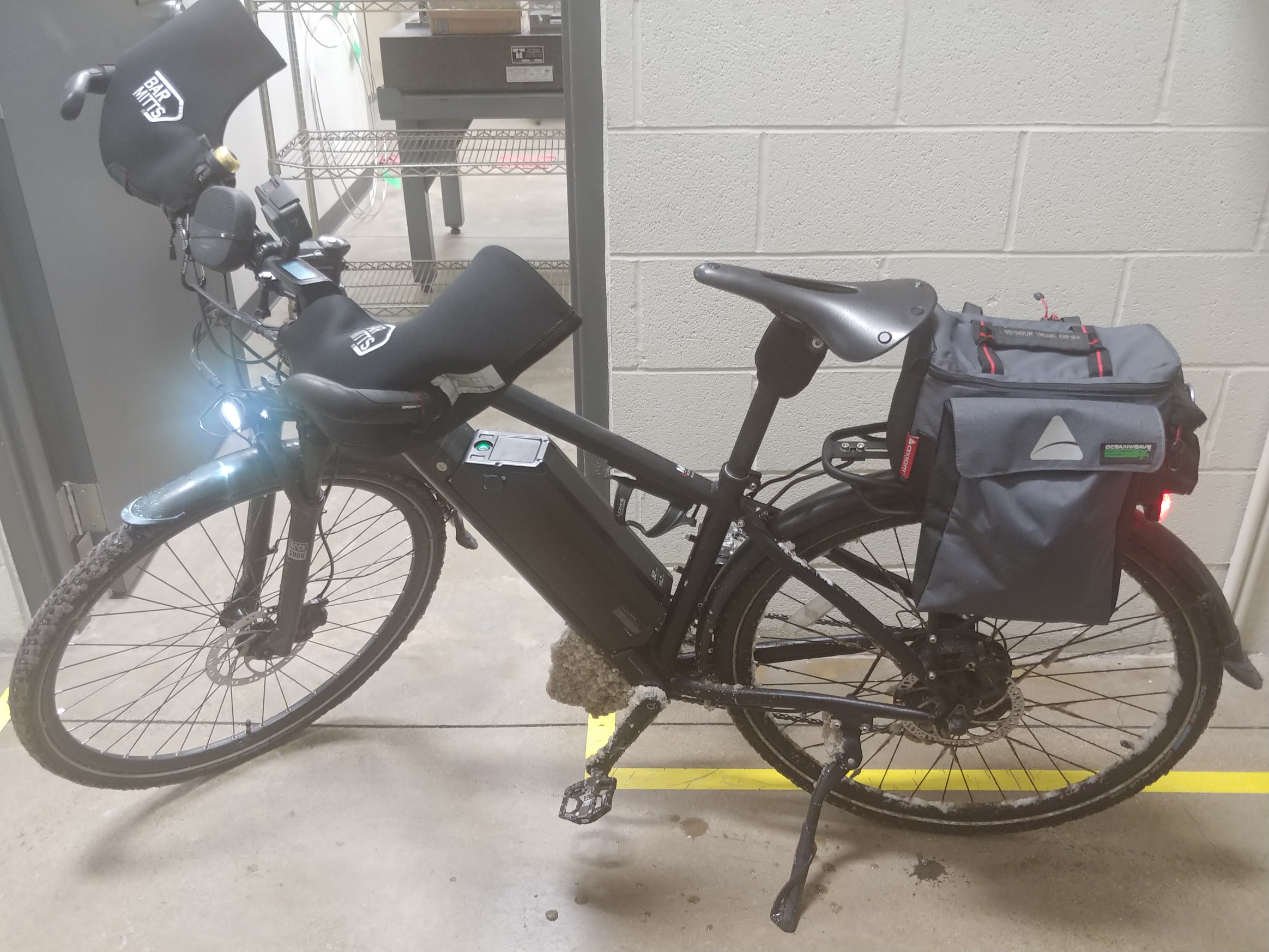

I finally received the Busch & Müller IQX-E headlight from a German bike store after placing the order about a month ago. Installation was easy. It was just a matter of connecting the leads of the headlight to the Y-adapter Higo connector I purchased from a Juiced Forum member. I made sure the power was off before making the lead connections because I did not want to risk shorting out the controller (thanks Youth!). The headlight has reverse polarity protection because I had reversed the polarity initially and the light did not work. After I corrected the lead wires, it worked. I now have the stock headlight and the B&M on at the same time. The power draw still reads as 6 Watts with both headlights on. The B&M headlight has a nice beam cutoff as specified by German StVZO standards. It has a 150 Lux rating. To my eyes it appears to be about 600 lumens, however all those lumens are effectively utilized by the special lens design and not scattered producing glare like the stock headlight. I basically use the stock headlight aimed lower to illuminate the foreground. I raised the stock headlight mounting position with a DIY bracket because the annoying glare was reflecting light off the front fender. I also carry a 900 lumen torch as a back up just in case.

Yes, I used the Y splitter - I was using my eyes as measurement and both lights appeared to operate at full intensity. The controller draws 4 watts with the lights off but last night when I turned both lights on it only read 7 watts. During the daytime I guess the B&M headlight automatically dims so that could be why it dropped to 6 watts.

I didn’t shorten the cable, I coiled it around the handlebar and bunched it togther with the other cables.
