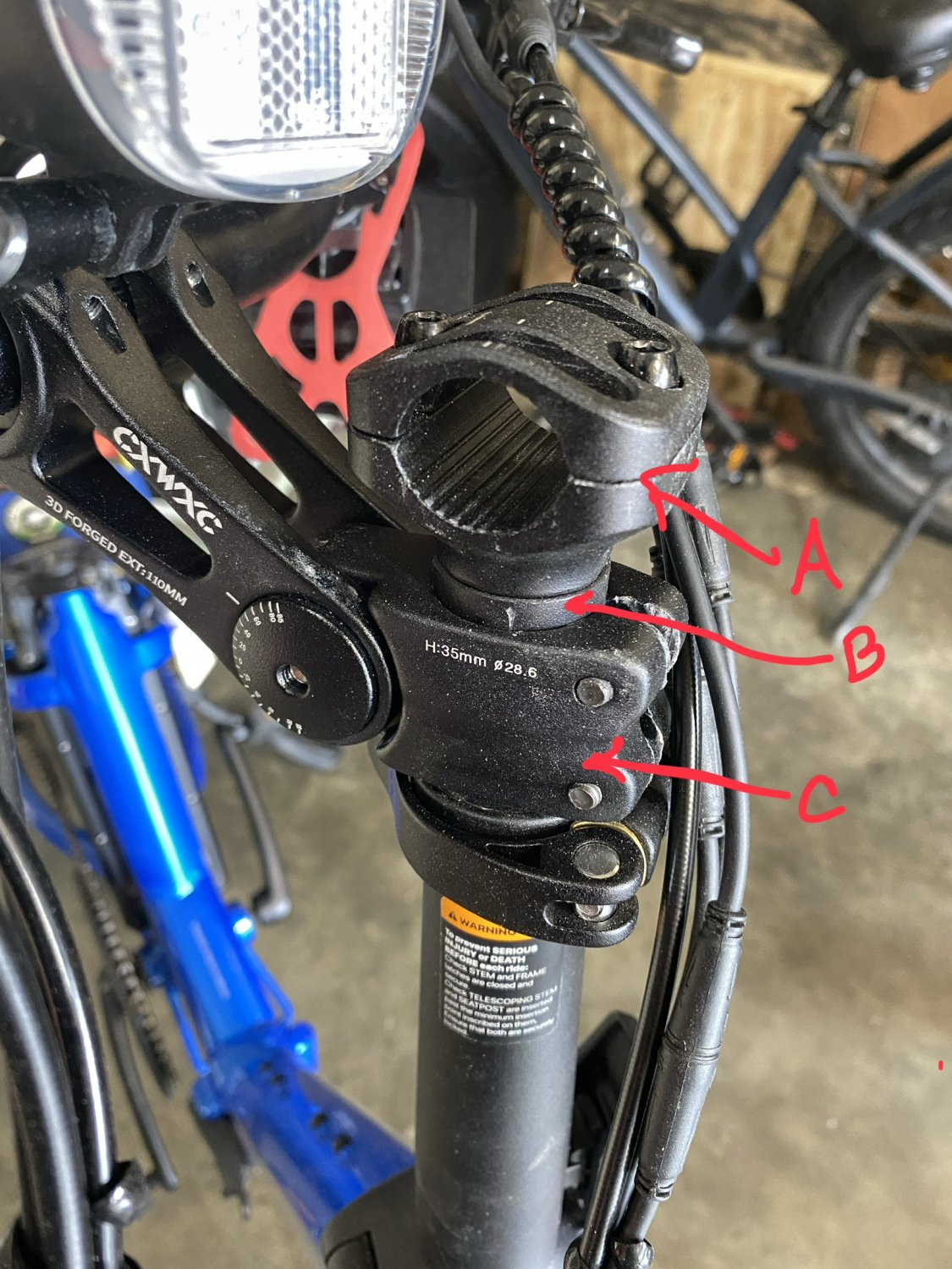

A is the factory handlebar bracket, it is permanently swaged into the stem B. I think when they did that, it swelled the stem slightly and that’s why i initially had trouble getting the extender bracket C to go all the way to the top.

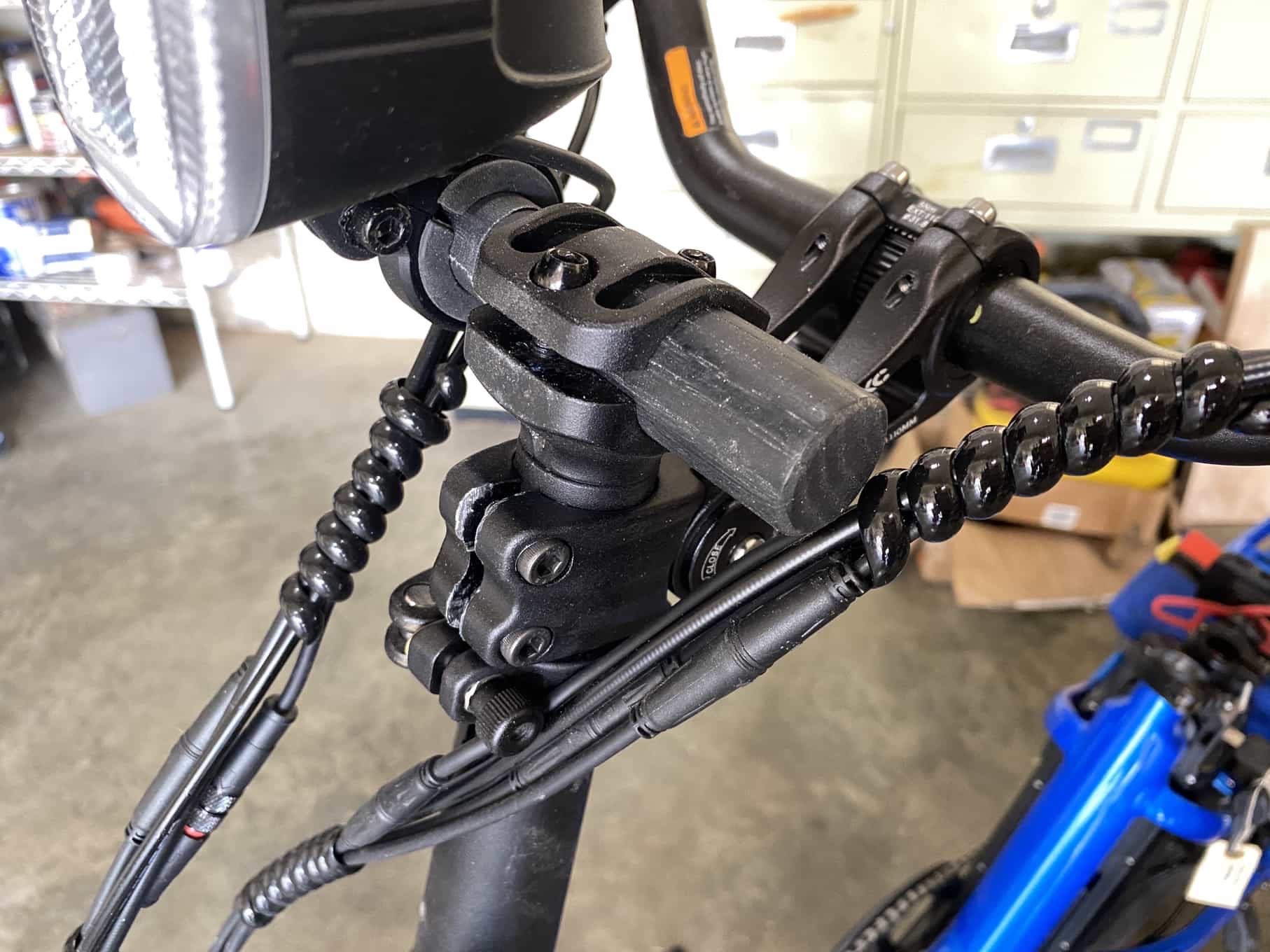

After I got all that sorted out, including using the aluminum spaces from post #16 i was left with the original bar bracket just sitting there doing nothing. So i cut a 5” scrap of 1” wood dowel, painted it black, and secured that into the original bracket, which let me relocate the headlight there and tree up some real estate on the handlebar. The handlebar is a little narrow because of the folding design, and this made a difference. Funny thing … even though the handlebar and bracket are marked 25,4 mm or 1” … the actual handlebar is only 7/8” so i had to skinny down the ends of the wood dowel to get the headlight bracket to fit .

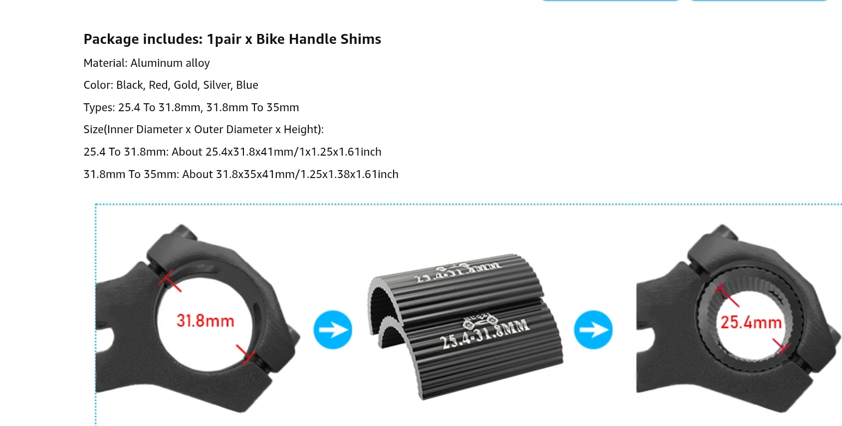

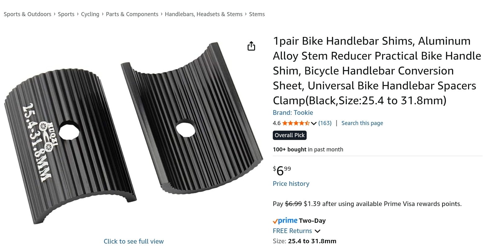

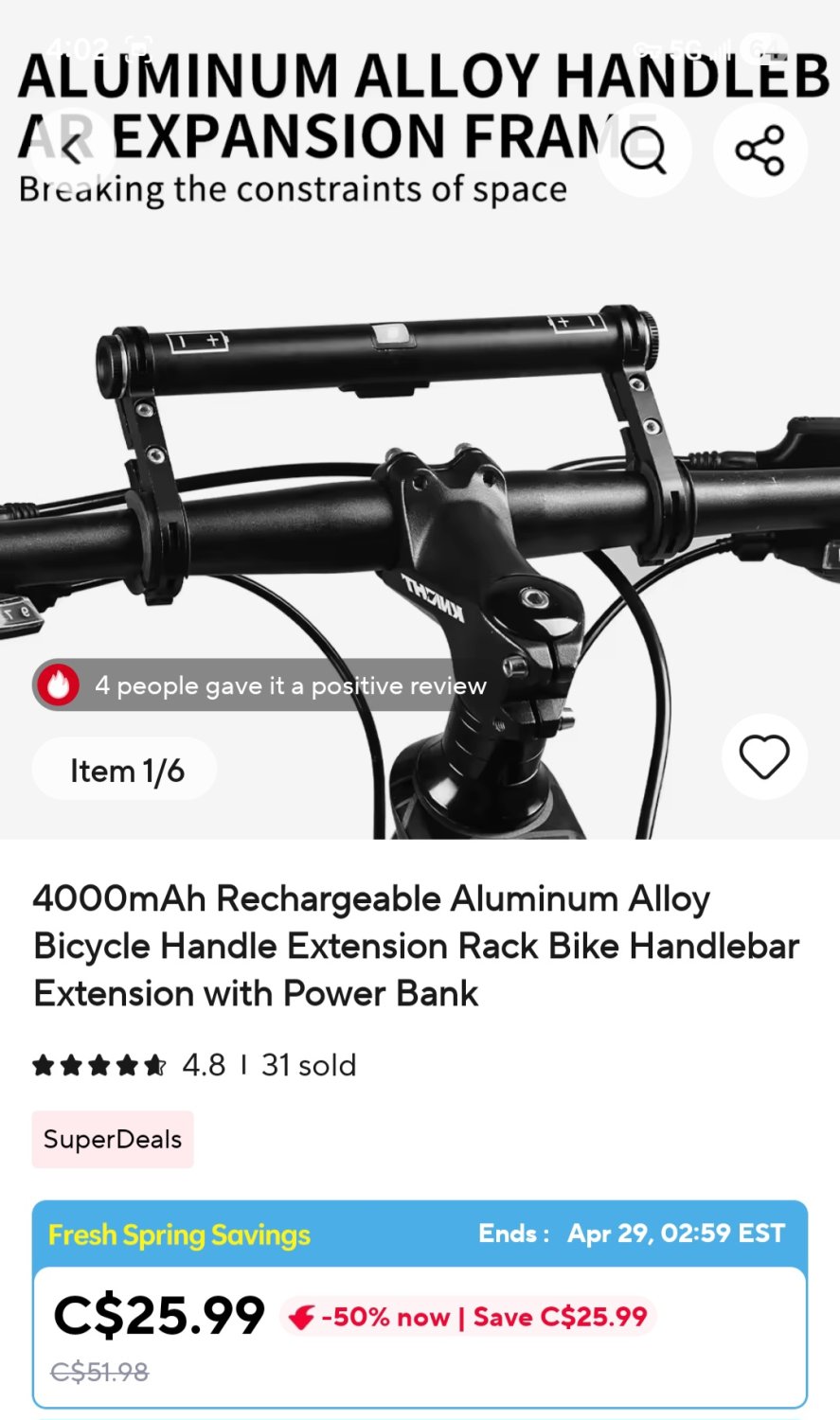

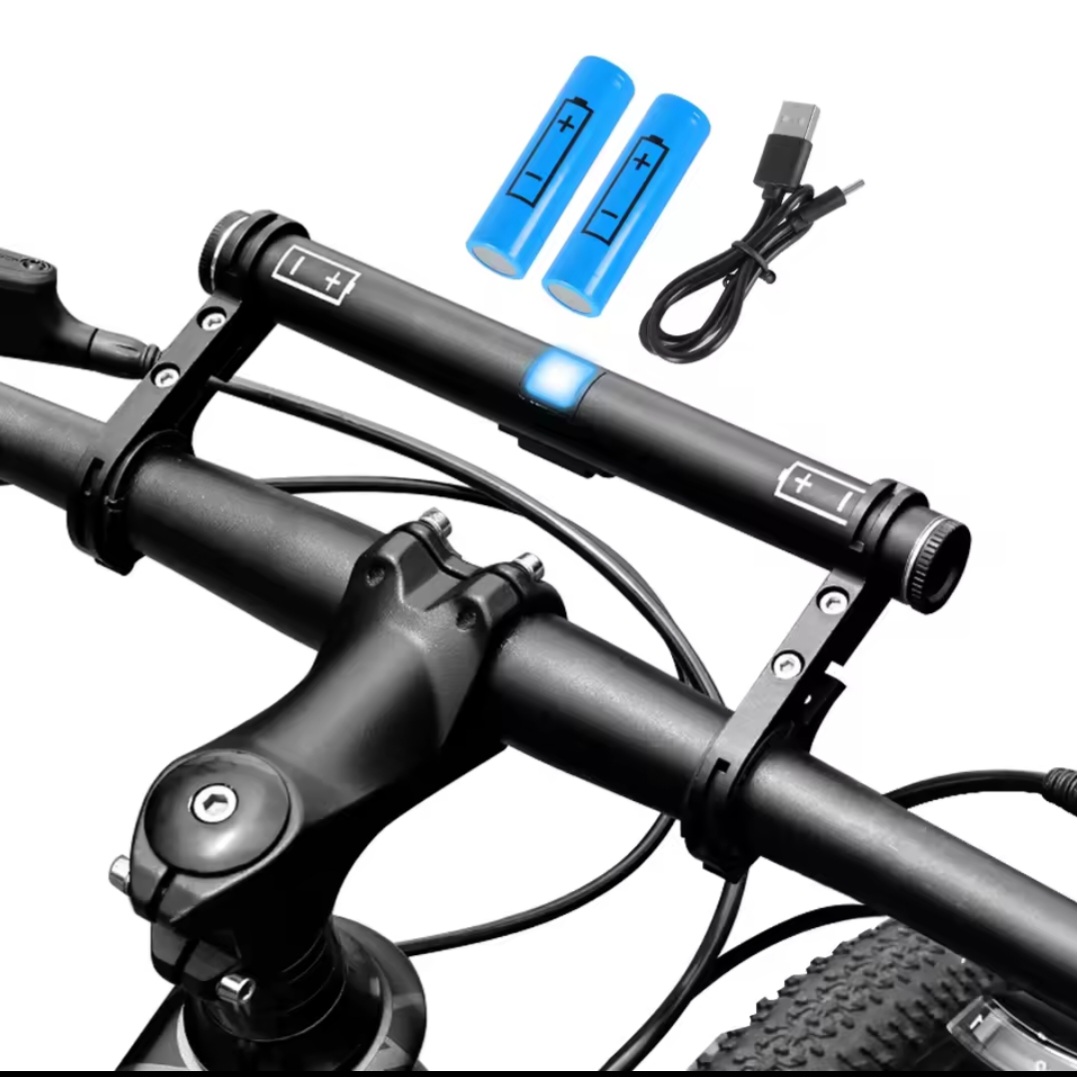

That’s $25 canuck money, lots more in real world money, my piece of wood dowel was free. Why spend money when it’s not necessary?
Actually you could use a piece of 3/4” dia sched 40 pvc pipe, the od is something like 1.05”.

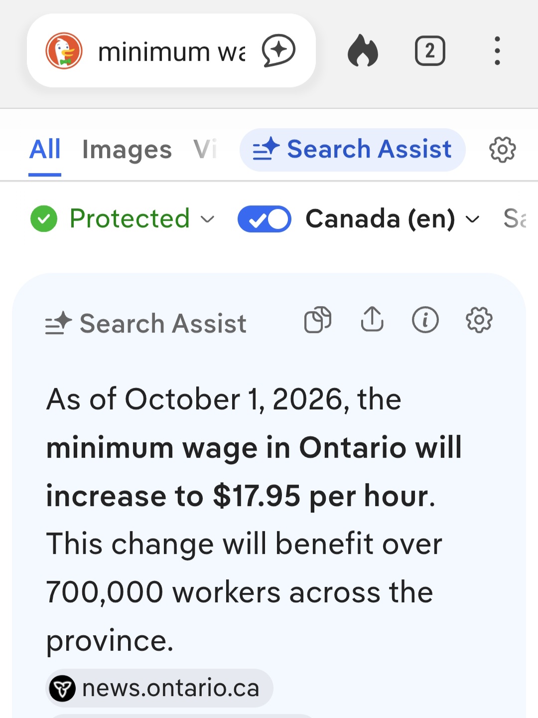

What is your time worth?
Minimum wage here in Ontario will be almost $18 an hour in a few months,..
Yeah, I've got plastic and aluminum tubes that I could use and many dozens of old lithium cells that I could use to stuff inside the tubes to make a rechargeable handlebar extension, but it's just cheaper and easier to buy one.
Especially if you're aware of the fact that there are rechargeable handlebar extensions.
