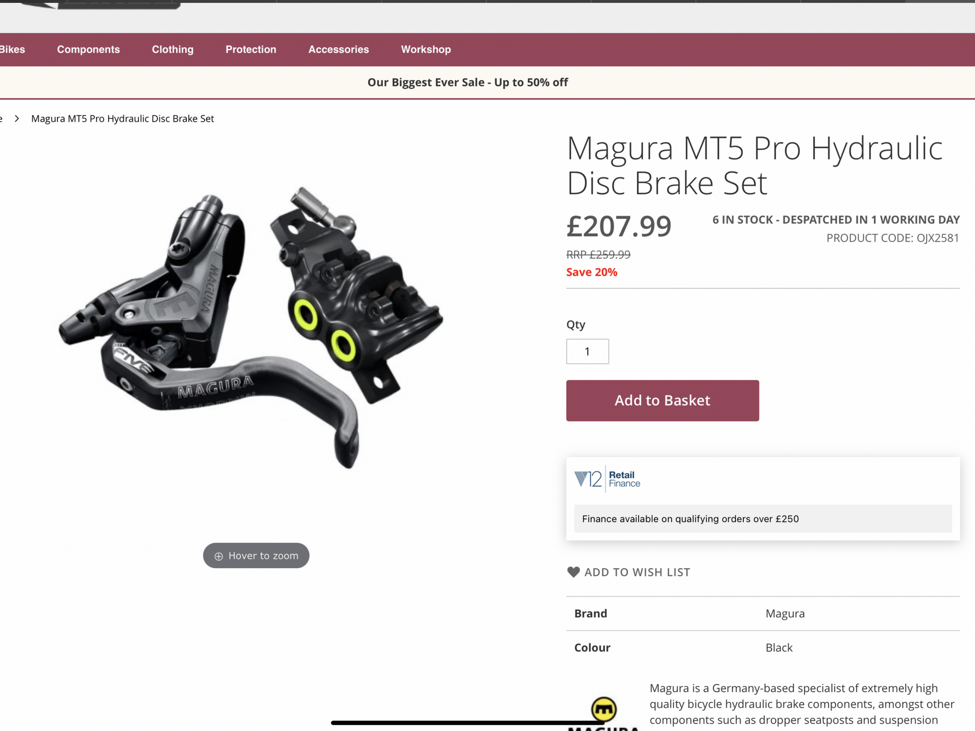

The MT5 pro have one finger levers. I think from the MT7’s.
The shop who are fitting them recommend the Hope V4’s. They say they are as good as Trickstuff brakes, which completely went over my head as I had never heard of them. I have no issue buying them if they’re worth the extra £200, but I can’t see any issue with the MT5 Pro.
The shop say they see bikes on a regular basis with broken MT5 levers but I’m guessing they’re the standard levers.

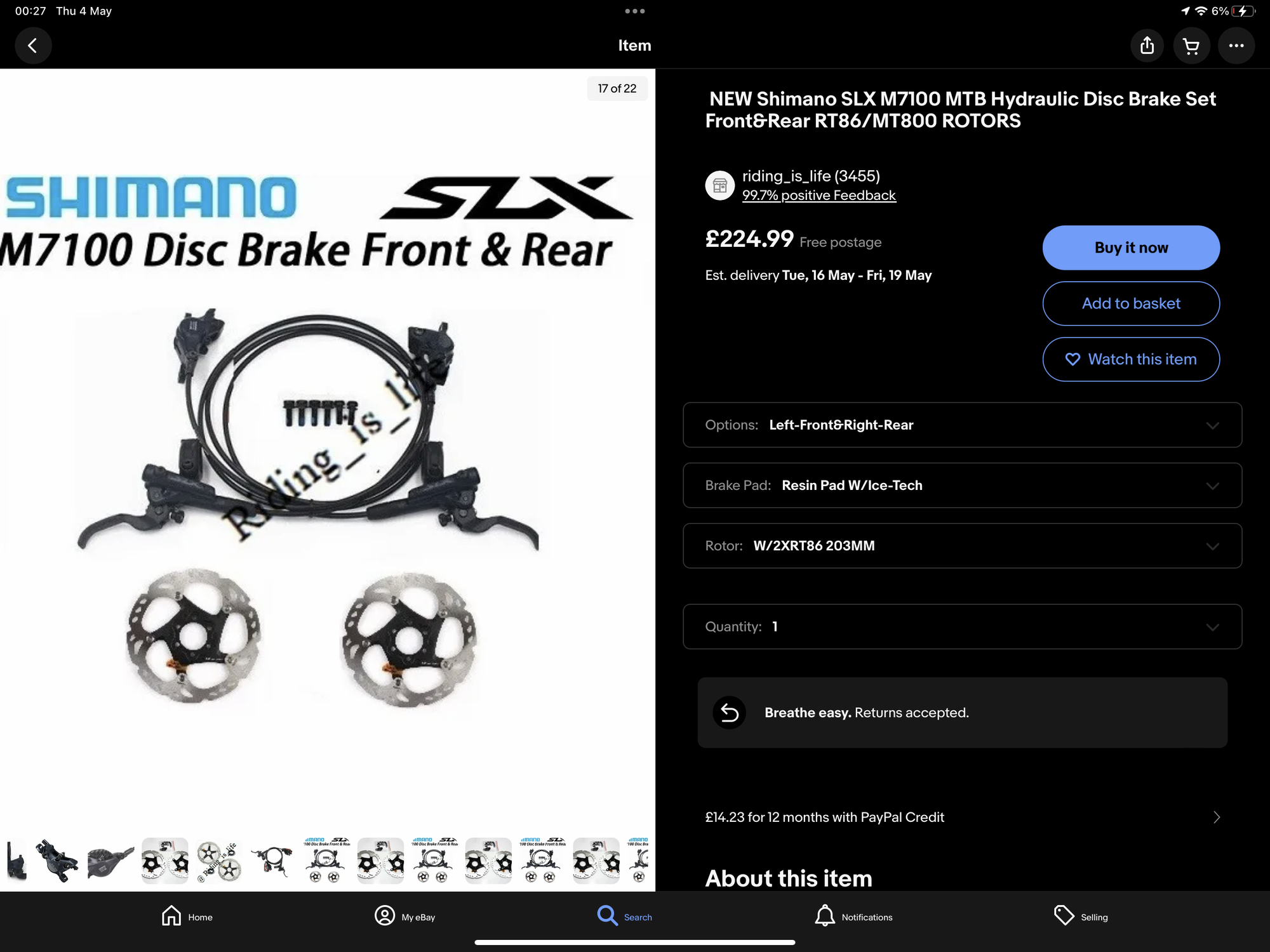

For cargo bike or hardcore MTBing 4pot Magura 5,7 or Shimano SLX M7120.
Light MTB or just general riding then 2pot Magura 5 or Shimano Deore M6100 or SLX M7100.
With Shimano 20 at end means 4 pot, which use different pads to 2pots.
SLX have thumbscrew for reach adjustment which can be done while riding, Deore need allen key. Braking performance is very similar. Bleeding is straight forward if you choose to do it your self, see youtube.
I run Shimano SLX 2pot and buy pads from Aliexpress for <USD10 pair. Most bike shops sell them. Hope pads maybe bit harder and more expensive to come by.

The shop say the hopes are expensive compared to the Maguras, but in their opinion are better value as they are as good as trickstuff.
I don’t mind spending on brakes. I got a good deal on my frame, fork and shock so the extra £200 on brakes isn’t so bad. If it was £120 vs £400 like I thought it was initially I would have gone with Magura.
Hope are a local company and make quality parts so I don’t mind buying them.

Shop came back with a price for V4 brake set, bars, stem, cranks, pedals and 29 wheels. £1500 plus fitting.
Review of the Hope V4 here:
BTW, the Shimano M7100's are 2 piston brakes, while the Hopes are 4 piston. Shimano does make a number of 4 piston brakes as well, including the M7120s. Review of those here:
Still cheaper than the Hope's, but not half the price. You might also consider the price of replacement pads - the 7120's are finned for heat reduction, so cost more than normal non-finned pads.
