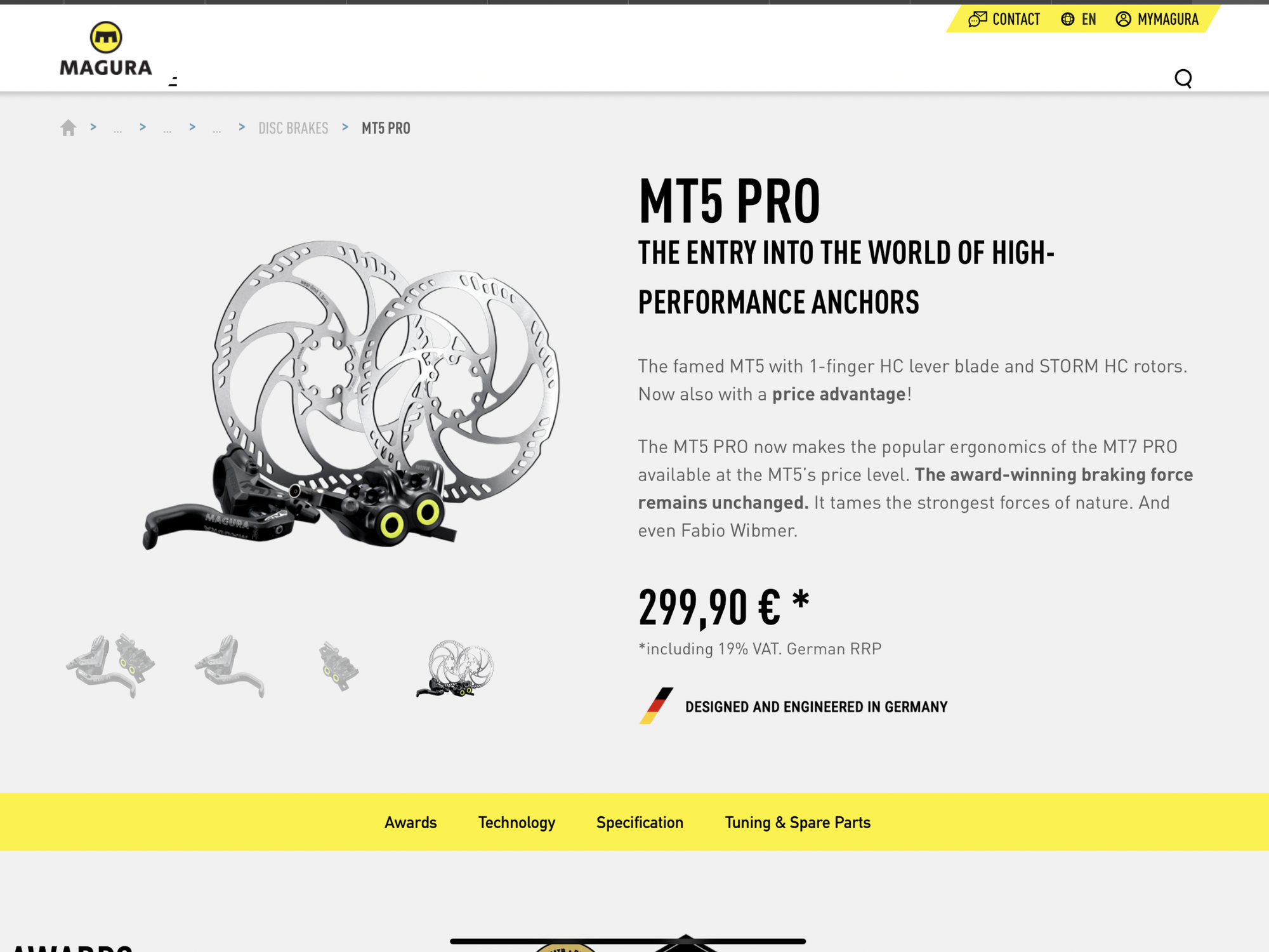

Need help with brakes.
Thinking of going with the MT5 pros.

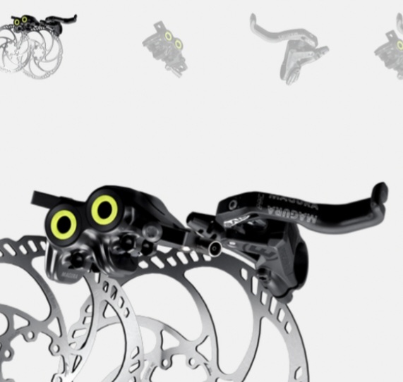

The weak levers were my main concern with the MT5’s but these have a different lever. Not as good as the Hope lever but better than the 2 finger MT5.
£210 for the MT5 Pro with storm rotors v £485 for the Hopes.

Seen a lot of people using MT5’s with the SLX levers.
Interesting combination but give both use mineral oil shouldn't be issue. Easier just to stay with SLX.
MT5 levers don't have left or a right so brakes can be swapped easily eg front on left or right. Great for rentals.

SLX M7120 are £335 plus rotors.
Magura MT5 pro with rotors are £210.
