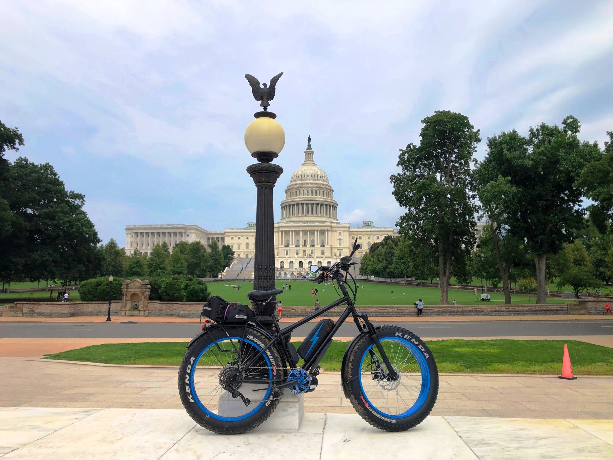

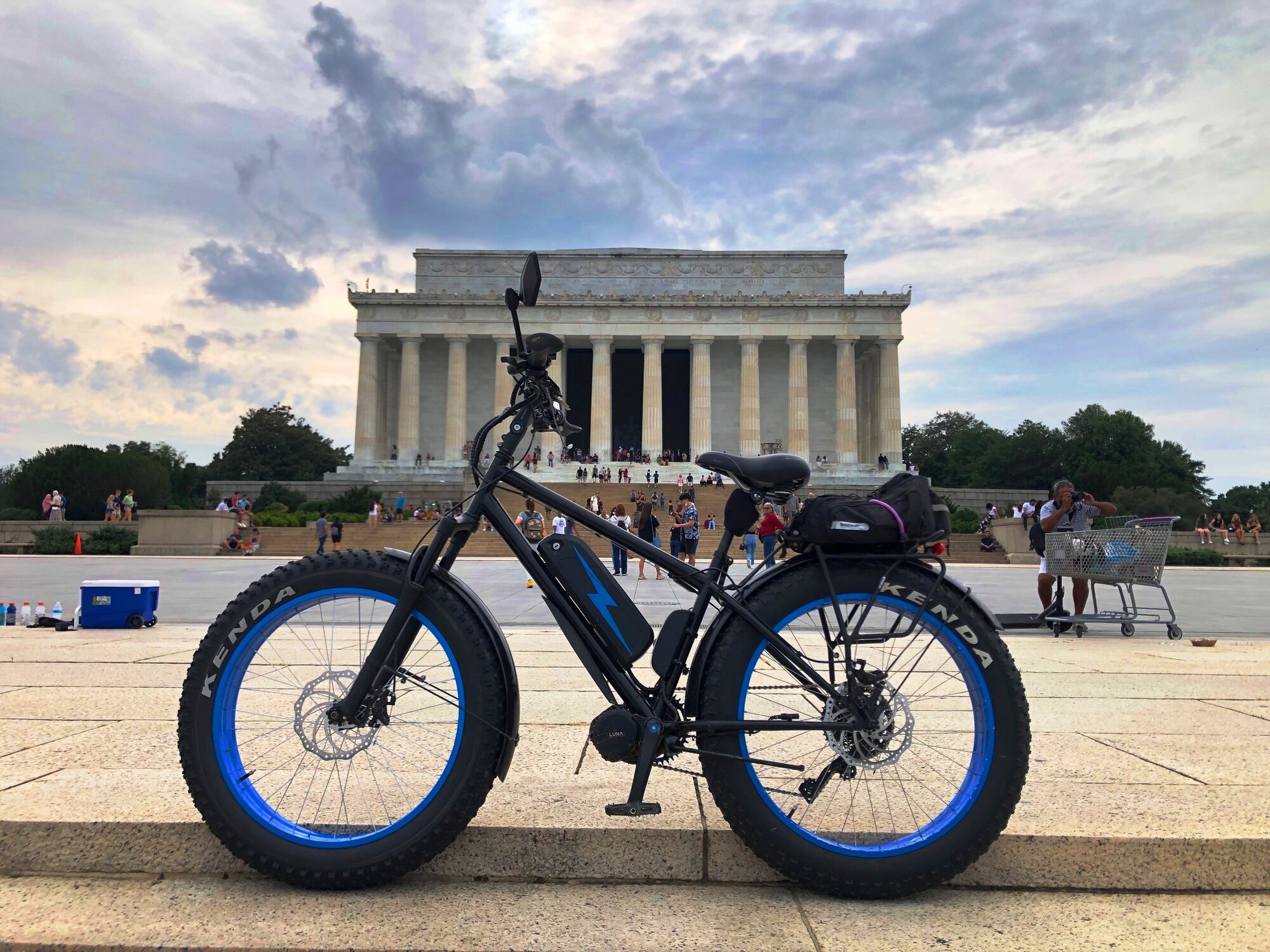

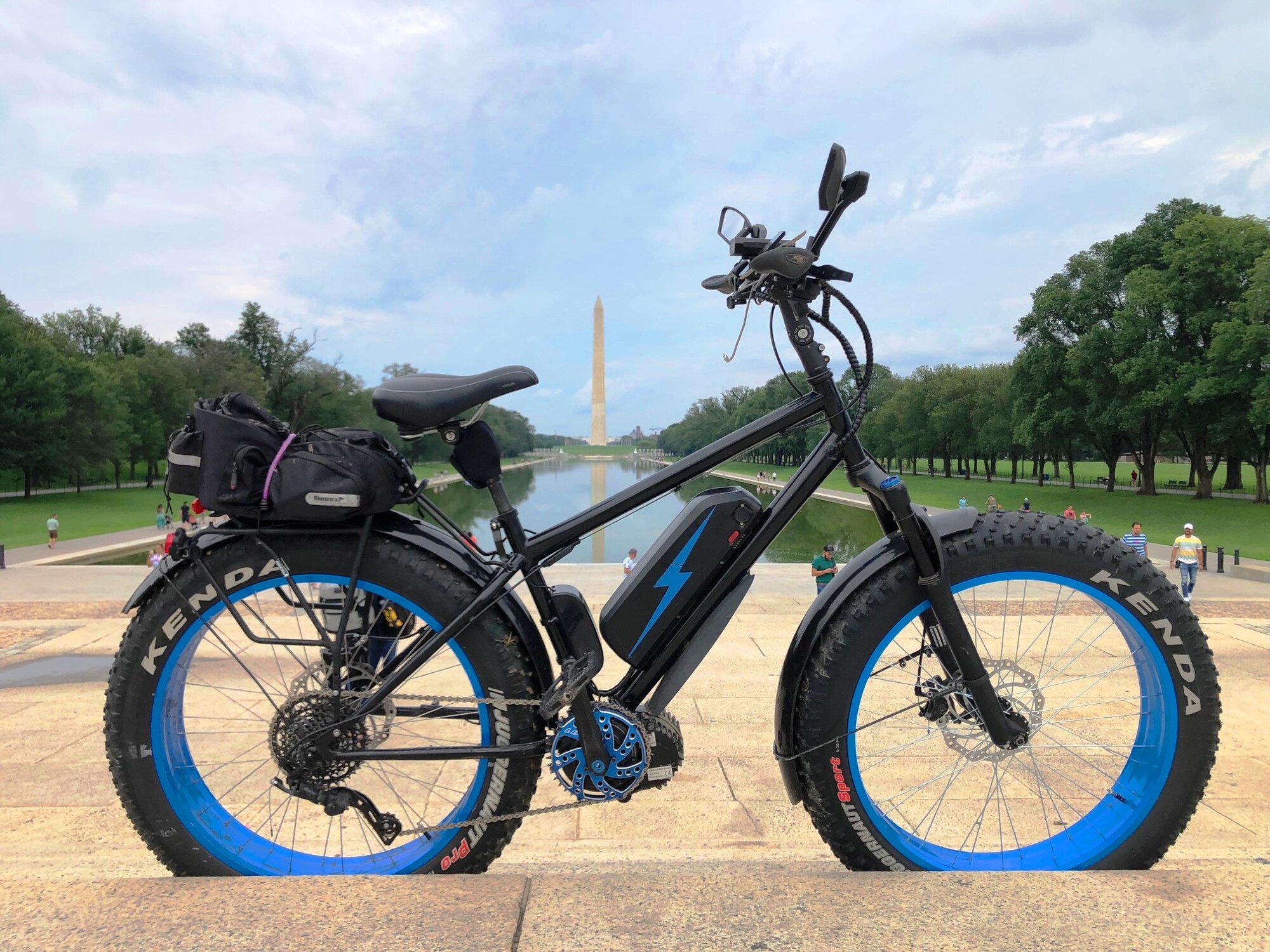

I have a steel framed fat bike, 4.5" tires, Luna BBSHD, with a Hailong battery on the exterior of the downtube (see pics further down the thread). I want to replace the frame with a full suspension frame. Been searching with some difficulty. Most manufacturers are lacking dimensional specs and the support by email is rather unhelpful.

Sorry about the scant info. See the pics I posted in the thread. I currently have a BBSHD, steel framed fat bike with 4.5" tires, but going back to 4" tires on my next iteration. I want to transfer my components from the steel frame hard tail to a full suspension.
