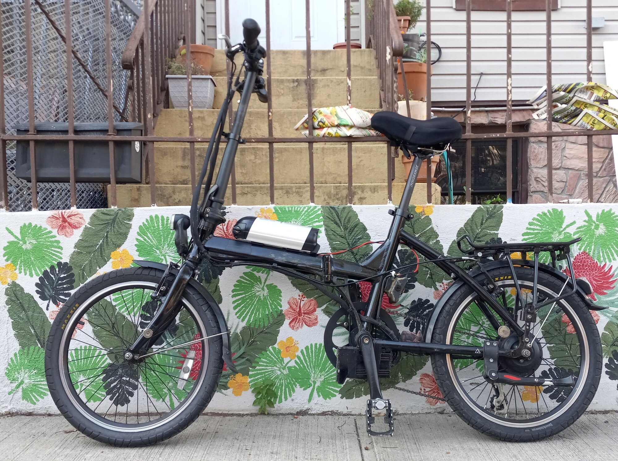

...aaand - it's back on the road!
So in the end I decided not to go with the above link, as I found out I would have to replace the battery housing on the bike as well, a dubious proposition from unchecked source (but who knows, maybe it could have worked).
Instead, I went with one @Jenny Mao , who is a trusted presence on this forum, as I quickly found out after some browsing. Ordered a small bottle type battery from her via alibaba, for a very fair price, name is "Dongche G20 36V 7AH(rated 6.8Ah)". Highly recommend Jenny, she was very patient with all my questions, we exchanged many emails before settling on the type and price.
Took a while to arrive to New York, about a month. Was well packed, and battery itself looks solid.
Install was fairly easy - attached the holder to frame with two self-tapping screws, then soldered two wires to corresponding wires on the bike (red and black). Ignored other 3 thinner wires. Was totally paranoid that it's not going to fully work, but seems to be all good so far. The battery is definetely zippier than the old original, although I haven't tested it for more than 10 mile distances yet so can't comment on discharge rate.
In summary - owners of A2B Kuo+ with dead battery - rejoice, your bike is not ready for a landfill!
Here's a pic, almost done, just need to secure the wires better and take out the original battery housing -
Augi528, so sorry, just seeing your comment. If it's not too late - yes, you can easily remove battery from the frame, it has a locking mechanism with a key. Miles - got about 10 miles out of it yesterday on almost full charge with assist level 3-4 and moderate pedaling effort. It was cool weather, 40F or so, and route was moderately hilly (in case you know - Washington bridge to west side highway to mid Manhattan - so two sizable climbs). It can do closer to 15 miles in warmer weather with moderate climbs. Two batteries is an interesting idea, as 10-15 miles range is a bit short. I don't mind getting some exercise, but the bike is heavy and pedaling without power is hard.
