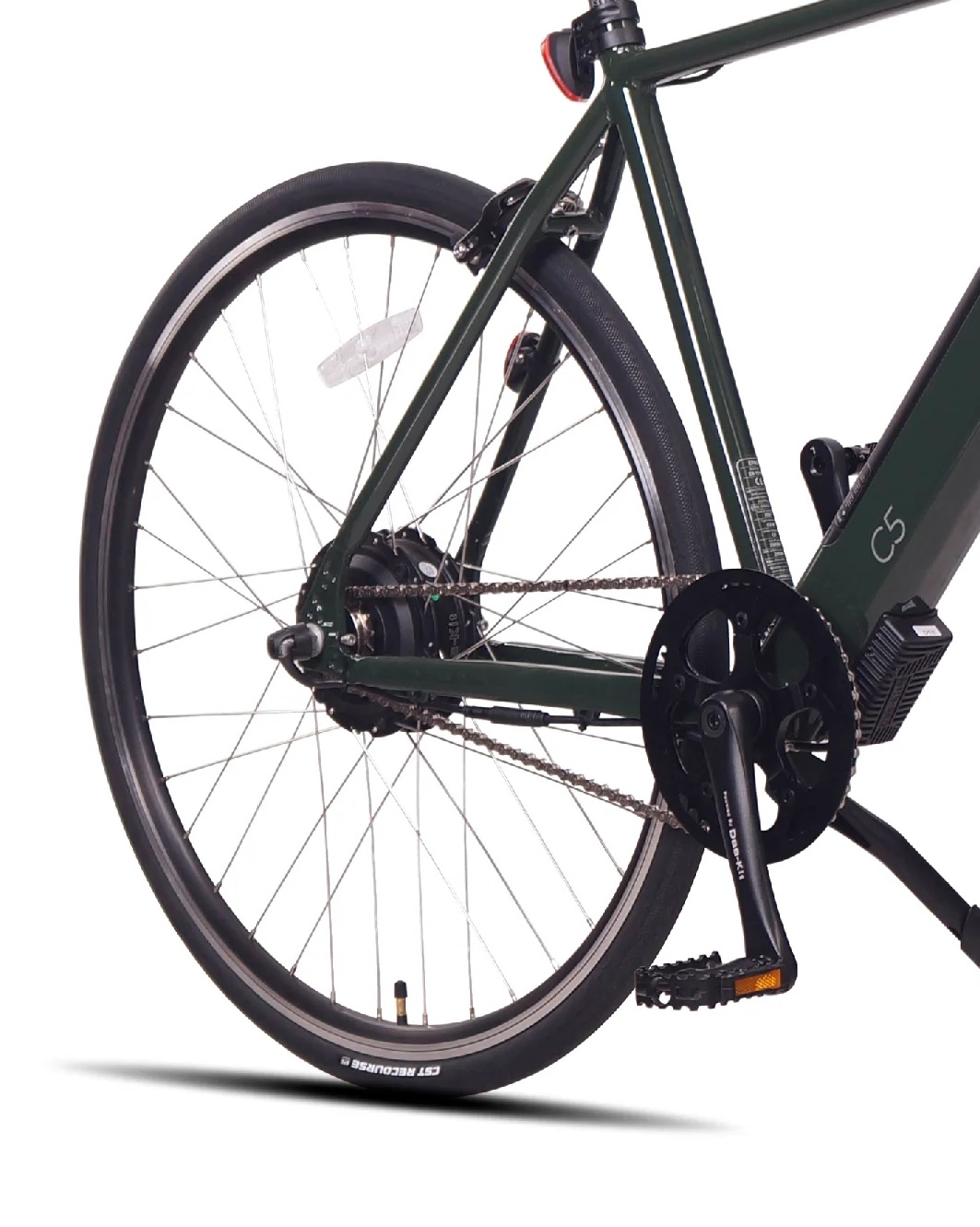

Hub Motor Rated / Peak Power: Das-Kit, X2, 36V 350W / 600W

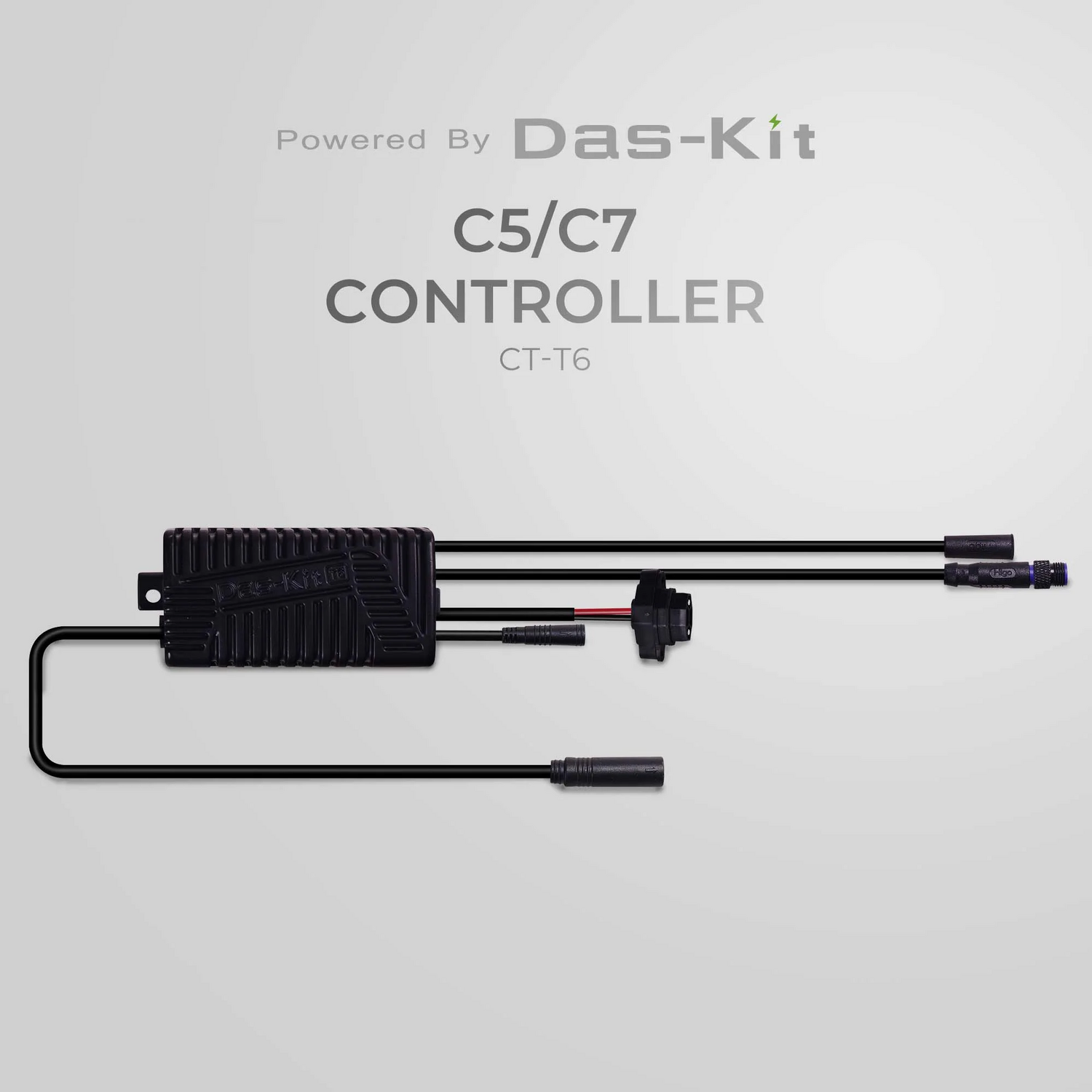

Specifically, the controller is Das-Kit Controller T6 and here is a weblink for it- NCM C5/C7 Controller - CT-T6 , with the following description and photo--
Description: 36V15A, 6 mos, Motor Wire270MM, Light Cable590MM, Boost Wire50MM, Display Wire900MM, Power Cable100MM, not include terminal block, Black
Now the question is should I try getting a Das kit display from NCM (Like a C7 display) and try to find a connector cable to my existing controller to have throttle functionality? Also, I am aware that people have upgraded from L7 to C7 NCM display.. But I cannot find anyone who upgraded from the basic E2 display to C7- cant find any info if thats even possible.

I have put some useful photos if you wanna see
