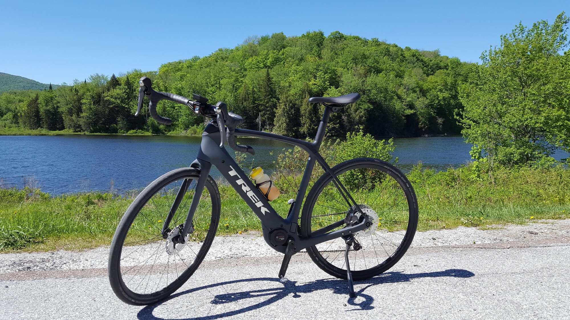

Still trying to get comfortable on the seat. Tempted to move an old Brooks saddle over to my Domane +HP. Right now I am riding it in Econ mode, then for steep , short hills go to Tour mode.
Does switching pedal assist off, on a descent help with conserving the battery, or are you only using battery power, when you pedal? On long descents, I often just tuck down for less wind resistance, and coast; not pedaling. I also had my LBS disable the headlight-on-at-all-times. Now I can select lighting on or off.
you only use battery when your putting out watts. if you spin the peddles going down hill but you're not actually putting effort into ir the motor is not on. I notice on my Kiox if I am jsut spinning going down hill it does not even show cadence I only get that if the motor is working.
