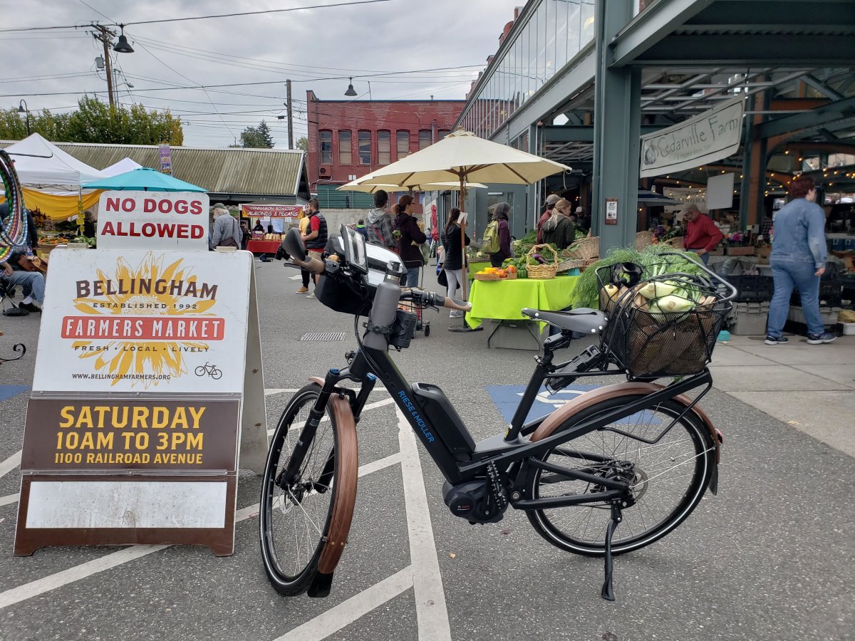

Here's the racktime basket loaded up on my Homage at our local farmers market. It literally snaps into place without having to use any bungees. It also has a built in aluminum handle with a neoprene grip. You can get a bungee net that goes over the top and keep everything in place (in use in this photo). Racktime also makes has a lock that keeps the basket or any other attached device secure.
Can it move off easily when need take someone instead of?
Pull up on the tab, slide it back less than an inch, pick it up and go. To attach, center it, push forward less than an inch till it clicks.

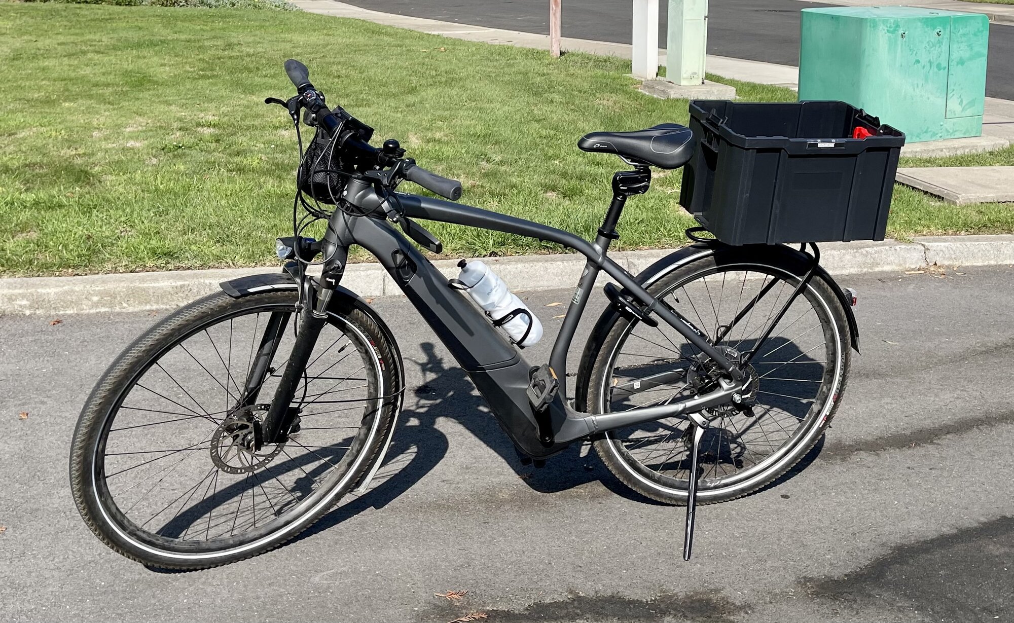

I have been using an oversized milk crate, zip tied to the rear rack on my commuter bike for about 2 months now, i ride 20 miles a day. I absolutely love the large milk crate over the standard milk crate. It weighs 4 lbs, a little heavy but it's super sturdy and i'm on an electric bike and lost 20 lbs, so the weight doesn't matter to me. What i added was a 52 can cooler bag that fits perfectly inside the milk crate, this allows me to take it to the grocery store and just lift out the cooler and walk into the grocery store, buy all my stuff and throw it back into the container. Lately i have been just leaving the cooler inside and using a shopping cart from the store, as i prefer to just sometimes leave things inside the cooler when i'm in the store (like my helmet). Other thing i like about it is that it allows me to just dump whatever i want inside, it has a small flap at the top also to remove a can quickly but i use that to just dump my gloves or anything else small. I am really thinking about trying to secure the cooler bag to the bike, i love the setup so much i feel like it's a car's trunk. I think that is the biggest thing missing from a bike when you replace it as a vehicle, the space to store things like groceries or clothes. I really wish there was something like my setup but with locking.

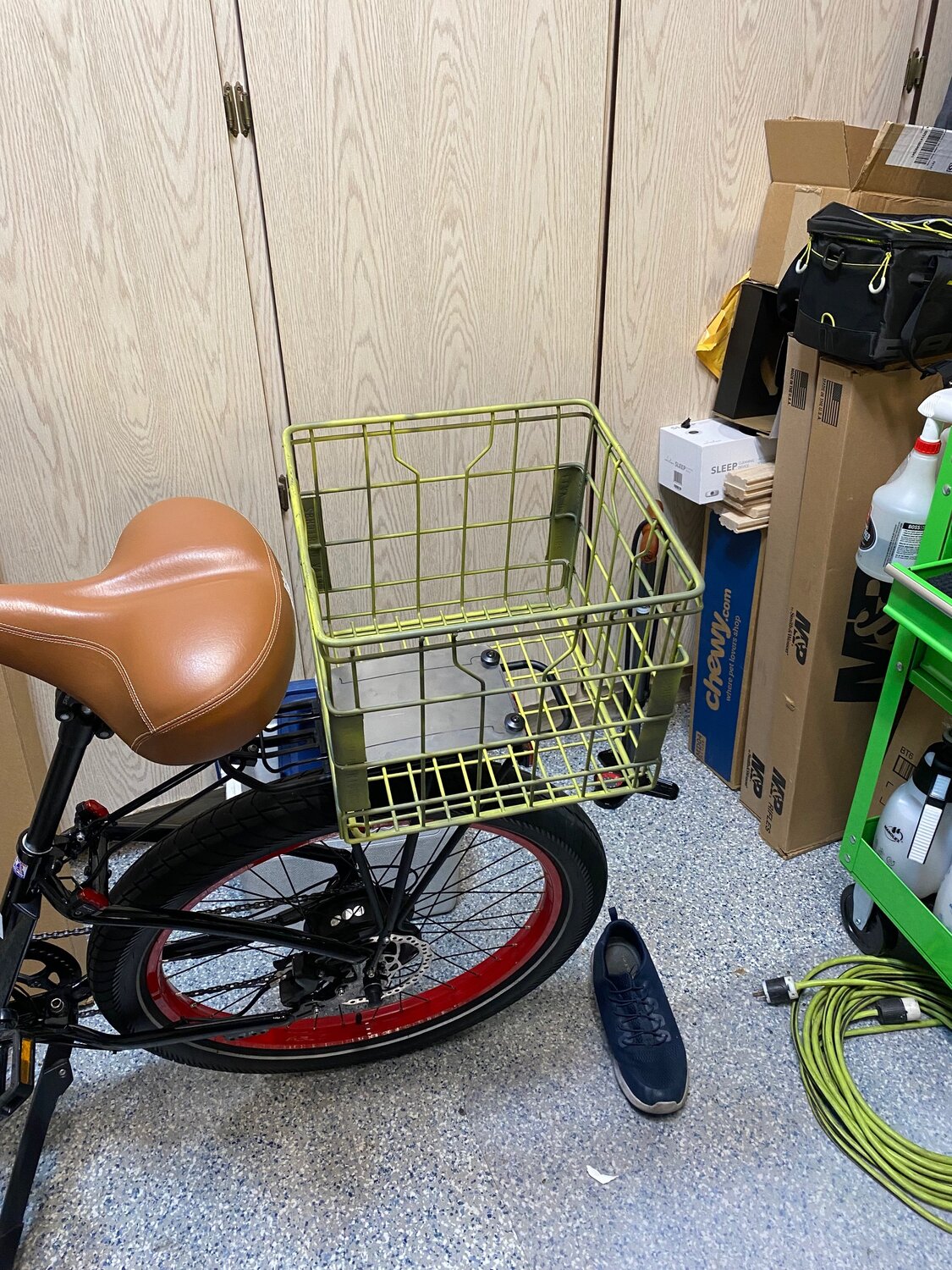

I bought this vintage milk crate and added the MIK adapter plate it locks on to the MIK rack and works great.. Have a cargo net I use with it if its a big load. Don't have the finished basket pic with it being painted. Need to get a small vanity plate to hang on it.
