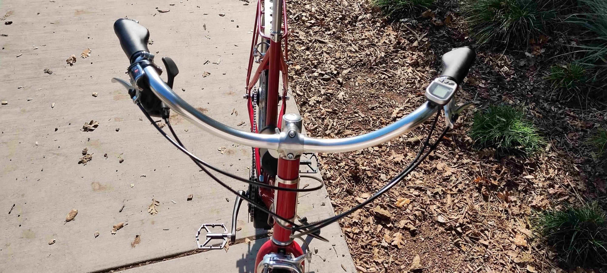

I wonder how much the handlebar is worth. It is a work of art. Yes, it is not aggressive looking and it is comfortable to ride.
Ya....I s'pose it looks neat. But in fact the handlebars on the Como are a real turn-off for me. It screams 'you can't modify me easily!'.

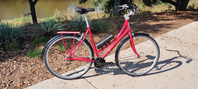

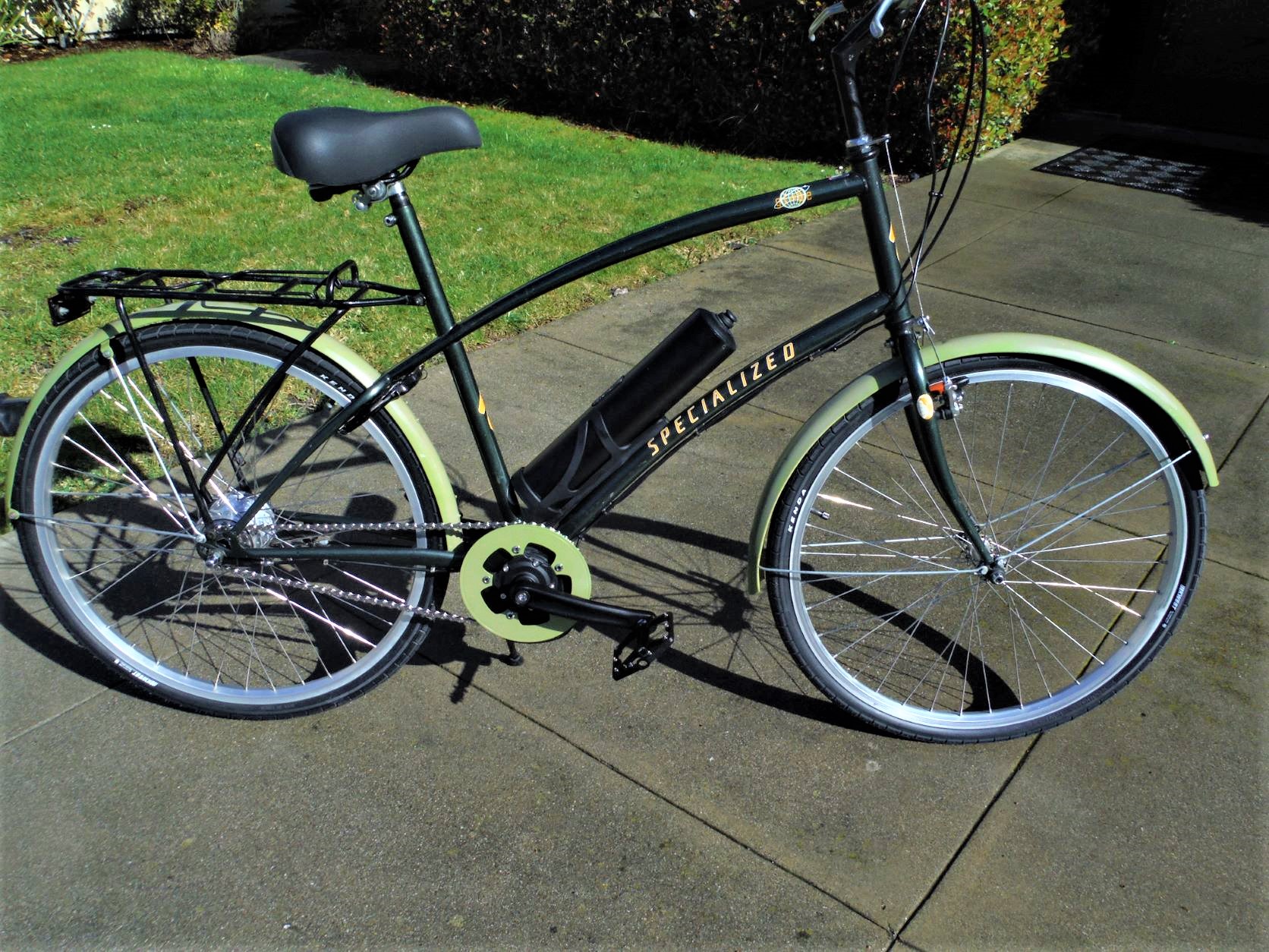

Especially at that price point when they were thinking the could only afford a third-tier bike. Here are a couple of my Specialized Globe bikes. I have made three. These are refurbished 15 year old bikes that I converted. The red one has a trigger to the Nexus. I mixed the paint on the green one for the chainring and fenders.
