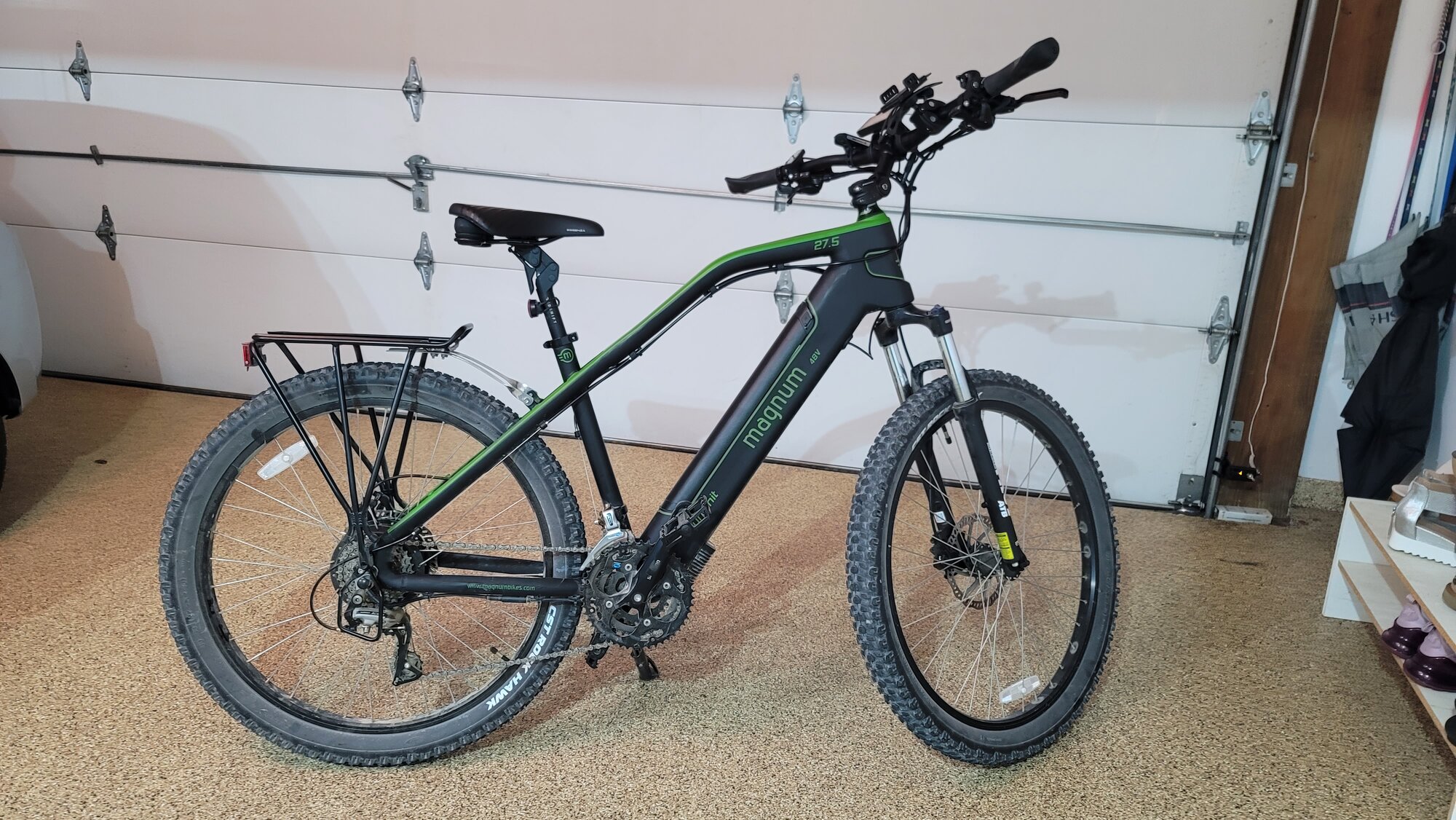

Hello all,
I wanted to share my experience with my Magnum Summit. I don't see a lot of Summit posts here, so I thought I would share my experience / opinion.
First of all, I've had this bike (2021 model) for approximately 500 miles. I have two electric bikes, this Summit, and an older BH EVO Street Pro. I will say this right out, I absolutely love the Summit. I test rode it, and bought it right there on the spot. It is more suited to trail riding, basic mountain bike riding than my BH, but it still does great in city, or urban area rides. One thing I found to be unique on it compared to others I've tried is the 24 speed derailleur. Mine came with a Shimano Acera set. I think 24 speed is probably overkill, but I do like it as opposed to the 9 - 12 speed systems I've tried. I love the ability to go to a "granny" low when going up hills. Most of the time I leave the front sprocket in the middle one and have no problems. I have experienced good range with this bike. I usually can go 40 - 45 miles, and still have anywhere from 20% to 40% battery left. The PAS has 6 levels. I usually ride with it set on either level 2 or 3, sometimes up to 4 or 5 to get back in a hurry at the end of a ride. On PAS level 6, full on, pedaling my butt off, I can get to 29-30 MPH on flat, level ground.
Magnum bikes have been great answering questions and emails. Anytime I've asked them something I usually get a reply that day. I've inquired to them about aftermarket parts, etc, not about any problems I've had, because so far, knock on wood, I've had no issues whatsoever with this bike.
I'm a taller guy, and my bike is the 27.5" version, (I might should have looked at the 29" model), but I don't find it to be uncomfortable. After some adjustments, I find I can ride several hours and not have any issues.
OK, here are some of my modifications to the STOCK Magnum Summit....

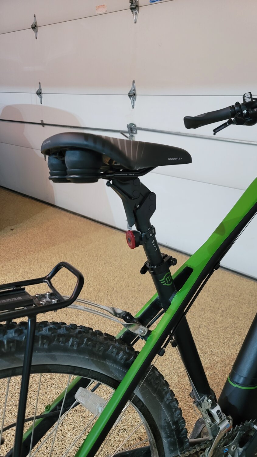

1. HIGHLY RECOMMENDED - Redshift Shock Stopper seat post. This thing is AWESOME. It takes a little bit of trial and error to "dial it in", but once you do, you will wonder why you didn't do this a long time ago. Now I'm wanting to get the front stem stock shopper! (If I do, I'll let you know and give a review)
2. Larger seat - I bought Selle Royal seat from some local shop because the OEM seat hurt my butt.
3. Topeak MTX rack. I would have purchased the Magnum rack that matches up to the frame bosses, but they were out of stock at that time. They now have them, however, I'm glad I ended up with the Topeak model. The bag that I got matches it and it has a rail system where you just slide it in and it locks into place, very convenient.
4. Topeak Trunk Bag - As mentioned above the sliding/locking system is great. The bag also has paniers that fold out if needed for additional storage.
5. Topeak Redlight Aura rear light - This light fits on the back of the rack and provides great visibility to keep from getting run over.
I'm currently looking for some type of headlight that works decently. I don't want to spend $500 on a headlight. The magnum has a headlight connector that's down in the frame to connect a light to the OEM wiring harness, but I've not been able to find anything that has decent reviews. Right now, I'm using a cheapo Walmart light that mounts on the handlebars. If anyone knows of any good solutions, I'd love to hear from you.
Overall, after 500 + miles, I'm still in love with the Magnum Summit. I'd love to hear from any other owners of this bike out there, and if there are any questions I can answer please feel free to hit me up!

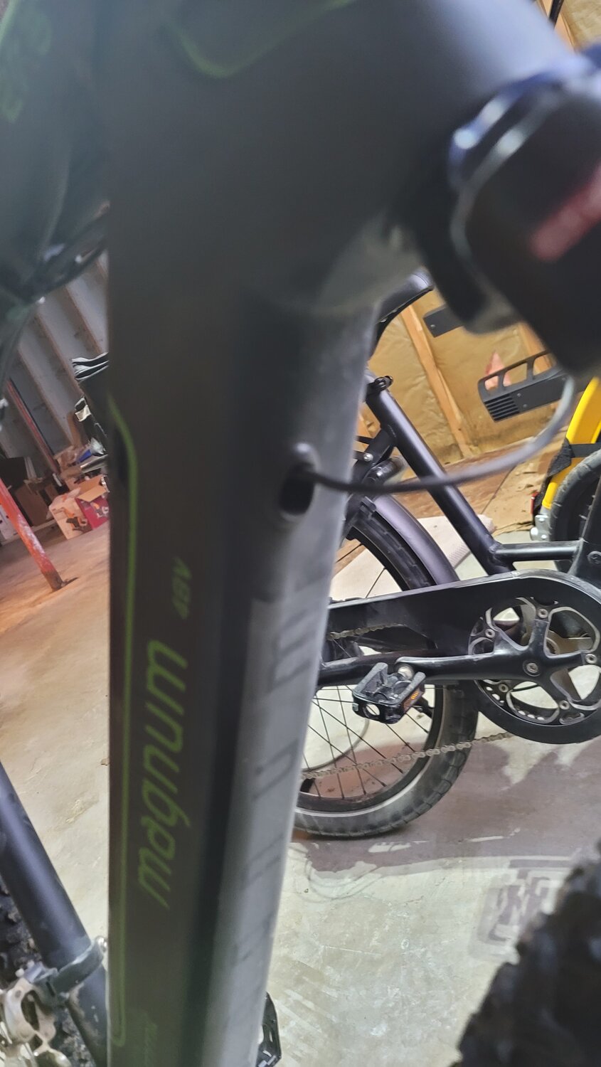

where do I find the headlight connector that's down in the frame to connect a light to the OEM wiring. Any pics you can post to show me where the factory wiring is for the headlight, would help.
It is on the top of the downtube that holds the battery, front side facing the tire. There is a grommet with one wire coming out of it. Remove that grommet and there is another wire with a plug that is stuffed down inside there. I'm attaching a photo, hopefully that will assist you. Hey, let me know if you find a decent light that works with it. I have another post title Magnum Summit Homemade Headlight that I showed my cheap work around that has actually worked really well the past few months. Good luck!

ok, I will look for the wire. Is the power for this wire activated when the display backlight is lit? Or is it hot all the time
whereas the headlight needs it's own switch?
According to an email I received from Magnum, the light they use for OEM is a model manufactured by Kendo. They stated that it would work / integrate with the C7 display. I cannot confirm that as I never ordered one. I read reviews on them and was not impressed, they are not very powerful, so I didn't even try one. I came up with the work around as mentioned earlier, that works great for me. Let me know if you do try to go the Kendo route, I'd love to hear how it works out for you!

I found the hidden wire. I am going to see if it is hot with power all the time or if it works off the backlight function of the display,
and also what voltage it has on it (12 volts or 5 volts) I think I am going to mount a USB port charger on my handlebars and
attach it to this wire. I will get more use out of a usb charger for my phone than a headlight. Thanks for your help. I would of never known
that wire was there.

I checked it. It is whatever the battery voltage is at the time. It is "hot" with battery voltage as soon as the battery button is pressed on the battery.
The Display on or off power button does not matter. So I am going to have to find a usb adapter that works on a range of voltage from like 12 to 50 volts.
Or make a regulator to drop the voltage down to a constant 12 volts before I feed it into the usb charger. What I want to do is possible, just going to be more work
now that I know the hidden headlight wire is not a constant 12 volts like I thought it might be. Again, the hidden wire is direct battery feed and is hot anytime the battery
button is turned on. Good luck.
