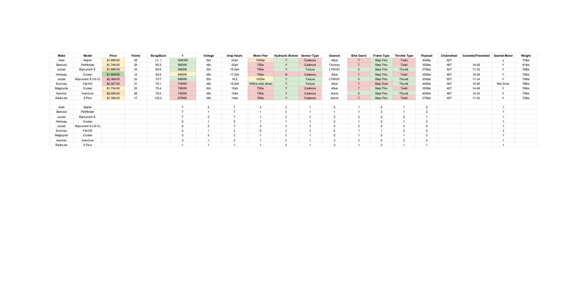

I am looking to buy 2 x Electric Fat Bikes on a tight budget. I have made a spreadsheet that I would invite comment or criticism on and also hope it may help others making a decision.
Some comments about how I set it up.
I used current (4/28) pricing and discounts - taking into account any available discounts for a multiple bike purchase and any discount codes I could find.
I picked a bunch of data points that were important to me and then gave out points accordingly. You will see some of the points I weighted more - like power, battery size and others. My wife and I are heavier riders so some lesser powered or lower weight rated offerings may have been skipped over.
I then added up the points and divided by the price to try and work out a "Bang for your Buck" index. The lower the number the better the "bang".
My issue with all of this is that I was having trouble finding any concrete information on build quality, customer support and the FEEL of riding these.
It also really had me scratching my head as to why two of the (seemingly) most popular models came out last on my Bang for Buck index (Aventure & Rad Rover6).
I would welcome any comments, advice and hope that maybe others could use this to at least have a lot of specs and info in front of them when trying to sift through all of this.
PS The Magicycle Cruiser I priced including the hydraulic disc brake upgrade even though it does not come standard with them. Also one bike did not come standard with a rear rack but I built that into the price as well just to have one less complication.
Spreadsheet Link:
I would love opinions, advice, debates etc. Again we are heavier riders and we cant afford anything much more than I have listed there.
Also if this helps anyone else please feel free to use.

I have only quickly looked at your spreadsheet.
The Eunarou IS NOT Torque Sensing. That is a BBSHD which is only cadence sensing despite their deceptive verbiage. "160Nm of torque and cadence-sensing assist"
I would double check your specs on all the bikes, and double check again.
Discount the watt "ratings" of the motors. See here: https://ebikes.ca/learn/power-ratings.html

i totally disagree - fat bikes definitely have their place
No one says fat bikes don't have a place. Re-read the comments. They have advantages in limited situations, and big disadvantages in most other situations. Youtubers love them though because of their looks in certain situations.
I think the OP might get more useful guidance and comments if the OP described why an ebike and where, how, when they'll be ridden. As Indianajo and others hinted at, there's a big difference between what you might need if it's a city bike for recreational riding vs a touring bike for long tours in hilly country vs a mountain bike. Also, is the OP willing and able to to one's own service, or a person that doesn't know a wrench from a hammer? (just joking...)
Lots of options, lots of choices, and big compromises to be made if one wants to keep the price down to a few thousand each.
rich said you should not ride if 2.4 does not work for you in any situation
the op stated what he needs the bikes for in the third posts i think and imo fat bikes apply there

great worksheet
how tall are you guys?
espin might be one to look at also, i have been happy with my nesta after i changed the pas from 5 levels to 9
planning to get another nesta in the future or the bigger one with 26 inch tires

Thanks for your reply.
I'm 6'0" and wifey is 5'6" and because we are old and plan to carry stuff on the back step-thru is our preference.
Fat bikes suck as daily riders and commuters. The latest rash of 20" fat bikes are a fad. Most won't last. If you're riding in sand and snow I get it but the steering dynamics completely suck. I built one and hated it. The cheap seats are especially losers. The spreadsheet doesn't address the myriad of complaints. Eunorau and their ilk put the buyer in charge of support and warranty issues.
Thanks for your reply. The fact I couldn't account for complaints/build quality etc led me here. I agree that Eunorau doesn't seem to have a lot of market saturation here - its also not step thru. Noted on the seats - things like that I'm happy to buy and bolt on down the track if required. Thanks again.

If you don't plan to go more than 20 miles or so RT and don't have any long hills to climb, then a hub drive fat tire bike might work for you. Do be aware though that availability is still an issue. And as one other here has said, small wheels, like 20", fat tires and ruts or mud are a difficult combination, so keep an eye on trial periods, so you can buy, try, and then get some of your money back if it doesn't work out.
definitely go step thru and being 5'6" myself i would look at some of the 20-24 inch step thru
imo the espin nesta with 20 inch tires is too big for me, these bikes/frames are all made too big
this might be a reason to consider more of the bikes with frame sizes, aventon??? not sure which ones that will be
i do agree with other posters saying to try ride them first if you can
because of size, weight and all of the bikes will have different programming in the controllers
crappy programming can mean it takes off fast in level 1 pas and goes up to 11-12 mph, this is will most likely be too fast for the kind of riding you describe
i am not a facebook fan but if you can get it down to 3-4 choices and no bike shops have what you want to test ride good chance there is a facebook page and an owner of that brand will let you test ride their bike
i would do that if you can
