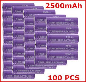

I'm building a cargo trike from a Schwinn Meridian. My enclosed cargo box will hold two battery packs, 18 volts each, flat against the left and right inside walls. I wanted the batteries to be as flat as possible, instead of the usual "boxy chunk" battery packs. So here's what I'm trying:
