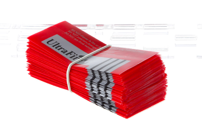

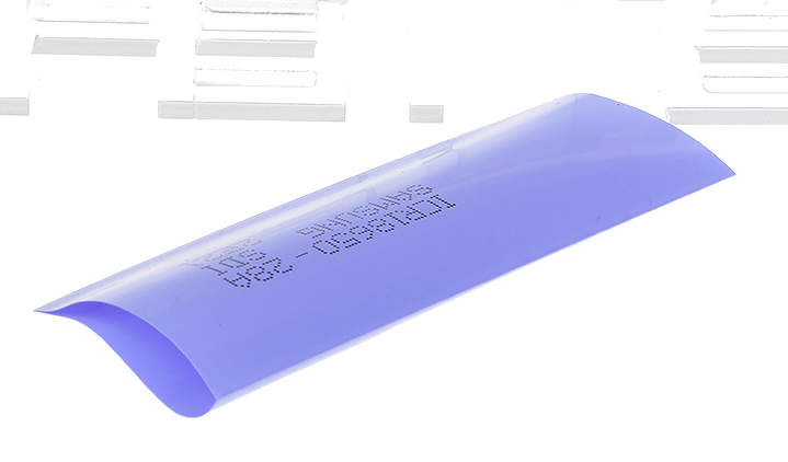

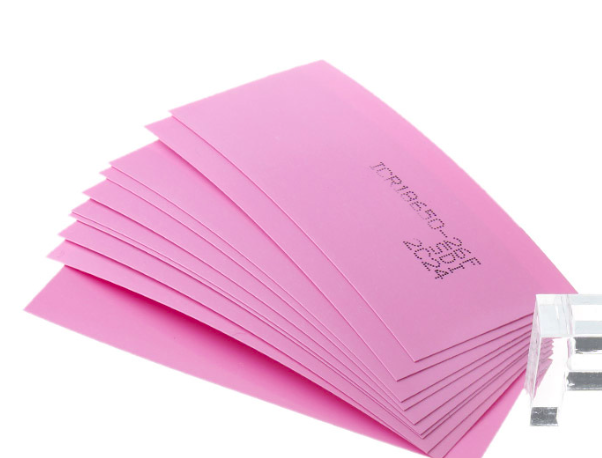

Sadly we could buy shrink wrap battery labels today and change any cell to a brand name. It happens. A lot.
I didn't dig in deeper but we can find brand name labels to rewrap.
